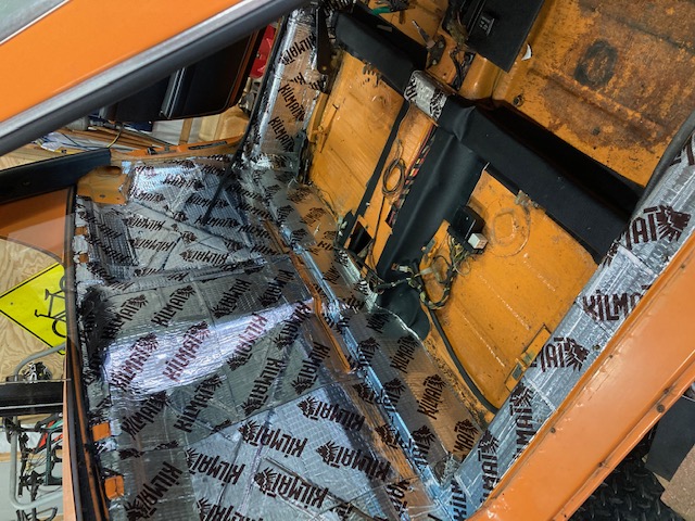

As you can see, I placed the sound/insultation material on the firewall and longs throughout the cabin. Essentially I put the barrier everywhere except over the tar mats. This included the footwell area as much as possible. Installation was easy using a roller. The car is still on my lift so I can't speak to the effectiveness of the material but I expect a significant improvement in noise level. I also replaced the outside firewall material in the engine bay. Since I am converting to dual carbs I wanted to make sure I keep the cabin semi-quiet...... Good luck!
