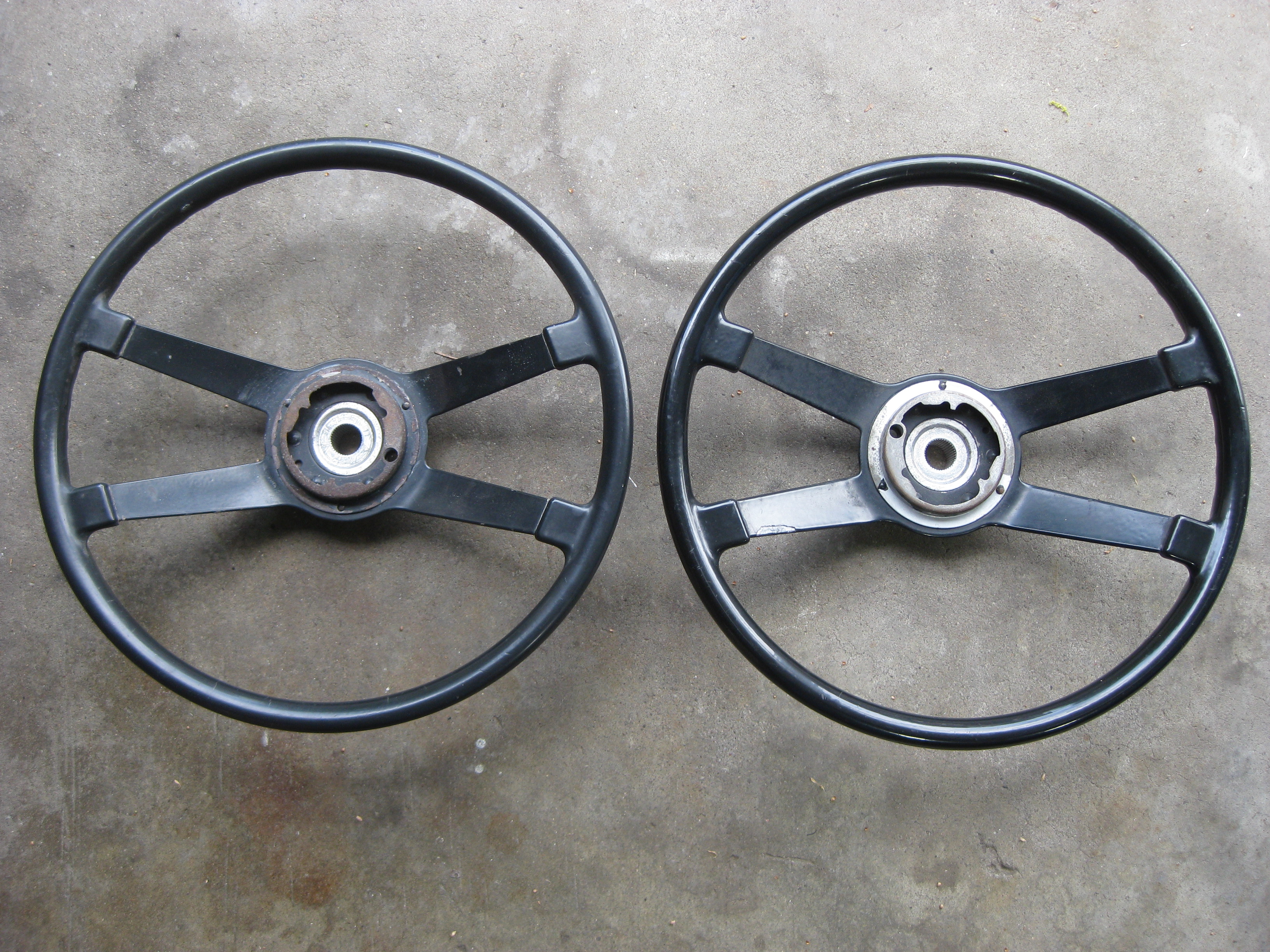

johnhora
post Apr 7 2021, 12:15 PM
Posts: 910
Joined: 7-January 03
From: Derby City KY
Member No.: 107
Marc,
I have a couple of stock 914 steering wheels.
Both are PN 914.347.804.11
Date codes are:
Left one....12/72
Right one...7/75
These are the standard stock "hard rubber/plastic" type.
You can as is or have them leather wrapped.
They are good driver condition and can be cleaned up and used or repainted.
I have more pictures....PM me if interested
