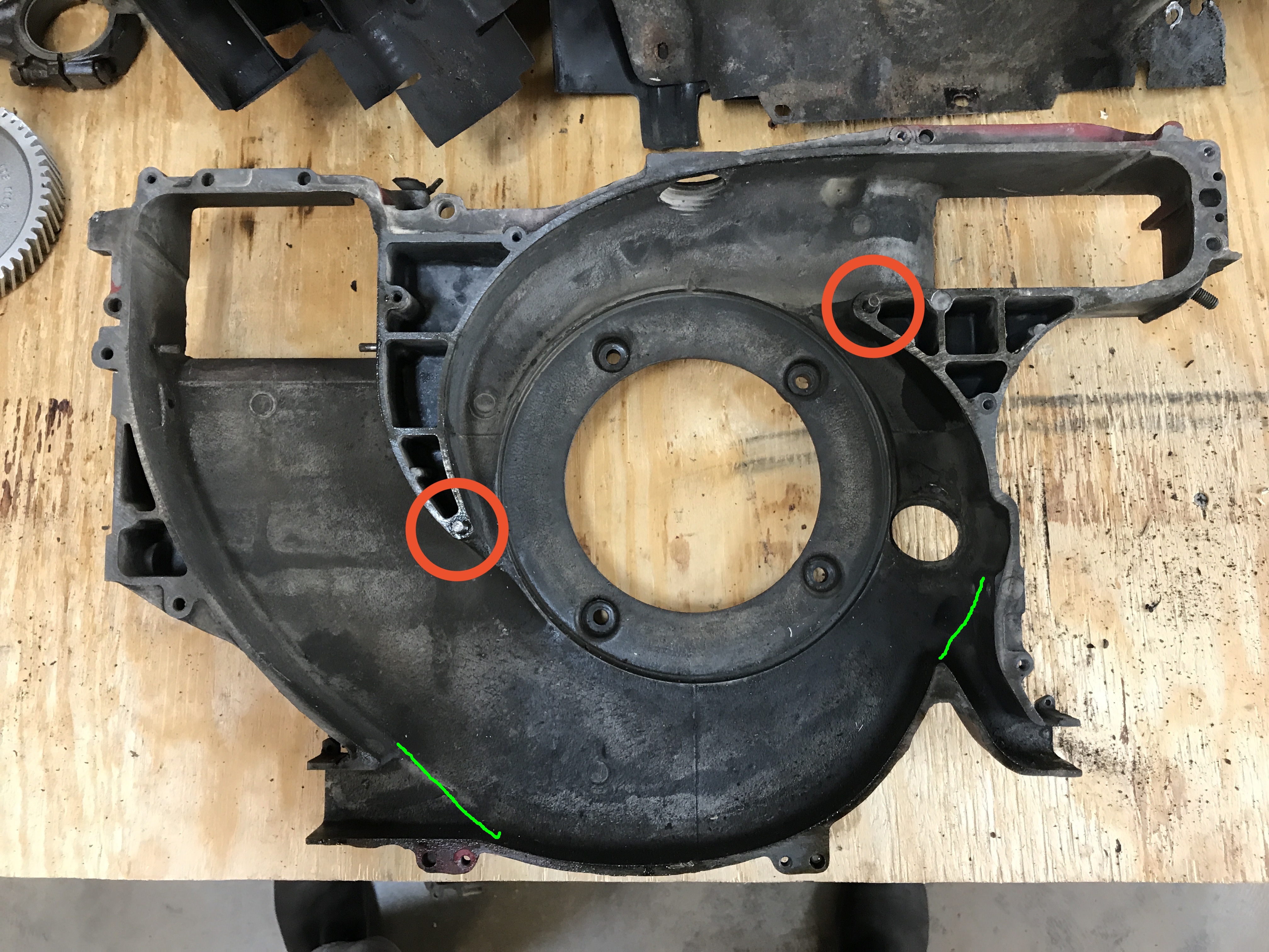

I have my impeller house apart for cleaning and it appears there were alignment pins for the front and back halves . How many are there? I have 2 pins around the impeller itself. There seems to be holes in the perimeter for pins too? Please review and advise so I can dig up some more as needed

I pulled another housing apart and it looks to have the original screw, and only 2 alignment pins...
So all good here

My fuzzy memory agrees with 2 pins.

AWESOME..>That matches what I have too
Thanks for sharing

I only found two. They are the key to splitting the housing. I used a punch.
