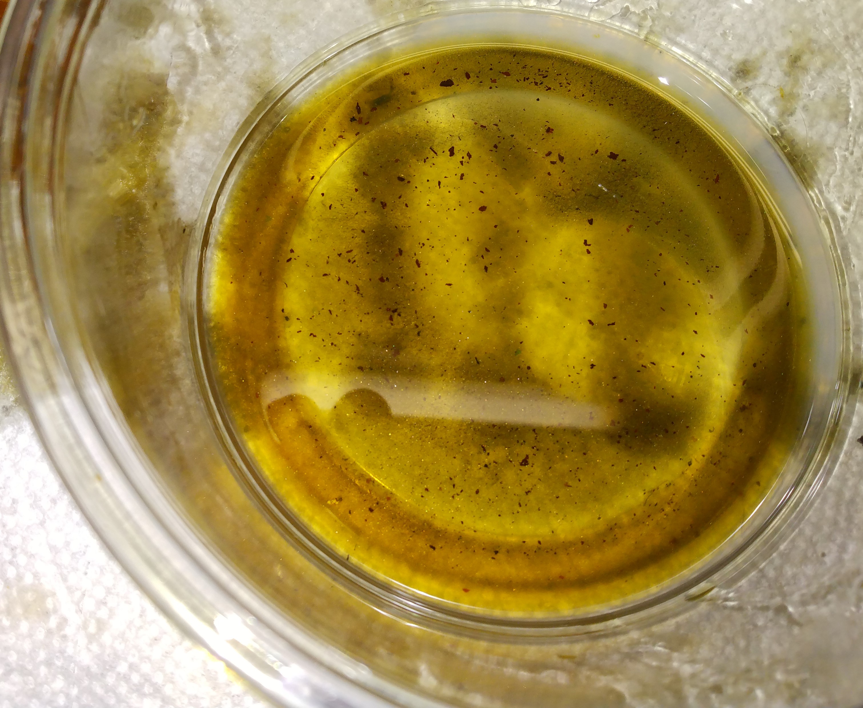

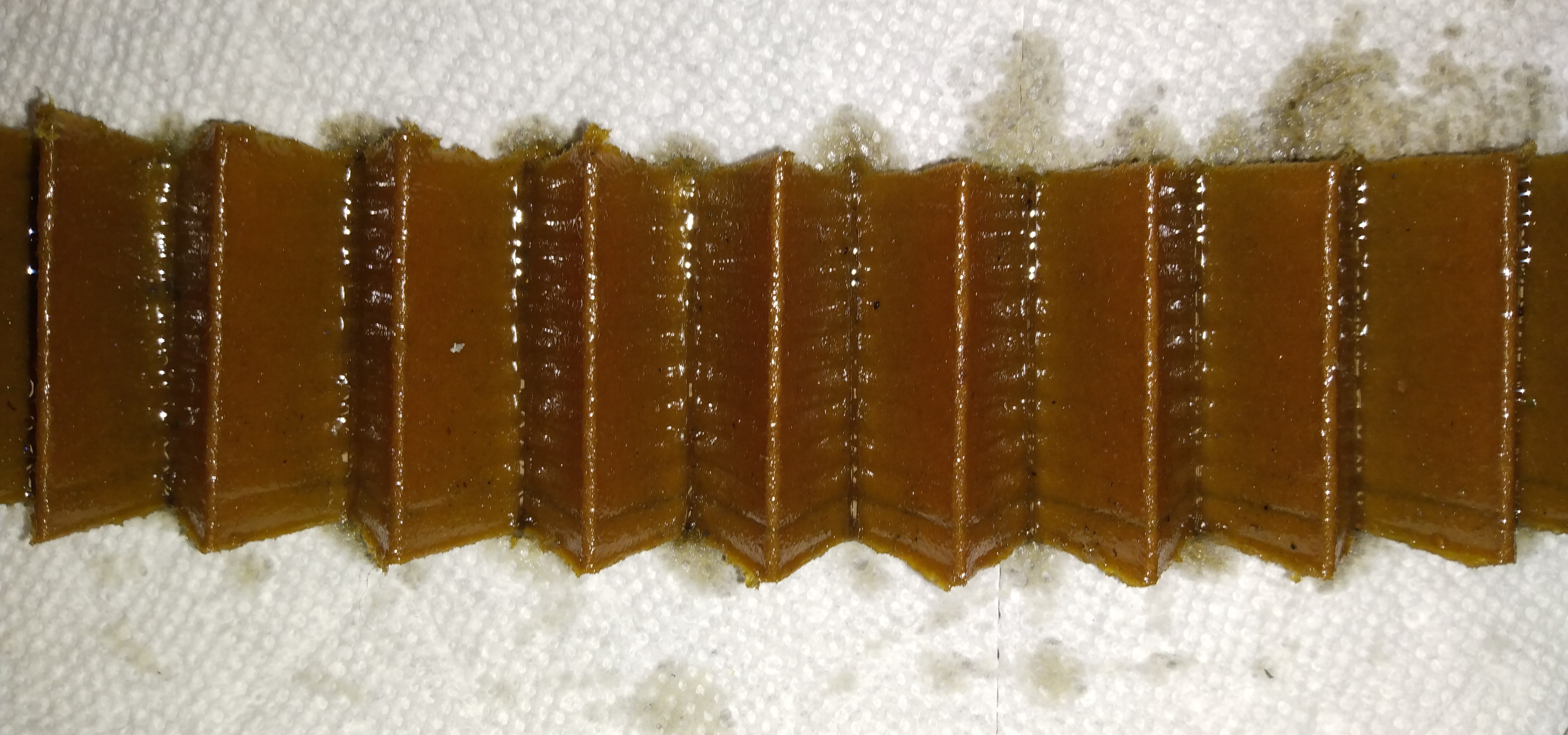

Drained the oil and cut open the oil filter . There were a few shards of metal stuck to the magnet after dragging it over the bottom of the plastic drain pan. No debris in the bottom of the oil filter and the paper element was clean. The black specs in the cup is from the bottom of the drain pan. and are non metallic Opinions? Attached ImageAttached Image Attached Image

You are going to have during break in, lots of metal parts wearing in to other metal parts and non-metal parts. With the metal being on a magnet, it is hard to tell if it is small pieces stacked or a few big pieces. I've always had a little metal after break in. That is why you use a break in oil and change it soon after break in.

Stop worrying.
You are doing CAM break in. As long as you used a good assembly lube and kept the RPMS up during break in you are fine. Often people with grind the sharp edges of the cam before install to minimize what you are seeing.
If your pushrod geo is off, you don't make as much power and the engine may not last as long, but you would have to really mess it up to kill the motor or the cam during break in.
Go seat the rings and see how it does.
