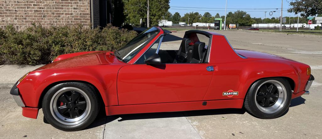

Thank you, gentlemen! And here's the gratuitous exterior pic, just because, well, we all like pictures (it's from this morning, so you can clearly see that the system is truly hidden
(IMG:style_emoticons/default/biggrin.gif) )

Great hearing new ideas on sound sys. I’ve been using my I phone too. And, Great Looking 914 ! (IMG:style_emoticons/default/smile.gif)
