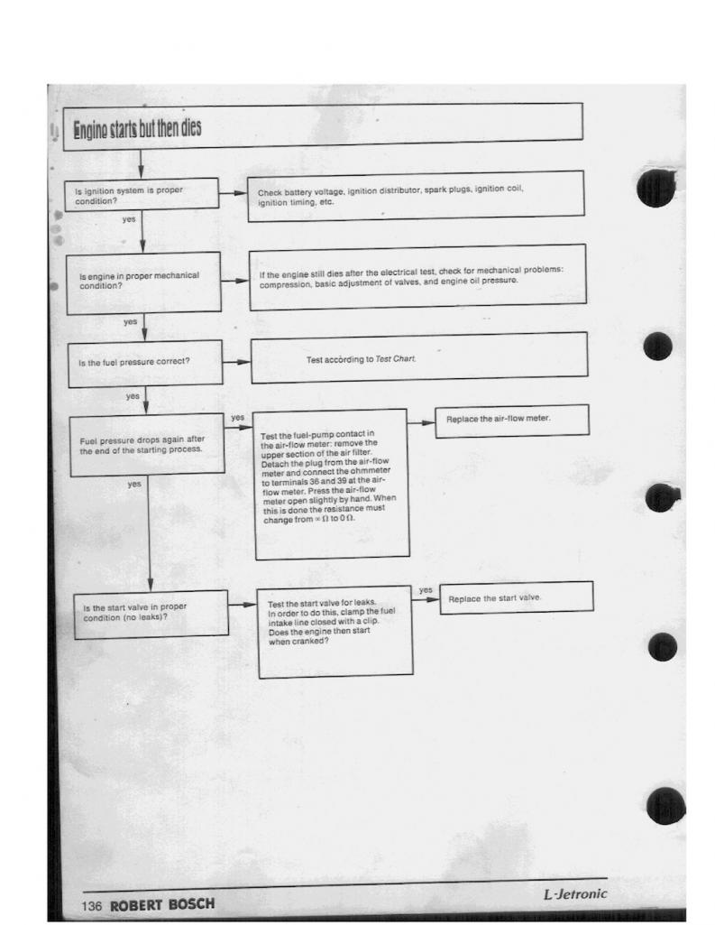

i have a VW L Jet troubleshooting manual i found years ago on the net.
not saying this is your problem.
but it might be worth checking - just to tick it off methodically.
cold start injector.
given you checked and replaced all the other injectors.
the test is really simple as step 1. you pinch the fuel line into the injector. you leave everything in situ and unplug nothing. you crank and if it starts and runs then it is the CSinjector. i had to think about that and i'm guessing a leaky cold start injector causes the engine to flood? might be worth a try just to tick it off.
