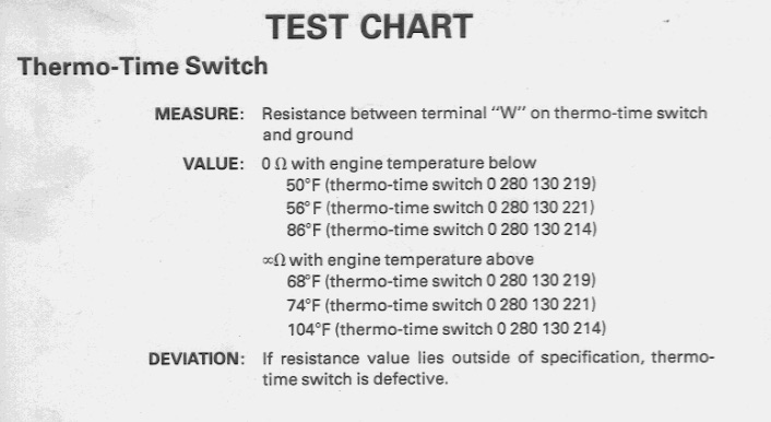

here is what i have Van.
From a L - Jet fuel injection manual for VWs generally.
see attached illustration.
3 different thermoswitches for the cold start valve are covered and listed with different bosch part #s.
would seem to imply fitting thermoswitches to suit different climate zones?
all three have different temp ranges but all having same spread of 18F between coldest and hottest.
but just to throw that off, I have another L jet guide that says the thermoswitch opens fully at 50F and closes above 104F. ?????? to me the 50 to 104 makes the most sense, as i would define an engine sitting at 104F as "cold" and needing a tiny squirt of start up fuel? or am i wrong.
anyway - all that means is thermoswitch opens cold start injector for full max timing at lowest temp, does not open it at all above the highest temp and in between its a diminishing amount of time the switch opens and the injector delivers.
in the 914 factory manual the test mentions the switch when tested below 50F should not open for more than 20 seconds. so 20 seconds is max amount of cold start injector delivery?
the truth is its really just got to work and more importantly switch the cold injector off.
to me its just a machine doing a synthetic couple of pumps on the gas pedal as you do for a carby car?
however -- thats not the fast idle warm up enrichment that takes over after the cold start injector does its job.
i know my cold start injector works, yours does too, but the enrichment cold idle phase is not quite right.
warm up enrichment is really controlled by 3 things as far as i can tell.
temp sensor 1 - in the intake air sensor of the Air Flow Meter. (intake air temp)
temp sensor 2 - the cylinder head temp sensor. (engine temp)
AAV - supplying the additional air for warm up.
and its kind of analogue like a clock, especially the AAV.
so one of those things is probably playing up and giving me the no fast idle warm up like you have on yours as well.
we tested all three of mine back 2 years ago and they all appeared to be working but i think this christmas i might re test and go over them maybe more closely.
i don't really worry about it at this stage as i know its running fine when its warm and i can put up with the little hitch starting the car cold every weekend and letting it get up to speed - and i never have to touch the gas pedal to start the car or keep it going during the warm up, so i figure its almost still all working after half a century and thats not too bad a situation for now.

That said, when it’s warm it hums a long real nice and the decel valve is working like a champ.
the CHT is further back on the right bank, hidden under the rear most intake manifold pipe.
the circular one in the engine tin nextto the distributor is the oil pressure switch.
it goes straight into the engine block just near where the oil cooler is.
i'm sure you have spotted the thermo switch connection to the cold start valve.
the thermoswitch is tucked under the plenum near the front right hand intake runner.
the CHT is a tricky thing to get out.
i'll try and find the page in the manual and post it up for you.
and i'm trying to remember where i got my factory manuals from as a download.
it was 10 years ago but i have a vague memory it might have been from the wonderful 914/6 GT website a guy folks in the USA must know. i think it was there. i could try and go have a look again. it was some kind of 914 resources site i found.

I was hoping you wouldn’t tell me that was the CHT sensor lol. I traced that wire while I was warming up the engine… manifold definitely has to come off.
My thermo switch was missing the wire clip for the Bosch connector. So I robbed the one off the CSV and used safety wire for the CSV since I can reach it. I would love to know where I could buy those wire clips. My AFM is missing it’s large clip too. The safety wire works better than Ziptyes but it’s not quite snug enough.

there is a technique for getting it out.
and the check values as well.
good luck (it is a bugger to get it out but it can be done),
it might have been in there for a long time - go easy with it.
you can test it without getting it out.
some other members here might want to offer some advice before you go hammer and tongs at it.
as far as i know there is not much you can do about temp sensor ! in the AFM unit.
its part of the unit.

Wonki, I will pay you money for that manual! Give me that manual lol!
Also, thanks by the way. I’ll chop up a socket and see if I can make that tool.
IMO all these basic sensor are eligible for the modern day remove/replace strategy. They’ve served their time and have earned a retirement. I’ll test it after I take it out and if it’s still good, it earns a place in the spares box!

here you are Van,
found it for you.
http://p914-6info.net/Manuals.htm
big downloads.
but you can pull it down section by section.
fabulous website.
thanks very much to the person who runs it.
you don't have to pay me, buy the bloke with the website a beer for me (IMG:style_emoticons/default/beerchug.gif)
i assume he lives in the USA somewhere. (IMG:style_emoticons/default/smilie_pokal.gif)
i'm looking forward to your discoveries re the warm up phase.
