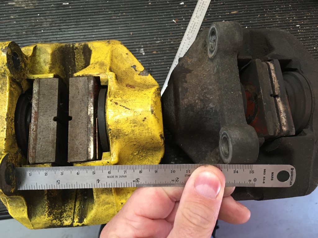

Hmmm....well, the offsets indicate that they're for early rotors. They are 3mm farther inward than the late calipers. When the buyer tried to install them on his 1974 car they were contacting the outer face of the brake rotor.
This means they are even more rare than I thought! Once in a lifetime opportunity for someone to have a set of NOS new-style, dual-bleeder, bolt-through calipers on their older car. (IMG:style_emoticons/default/drunk.gif) (IMG:style_emoticons/default/beer.gif) (IMG:style_emoticons/default/biggrin.gif)
I'm confident someone can use these new calipers. I need to make the situation right for the buyer, all proceeds go directly to him. Let me know what you need!
Sorry for the difference in scale; the buyer has the new red ones and I have the used yellow ones. The red is the ones I'm selling, the yellow are a set of known-1974 used calipers I have on hand (I'm shipping the unpainted ones to the buyer for his car). You'll note that the distance from the mounting face to the center of the rotor slot is 3mm, exactly the difference between early and late calipers. So I'm very confident these rotors will bolt up to an early car.

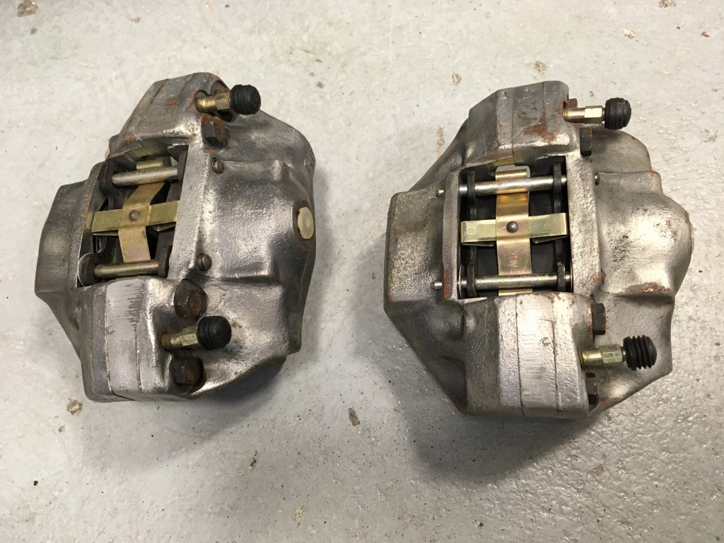

GregAmy
post Nov 25 2021, 10:14 AM
Posts: 2,728
Joined: 22-February 13
From: Middletown CT
Member No.: 15,565

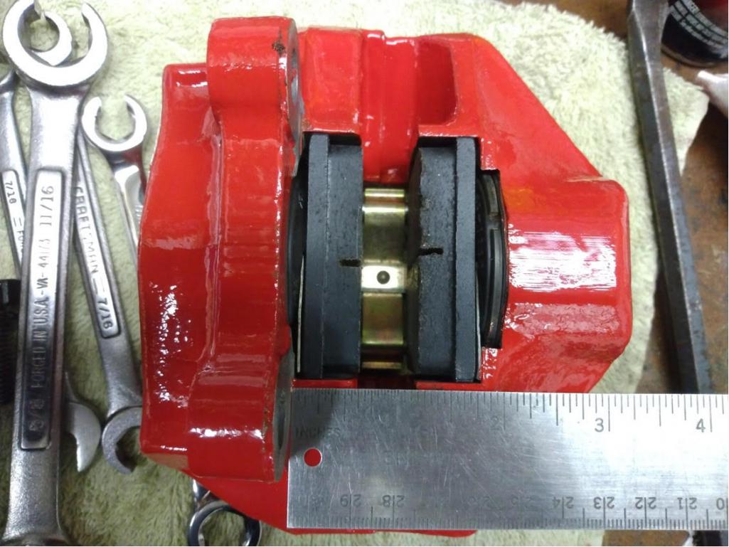

Nothing? Here's what they looked like before painting.
PatMc
post Nov 25 2021, 03:58 PM
Posts: 121
Joined: 27-June 21
From: Long Beach
Member No.: 25,669
QUOTE(GregAmy @ Nov 25 2021, 11:14 AM) *
In your picture with the yellow caliper I see an old late caliper next to it...lay the ruler on it just like you with the red caliper in the picture above...
I'm looking for the distance from the part that shows between 2 3/4" to 3 1/4" in the red caliper ruler picture
Wondering if this dimension is the same or not between the known late caliper and the mystery caliper

@PatMc , in the photos above, the red ones are the "NOS" ones. They are the same calipers as the ones two posts above, but the buyer painted them red when he received them, before test-fitting and finding that the slot is hitting the outer face of the rotor on his 1974. Looks like he replaced the pads, too.
The photo of the yellow and unpainted older ones, both are 914 "late" calipers. Exactly the same dimensions, I measured the yellow one but I've already shipped the unpainted older ones to the buyer so he has a set of known-late calipers.
So...where ya going with this? What are you thinking?

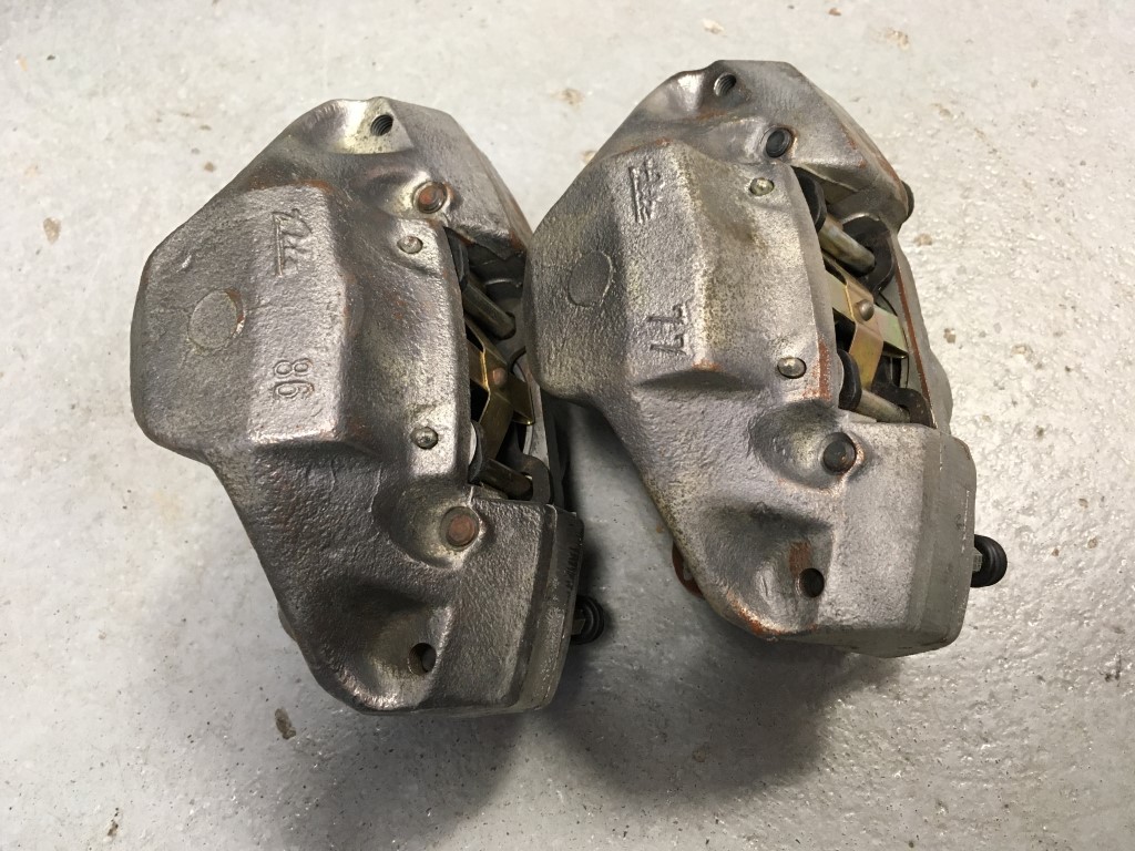

Early:
PatMc
post Nov 25 2021, 10:49 PM
Posts: 121
Joined: 27-June 21
From: Long Beach
Member No.: 25,669

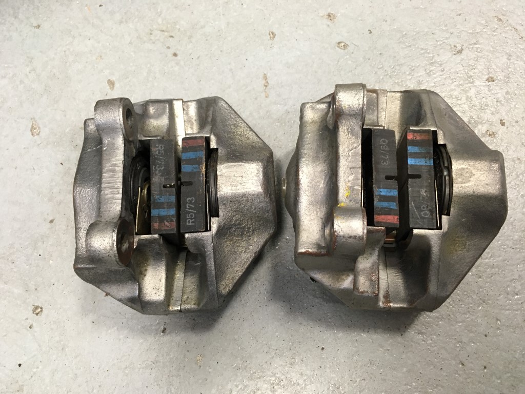

Late
PatMc
post Nov 25 2021, 10:56 PM
Posts: 121
Joined: 27-June 21
From: Long Beach
Member No.: 25,669
I'm seeing the dimension in your picture to be about 1.5", which would correspond to the dimension of what we know to be the earlier casting, so it would have the shorter piston in it. I guess it's the mid model unicorn set.... Double the price due to rarity.
Here's another set...car is a '73. I'm working on getting a VIN.

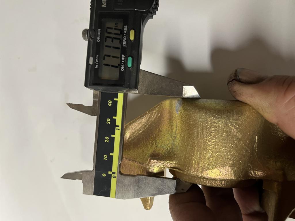

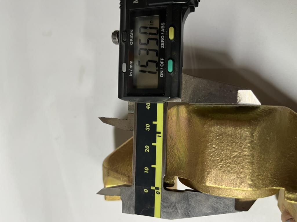

@Geezer914
John, when you get the replacement calipers (should be today?) take those measurements above on them.
So why the crossover? What's the story on it?
I don't need "double the price", I just need to make John whole. $250 shipped for the pair would cover that.
Geezer914
post Nov 26 2021, 08:35 AM
Geezer914
Posts: 2,394
Joined: 18-March 09
From: Salem, NJ
Member No.: 10,179
The red calipers measure 1.537 inches. The new ones that fit from your race car measure 1.714 inches So the red calipers fit 70-72 cars with early rotors.

A different version of the early caliper…I guess? I have one core like this, and customer in England with a set…and yours…are the only ones I’ve seen after handling hundreds.
