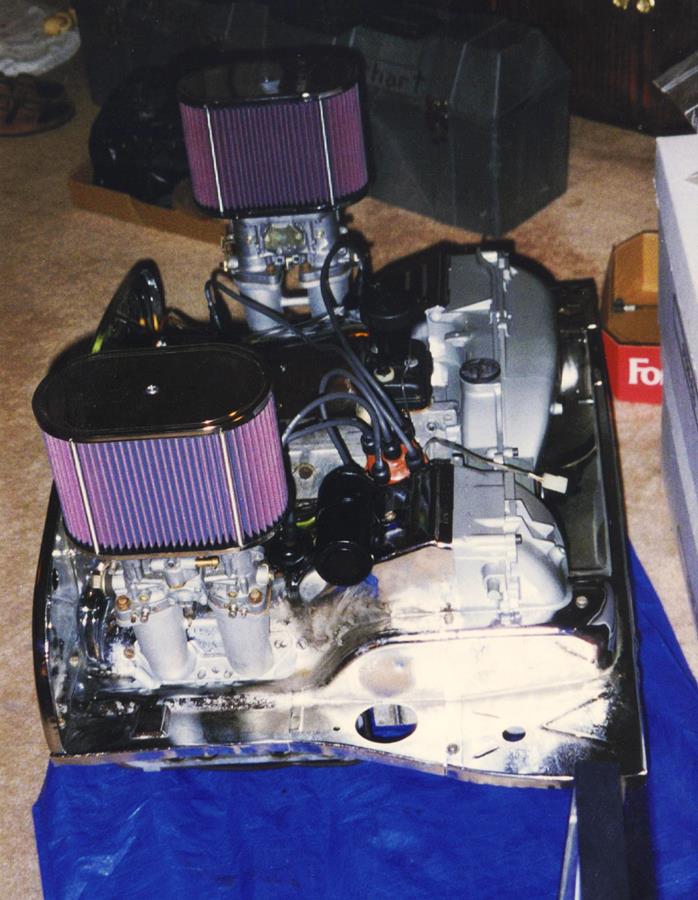

This was a 1.7. It was first a 1911cc, which is just pistons and cylinders. Then by putting a 2.0 crank, rods and pistons, a little head work and it is a 2.0 . The heads were the biggest difference. But these 1.7 heads work fine with a little work.
