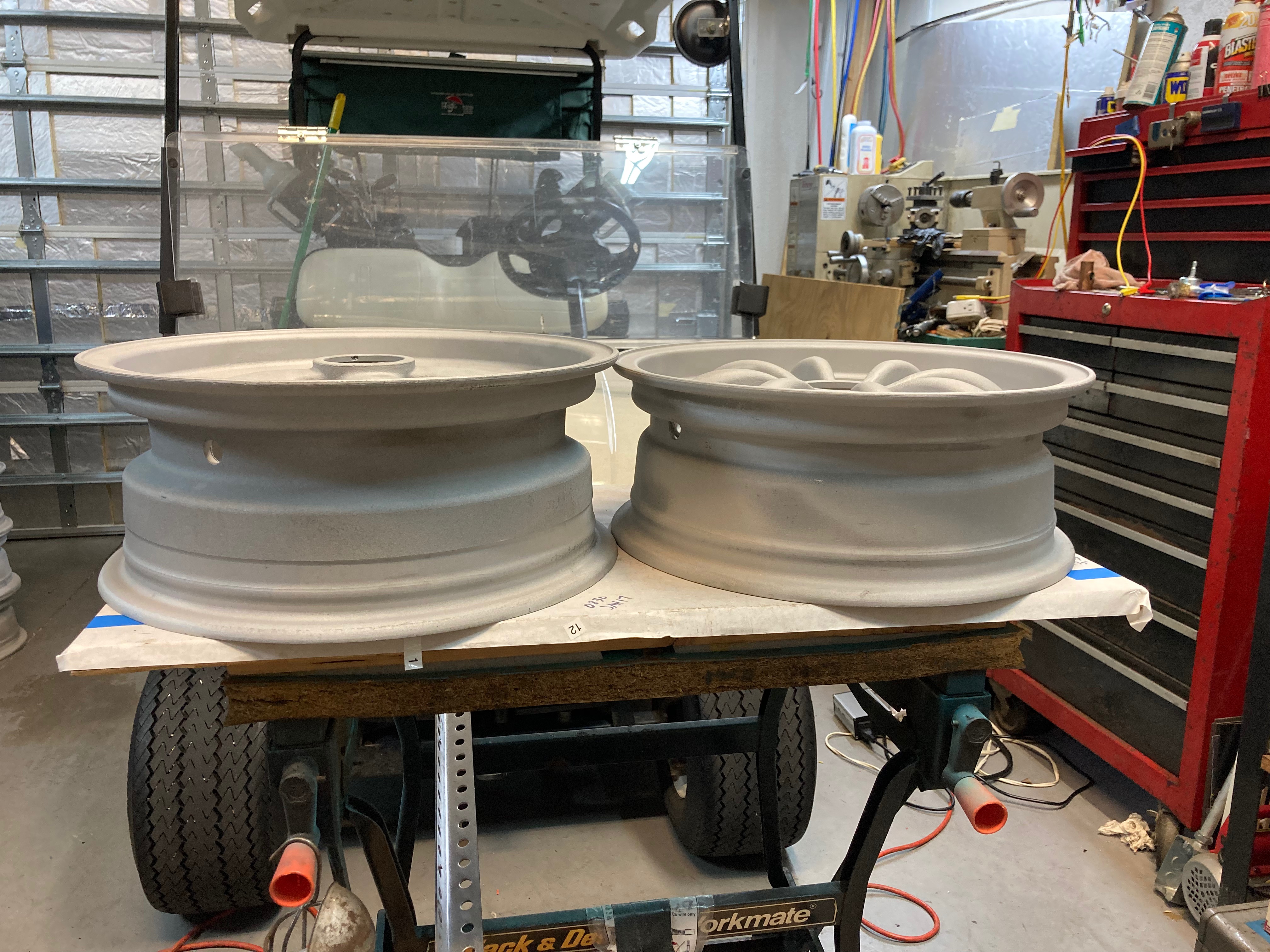

I have both sets of wheels glass beaded and getting ready for paint. The "EMPI" wheels do not say EMPI on them anywhere. What they do say is "MAX WHEEL" The American Racing wheels say nothing of value on them. The EMPI wheels are 5.5, and the American Racing wheels are around 6" wide. The American Racing wheels are a skosh bigger. Backspace on the EMPI wheels is 3-7/8" and on the AR wheels it is 4". I'm thinking I can fit the AR wheels in the stock wells (the fenders have been rolled), and I should have a wider tire selection open to me.

Another picture:Attached Image
