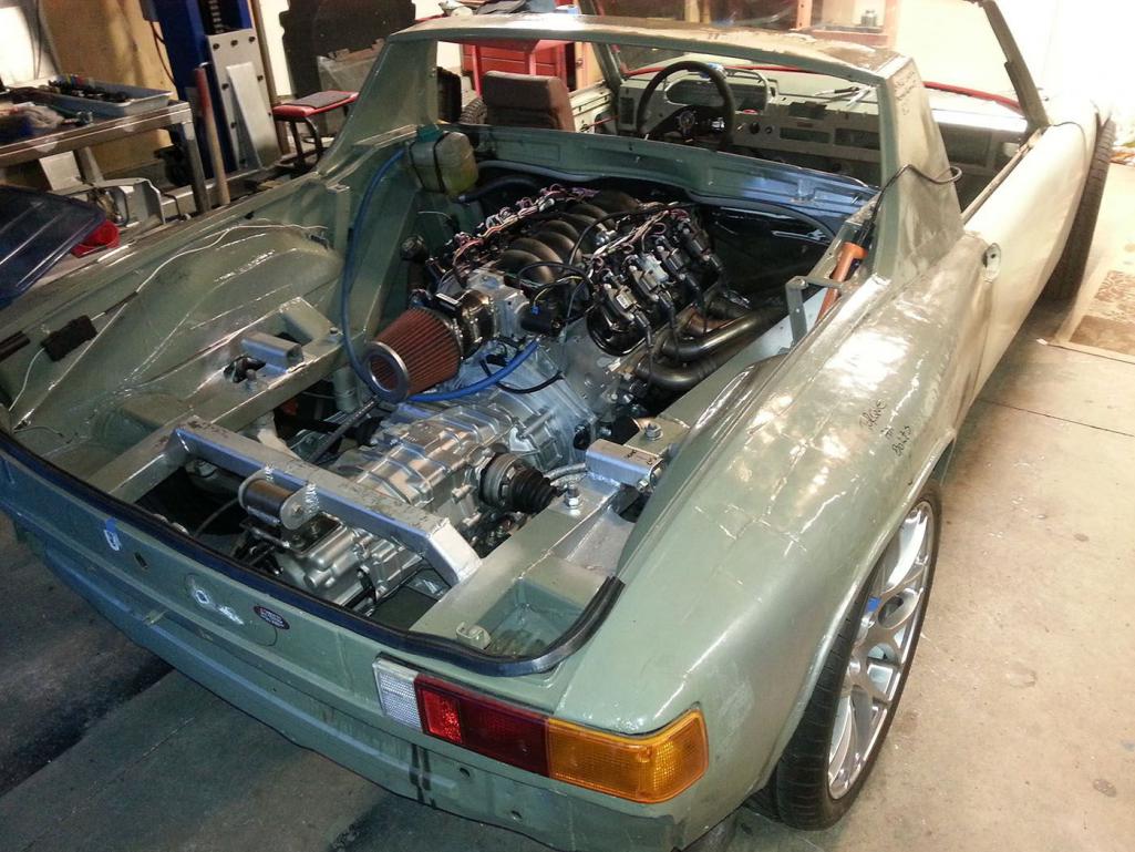

Here's one for you...
Not my car but do a search for Drive-ability post here and at Pro touring.com a few years ago.

When I was looking at transmissions for my big six, I researched the G-50. To put it in a 914, you have to flip it. But the bolt pattern on the bell housing is not symmetrical. So you have to plug and redrill the bolt holes. Then you have to cut out the rear trunk floor to be able to get the engine up into the engine compartment with the transmission. The axle shafts also run at an extreme angle, and you have to devise a way to shift it.
That's why I went with a G86-21 from a Cayman. Same basic transmission,but it is already mid engined. You have to make a clutch to adapt it to an air cooled engine, but you can buy off the shelf axles that work with a 914, and it is cable shifted.
And you don't have to hack out the floor of the rear trunk either.
Clay

If it helps, this is my thread on putting a 964 engine into a 914 chassis with a Cayman 6 speed (G86-21) transmission.
http://www.914world.com/bbs2/index.php?showtopic=279084
The goal was to put in the big 4.0L motor, and not have to modify the chassis. So I engineered it to work with the stock trans mounts. The only hole I had to cut was to run the DME wiring into the cabin.
I am trying to make a clutch kit up for this to sell, but I have been delayed by Covid and my full time job.
Let me know if you have any questions.
