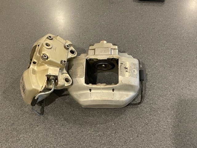

You would be amazed at what magic erasers can do. I just wiped all the brake dust off these calipers with a magic eraser and water. No solvents. Best thing was I could do it in the house and my wife didn’t complain about any smell.
If my wife is ever going to divorce me, it will be because I made the house smell bad with a solvent. She is very sensitive to that.
