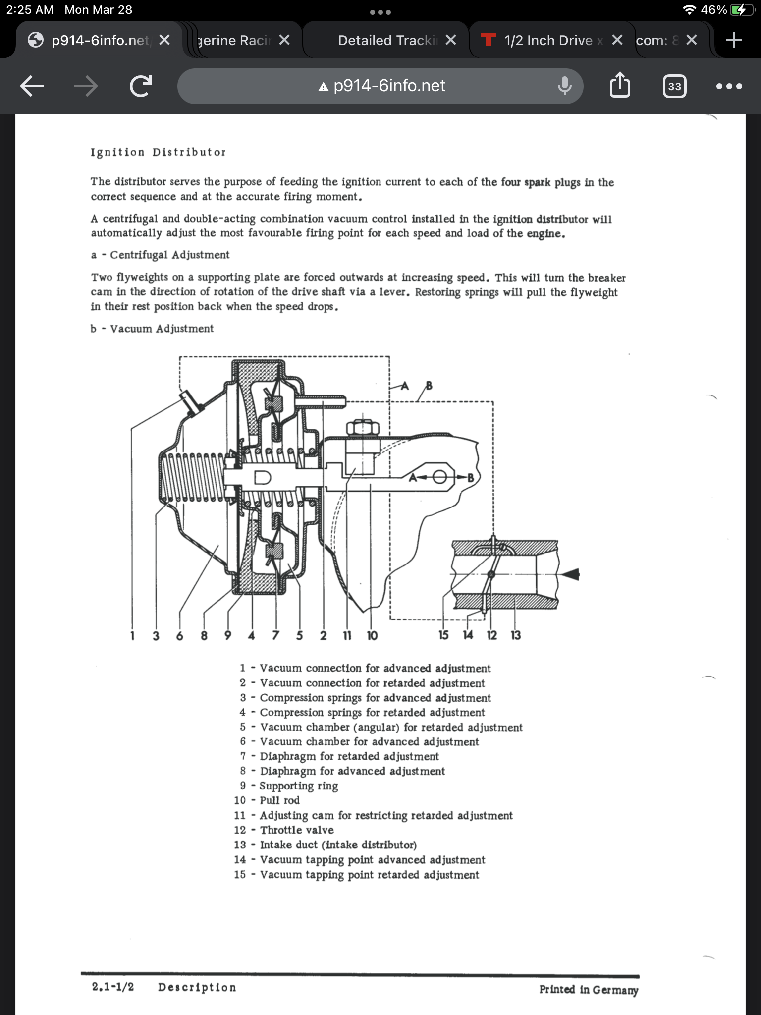

Van B
post Mar 28 2022, 12:29 AM
Posts: 1,621
Joined: 20-October 21
From: WR, GA
Member No.: 26,011
Ok, I’m too tired to think straight but yes, your timing should retard when the throttle is closed regardless of RPM.
Timing retard vacuum is pulled from the bypass port on the throttle body, which is only used when the throttle plate is closed.
Look at line B
wonkipop
post Mar 28 2022, 01:34 AM
Posts: 4,803
Joined: 6-May 20
From: north antarctica
Member No.: 24,231
QUOTE(Van B @ Mar 28 2022, 12:29 AM) *
Look at line B
you are not getting tired, you are getting really good.
correct on all counts.
why it would be rich....?
could be connected to that?
but i would have to think about that too.
those two ports behave slightly differently.
when throttle is fully closed the one on the manifold side of throttle plate activates retard can on distributor.
the other one, on the inlet side works at part throttle and cruise to advance the distributor.
and in typical VW fashion the advance one serves to cushion the distributors response to load.
but, its meant to lean for emissions when you close off throttle.

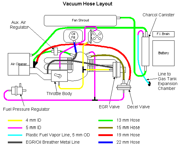

emerygt350
post Mar 28 2022, 10:44 AM
Posts: 2,980
Joined: 20-July 21
From: Upstate, NY
Member No.: 25,740
Is this correct?
I know they changed stuff every month on these things.
Van B
post Mar 28 2022, 10:45 AM
Posts: 1,621
From: WR, GA
Member No.: 26,011
the little subset square on the airbox is meant to represent the AFM... poorly lol
