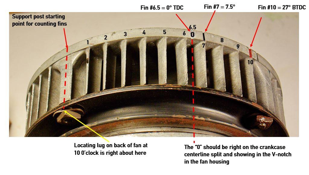

EDIT: Timed to the 27BTDC (mark) at 3400, cannot get a reliable idle (800-1k) to time at the 7.5 degree mark seems to run well on throttle but as revs drop stumbles & will not stay lit.
This was a carbureted 2056 originally D-jet so the impeller has marking for both D-Jet & L-Jet (0=TDC, 7.5 & 27 degrees BTDC)

There is no 27 degree mark for the L-Jet. I wonder if you have a fan from a D-Jet on that car? You should only have one red paint mark that is 7.5 degrees BTC.
Having timing off like that would make your AFRs off as well.

On last time: Does your fan have the single red paint mark or is it the D-Jet fan?
wonkipop
post Jun 24 2022, 05:08 PM
Posts: 5,778
Joined: 6-May 20
From: north antarctica
Member No.: 24,231
QUOTE(Van B @ Jun 24 2022, 03:28 PM) *
it might be that its a bus fan or something.
but your point is right @Van B .
should have only that one mark at 7.5 and thats the one you want.
