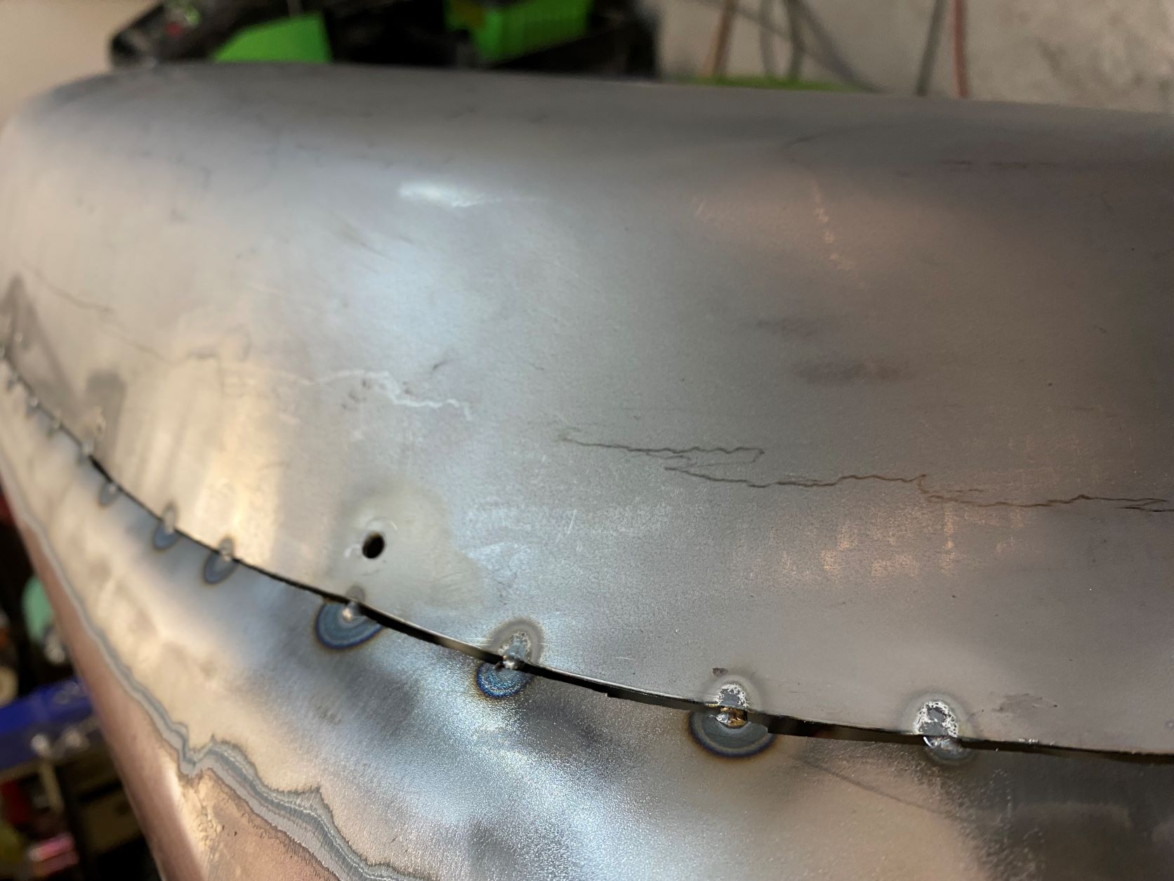

@76-914 , @tygaboy , @Cairo94507 . Thanks for the words of encouragement. Good advise on resizing the pictures, although not sure why the forum software keeps some pics in their correct orientation, and skews others 90 degrees (even though they were uploaded in the correct orientation).
Here are a few (many) pics of the flare installation. I included some detailed pictures of how the flares integrate with the existing body work. In my searches this was not very intuitive and took some digging. Hopefully will help someone visualize more easily in the future.
