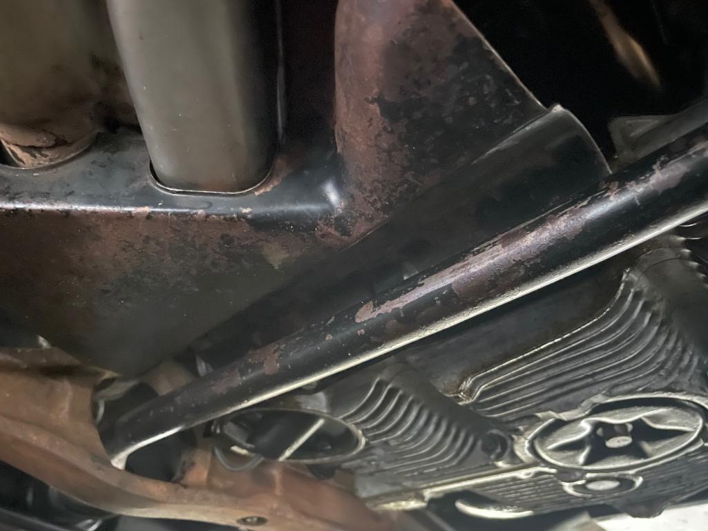

After only 3 years of project work, I realized that I am missing the lower-most engine sheet metal parts on both sides. These are the horizontal pieces that sit even with the heat exchangers. How important are these? Any advantage in not having them?

You want them. They help with engine air flow. They aren't expensive and can be installed easily.

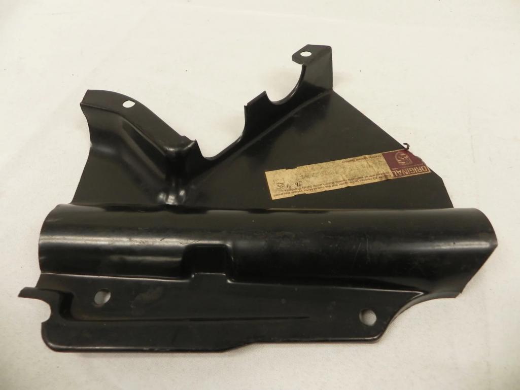

I have a NOS one. I'll check the part number on it later today. I think I paid $10 for it. You can have it for $10 plus shipping.

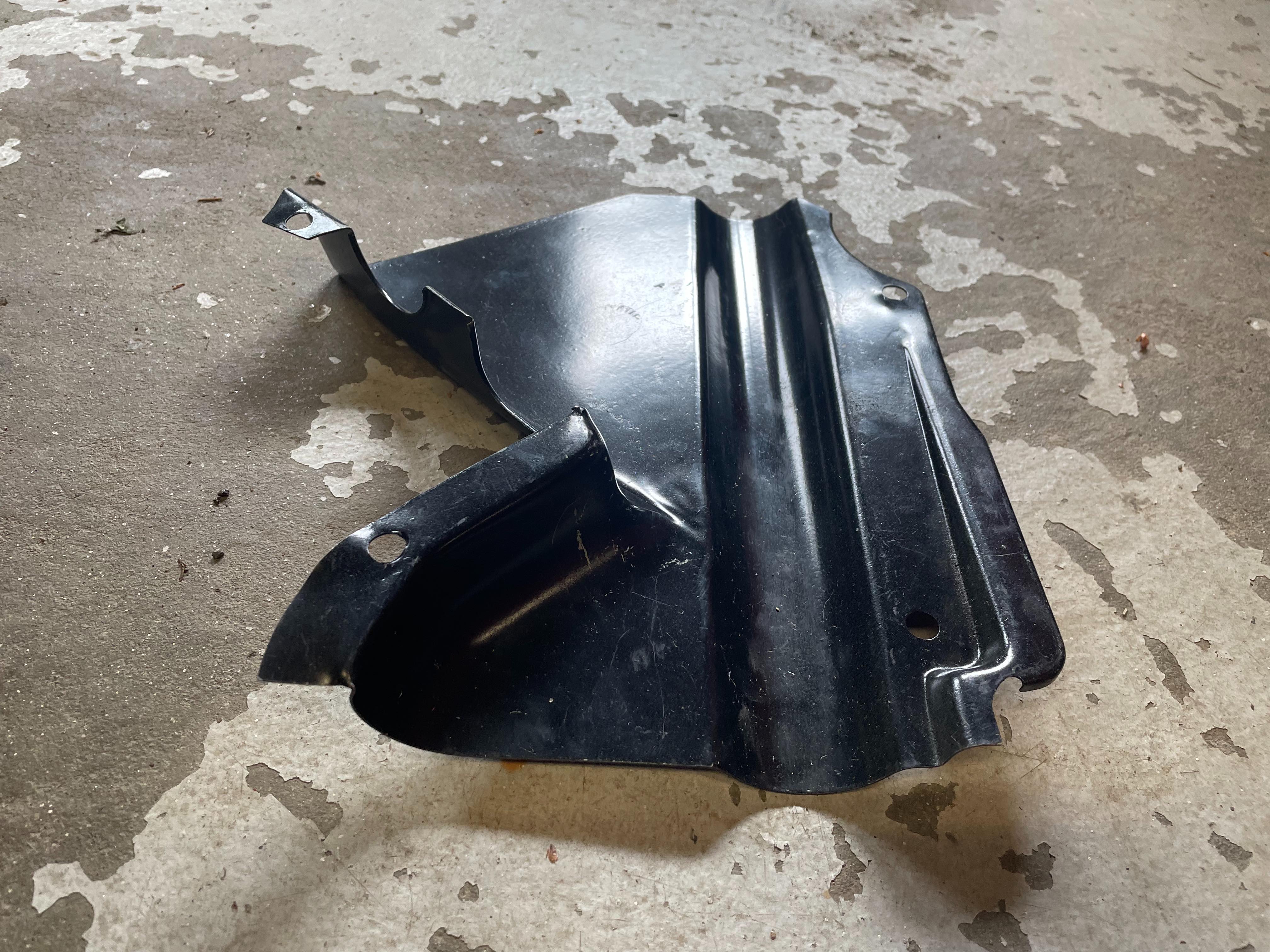

I thought there was a part number sticker on it, but I guess not, so I'm not sure if this is correct.

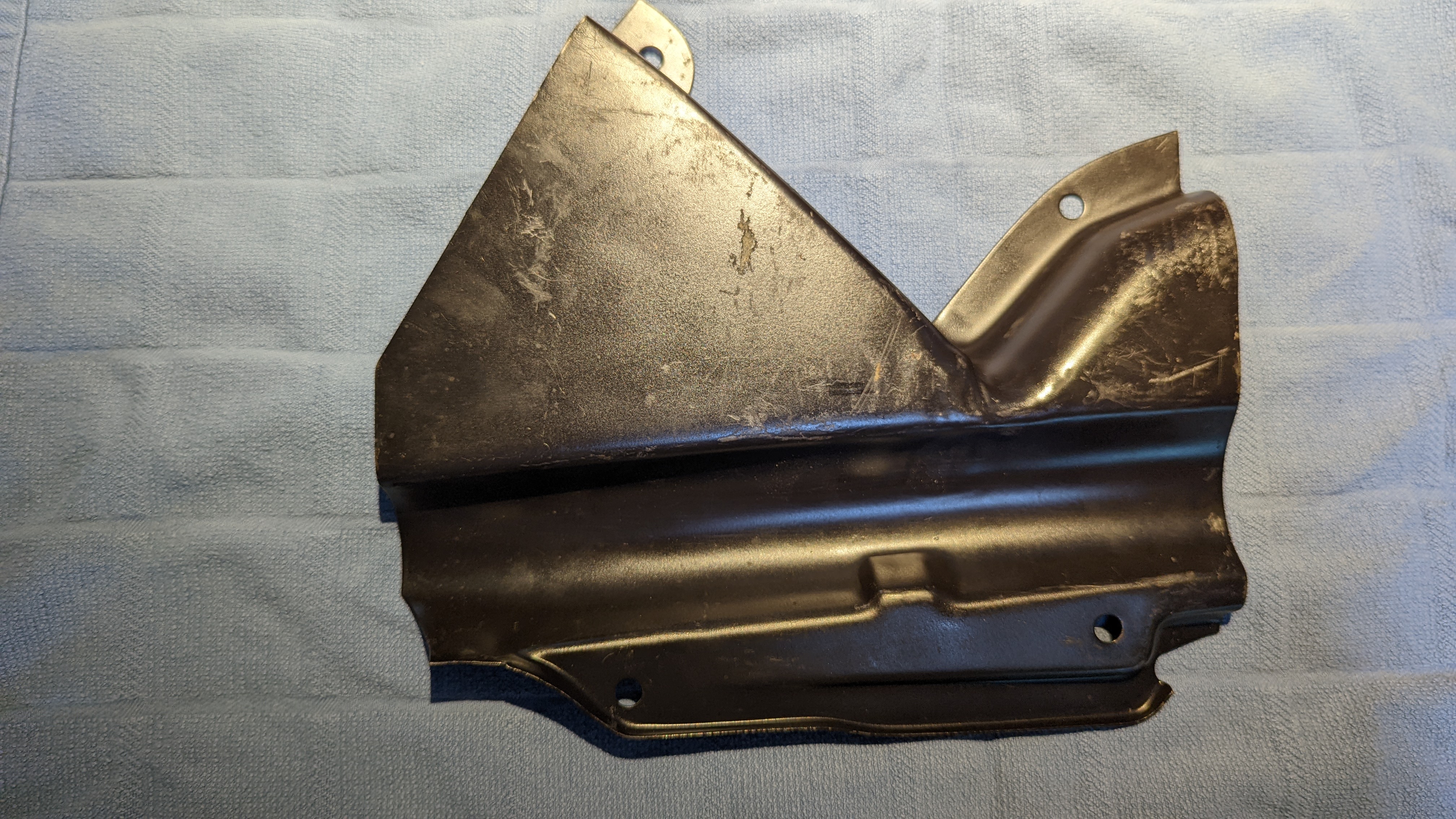

post Jul 17 2022, 11:41 AM
Posts: 1,791
Joined: 16-July 13
From: Edgewood, New Mexico
Member No.: 16,126
