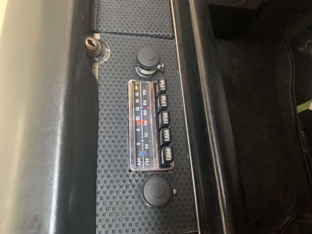

Had been contemplating a stereo upgrade. Had read all the threads. Wanted something that would require minimal disturbance from stock and be unobtrusive
Had already committed to a period correct Blau Frankfurt with the digital conversion. I knew that the Infinity Kappas were a good solution in the original speaker housings so went with those. In looking for a small powered sub I found the Pioneer TS WX010A. Chose it because it is about the smallest one out there and is a small 50 watt amp that requires no heavy wiring

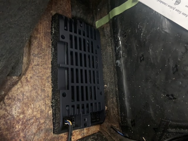

Figured it’s small size would provide a variety of mounting options without have to cut up any interior stuff. What I did not know was how well it would fit. After taking out the foam filler block, I found that This thing fits in the recess in the passenger footwell like it was designed to be there. See pix below
I held it into place using the double face tape provided with the sub. This tape also nicely isolates the speaker so it does not rattle against the firewall/floor structure. Once the foam block is trimmed and put back into place the carpet covers it all and it essentially is undetectable.
The thing has great adjustability in gain and frequency. Both are turned way down and provides all the bass you could ever want in our small cabin. Paired with the Kappas it sounds great
Overall a very sanitary installation and a pleasing ( to me anyway) solution.

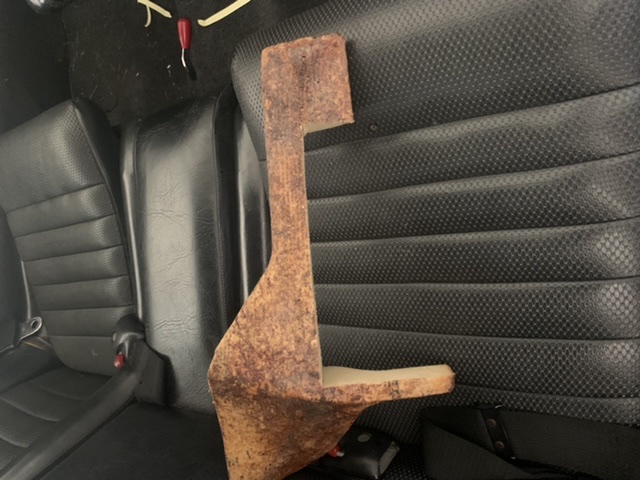

Working on it! There you go.
Can’t get spaces between pix but I hope you get the idea
Appears this footwell cavity is the same in later cars. I know the foam block in later cars is bigger, so this thing would fit fully within the block in a later car. In this 70 it only protrudes about 3/4” past the foam which is not noticeable behind the carpet.

Nathan, pull the foam block and you will be amazed how the thing fits. Gotta mount it so it is isolated or it will rattle against the steel structure.

There are several people that convert vintage radios to solid state amps and tuners. They integrate all the classic knob and button tuner functions and can even add Bluetooth. I used Vintage Blau. http://www.vintageblau.com/ Ingo is great to work with and is dedicated to classic radio restoration. They massage the tuning mechanism, looks and works like new. Not cheap but fidelity is pretty good, tuning is sharp and the power is impressive. All fits in the original case.
Not sure how to better show the install and these are all the pix I took. I’ll repeat these two pix as I think they best show how it goes together.
This sub is advertised as designed for mounting in footwells. It is designed to mount with sound outlet projecting into the floor. It fits better in the footwell recess projecting out. I tried it both ways and could not discern a difference in sound quality so went with the better fit.

You can select phase right on the amp with a simple switch
The unit comes with an 8' plug in harness that includes the power and ground lead that are only 18 gage wire. The amp only pulls 4.5 amps with a 10amp fuse recommended. I just ran the power wire to the "ignition on" switched side of a relay on the stock relay panel. No special wire.
Even with this low power consumption I barely have the gain set at maybe 25% and that is plenty!! On music with any sort of hard bass line it will bounce a screwdriver sitting on the passenger floor.
I hooked the radio rear speaker leads to the amp via a line converter that converts the speaker wire leads to RCA jacks. The amp does have a switch to optimize for speaker wire input or RCA input. I assumed RCA probably provides better fidelity.
Trust me, this thing rocks way more base than you can stand in our little cars. You can easily modulate the amount of base using the tone switch on the radio. My digitized radio also provides a blue line out switch that turns the amp on when the radio is on. There are line converters available that sense when power is going to the speakers and provides this same "accessory on" function if your older radio does not provide this function.

Tonight I added blue tooth to the system using the aux in RCA jacks that I got on the radio when I had it converted to digital. I used a generic blue tooth receiver.
Oh baby! Sirius XM streaming through my phone blue toothed to what appears to be a stock 1969 Blaupunkt Frankfurt. Much better fidelity than FM and no commercials. Ain’t technology wonderful!

Crutchfield. In my pictures you are seeing the underside. Fits best in the firewall recess turned this way. I couldn't discern any difference in sound turned either way.
