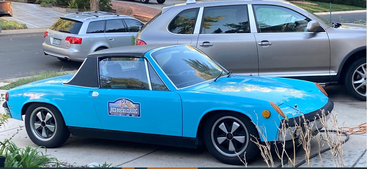

So, jump forward. My 914 -6 conversion now has its 4th motor and can move under its own power. Planning on driving from Denver to Salt lake for RRC.
About 5 years ago I decided to jump into the 914 world. I have several 911 engines needing projects and roller 911's have become really expensive ( and I have two 911 rollers that are already planed projects) so I bought a 914 for a -6 conversion. Not knowing much at the time I got lucky with pretty rust free 73.
It has kind of become my engine mule. First engine was a 2.4 MFI motor with S pistons and Ecams. Used it to decide if I like 914's, I do.
Mule as it looks now.

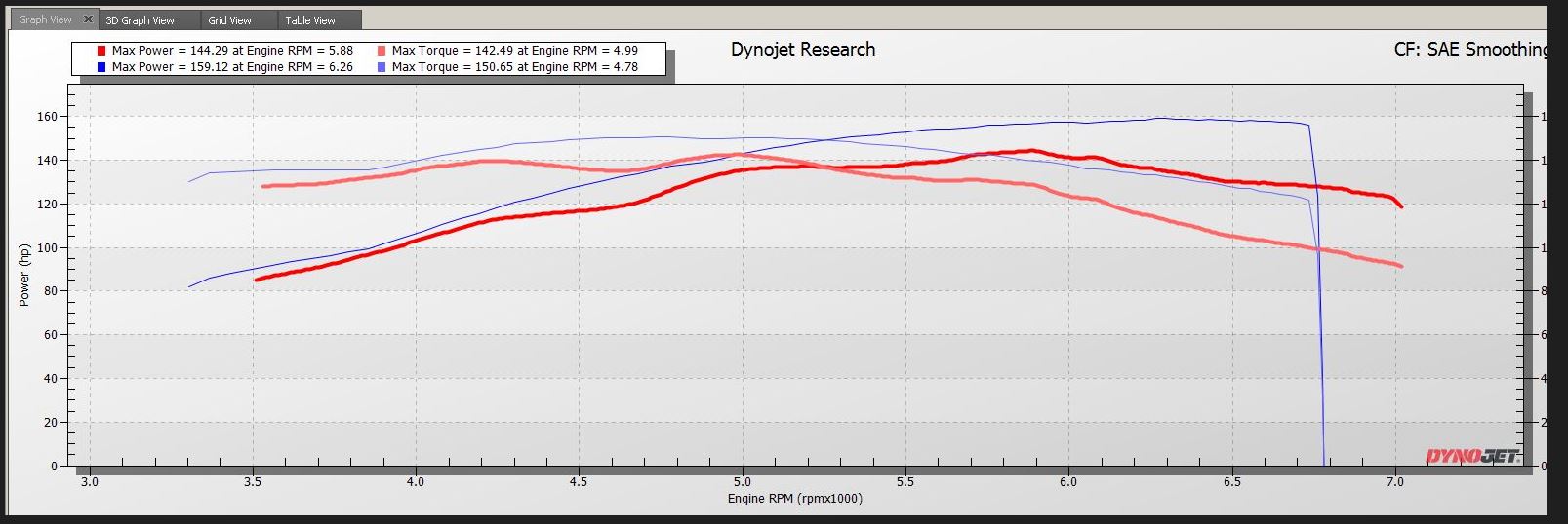

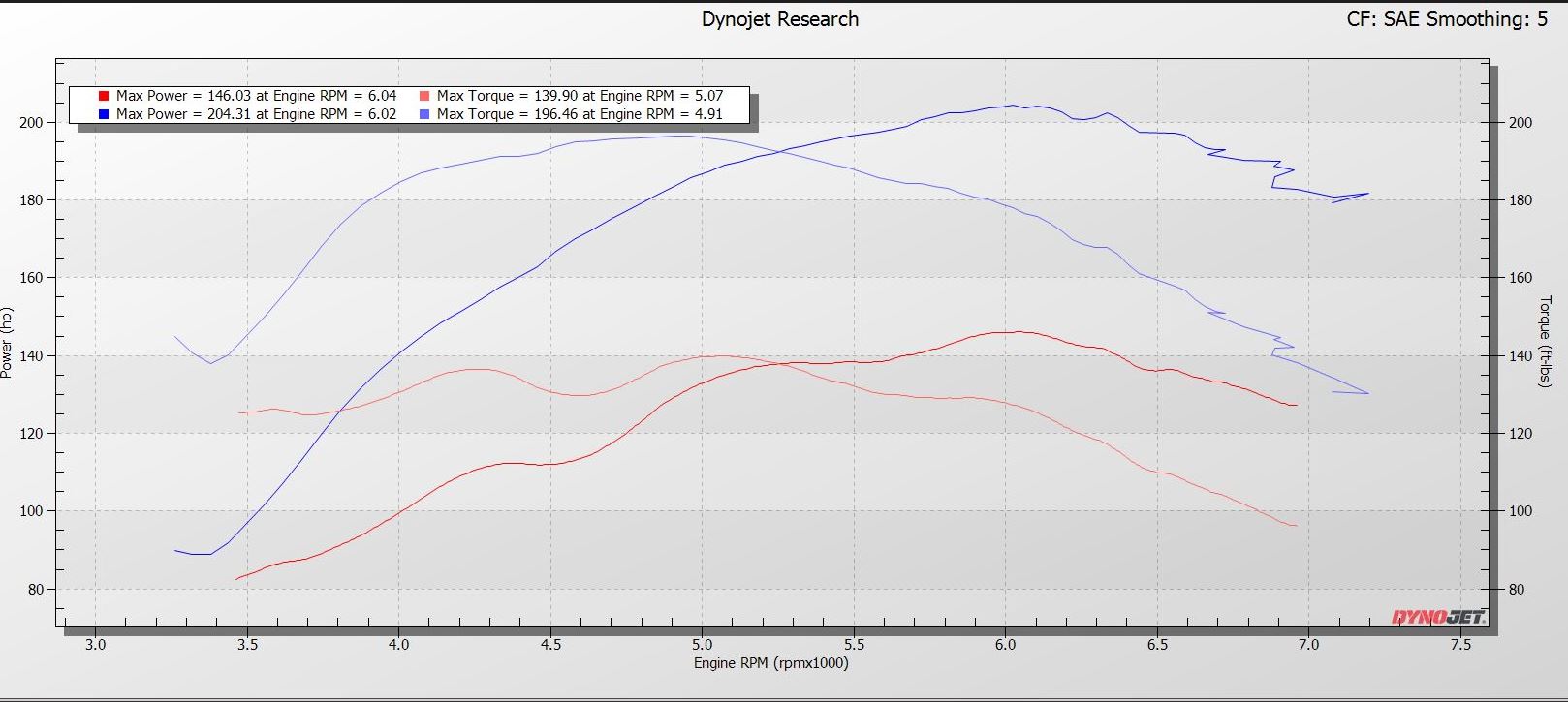

Looks like an interesting thread and story. Quite a lot of early 911 engine experience also
And some nice data
Being a dyojet i assume those are WHP numbers vice crank HP??
