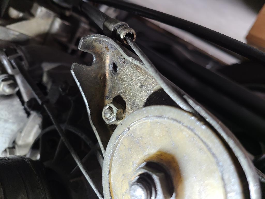

The plot thickens... I am missing the stop plate washer, the boot and a washer on the roller. I am wondering if moving the pedal board around caused some slack and the cable changed position due to the missing washer making the clutch operation more slack. I was able to move things by hand easily. It was not like this until I pulled on the cable a little. It should not do this so easily...

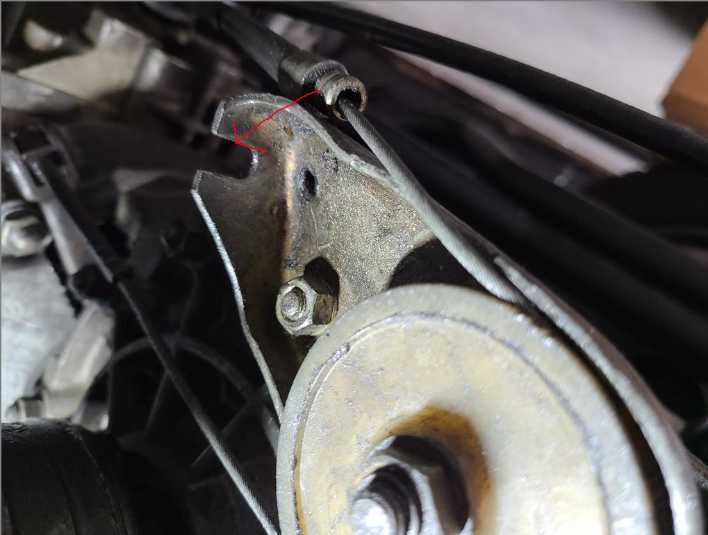

targa72e
post Aug 25 2022, 10:59 PM
Posts: 307
Joined: 11-September 16
From: colorado
Member No.: 20,392
Your clutch cable is not engaged properly. The cable should be in the slot at the point of the arrow in pic. None of my cars have had that washer listed by others but seems like a good idea. One car I purchased had some wire to hold the cable in place. I will probably add the washer as it seems like a good idea but has not been a problem yet.
Having just adjusted my clutch tonight. Adjust the cable at the tranny end until you get to the point that you can just put it in reverse with out grinding.
john
BeatNavy
post Aug 26 2022, 05:09 AM
Posts: 2,967
Joined: 26-February 14
From: Easton, MD
Member No.: 17,042
QUOTE(NARP74 @ Aug 25 2022, 11:52 PM) *
The cable goes through that washer and the "pointy" end is inserted through that square hole you see in your picture (center, above the M8 nut) and bent around to keep it in place. It's needed.
Your picture explains a lot of what's going on now!

Thanks all. The cable was in the U shaped slot before I started pulling on it. I don' think it would shift at all if it wasn't. The pic I took was after I pulled on it and it popped right out without the beer can washer installed. Shows how much slack was in the line. Seems like a series of small events that lead to the clutch not performing properly.

Got the repair parts, thanks Mikey. Took it all apart, cleaned it up and started the install. The threads at the end of the cable were buggered so I had to chase those the whole way. Got it back together the proper way and am going through the clutch adjustment, test drive, adjust process. Much better now. 10 bucks worth of washers and rubber boots that someone skipped during the re-install.
