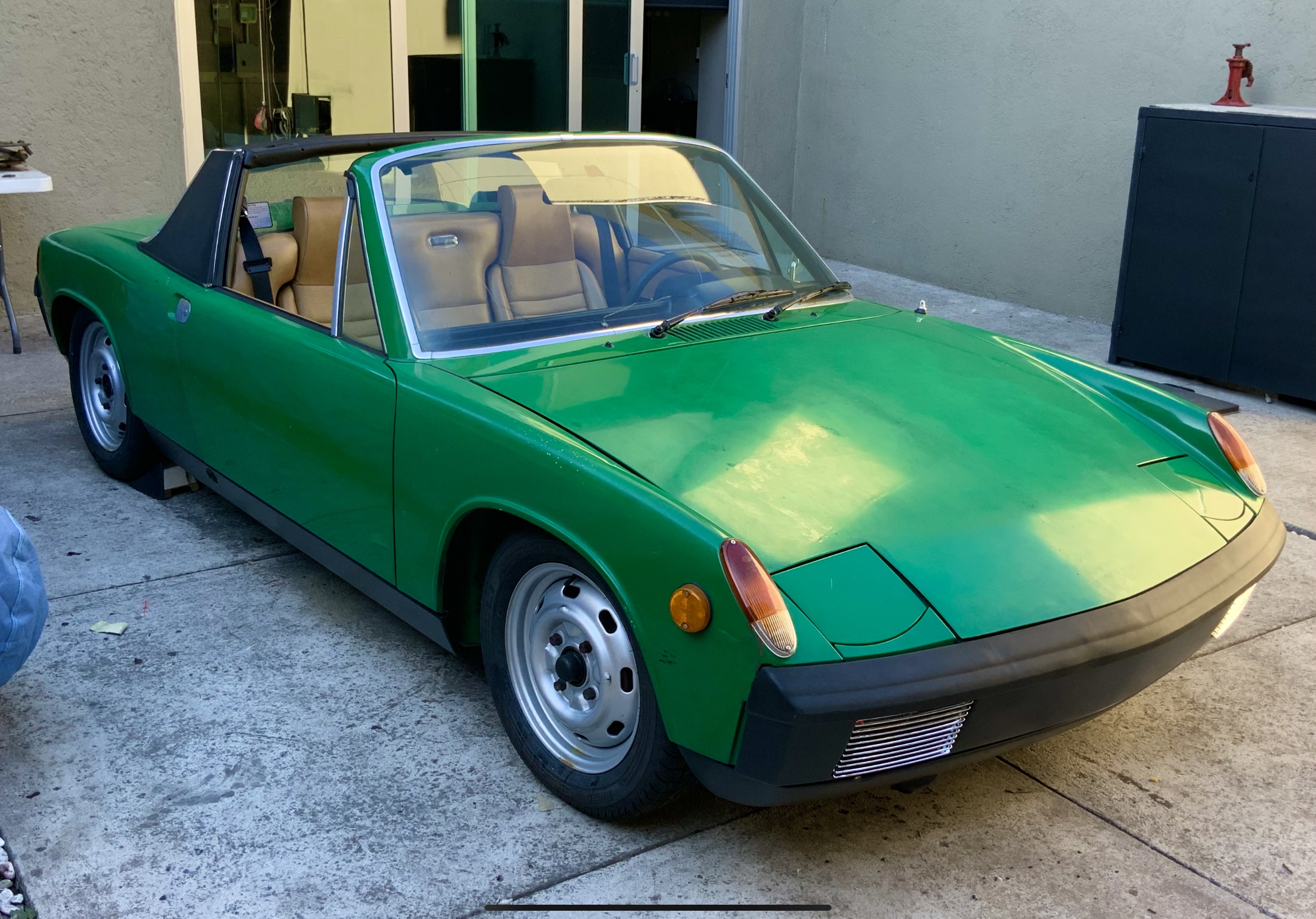

The time has come to paint the 914. It is a 1973 Zambezi green w/ beige interior 1.7 car that is in really good condition (2 owners before me and the original owner sold it to a friend of mine about 5 years ago). The car has a manageable amount of rust. Small spot in one of the jack plate covers and a larger area where the engine insulation pad trapped water. The hellhole has been re-done along with the battery tray.

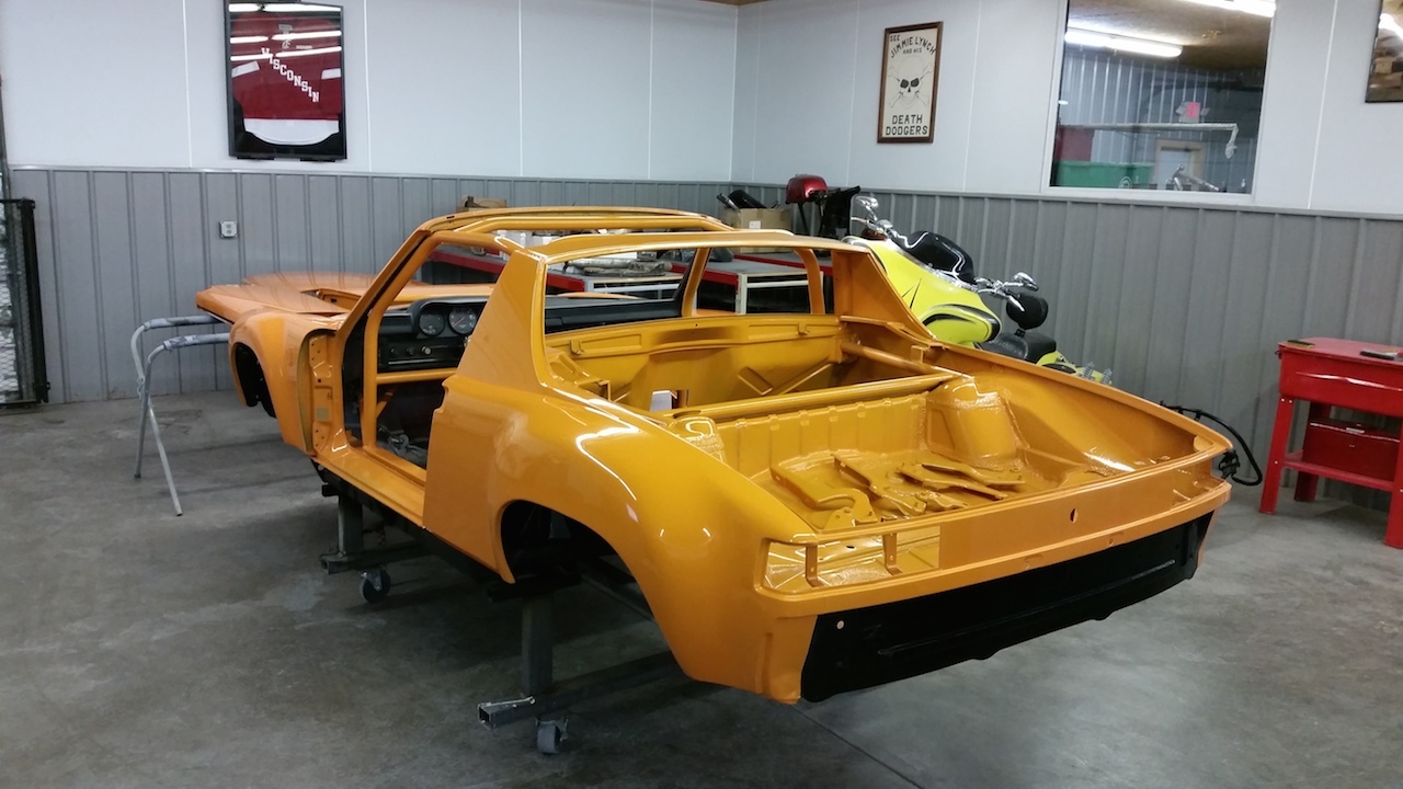

It's (of course) the prep that costs the bulk. I had my 914 painted with some body work done for about $11k. I did 98% of the metal work and repair. The shop did a bit more welding and shaping, but it was minimal. The work was mostly removing crap paint, shape, skim, flat board etc. prime, paint, cut and buff.
I wish I would have spent a bit more time on door gaps before sending in. The shop painted all lids off, both trunks and door jams.
Keep in close contact with the shop, remind them of your budget with each contact. Also remind them there is no rush as long as the project stays within budget. Oh yeah, remind them again to stay within budget.
(IMG:style_emoticons/default/wink.gif)
Post 120 shows the shops progress:
http://www.914world.com/bbs2/index.php?sho...4276&st=120
Turned out very nice.

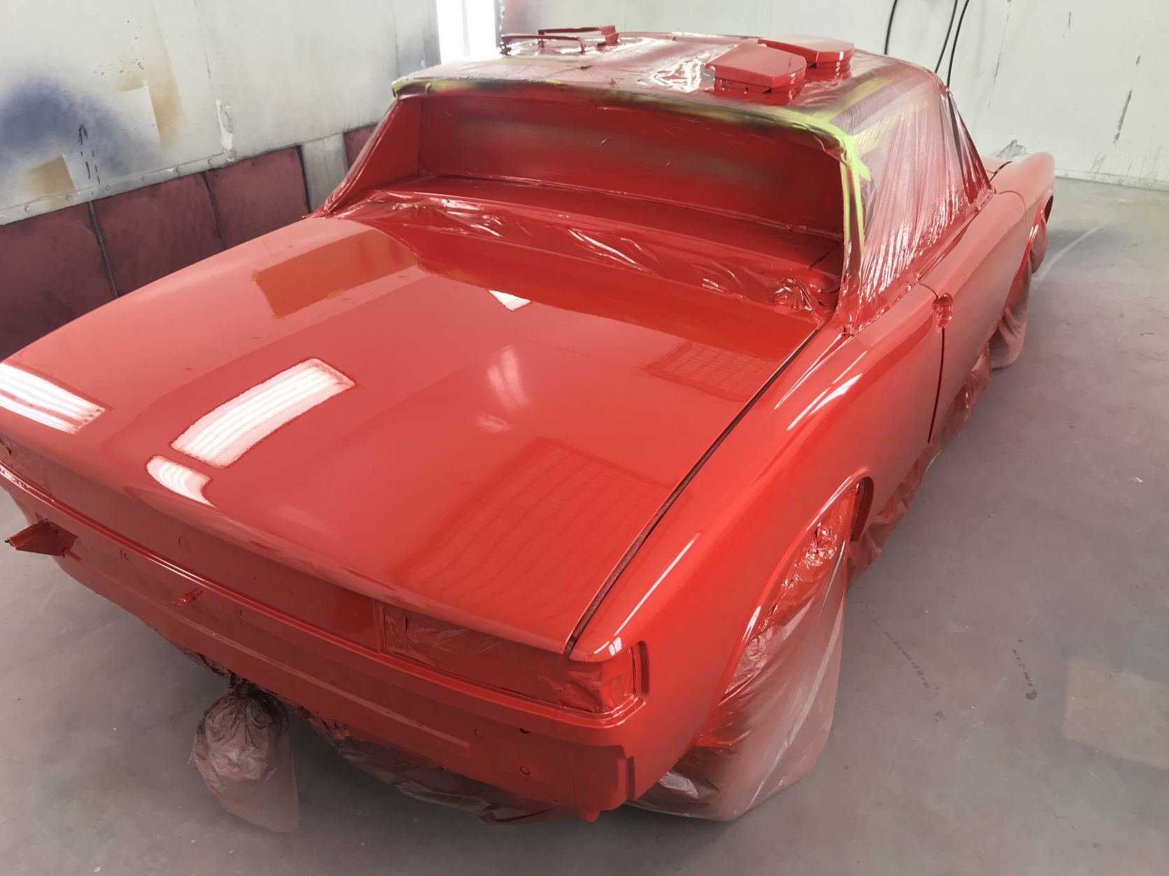

A guy brought his half finished 914 to Okteenerfest this year. He used Rustoleum rattle cans and the paint job was incredibly good! He must have color sanded and buffed for hours. Ask anyone that was there how good it looked. Sorry, I have no photos but the Okteenerfest thread probably does.
