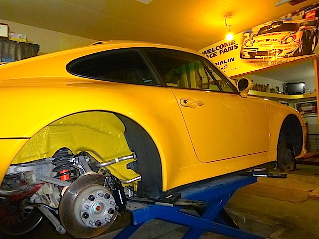

Rear wheel adaptors, factory on 993 Carrera S wide bodies. Never a problem. MarkAttached Image
