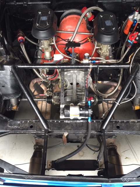

Not great, but here are some pics of my engine compartment. My engine has a 911 style (FAT Perf.) fan shroud so it's similar to your 6 cyl fit, but more space between fan and firewall. I do have a dry sump with the oil tank taking up some of the drivers side engine compartment. 6 installs typically put the tank up in the front trunk. My car has 2 coolers in front with lines back to the tank. I'll take pics of that soon too.
Rear trunk area cut out for access to trans, cv's etc
The original "shelf" with the channel for weatherstripping is mostly intact, but cut away where air ducting from the front was channeled back to the engine. With the 911 type shroud and no engine "side tins" it leaves quite a bit of gap between engine and firewall / engine compartment
Oil tank is on the drivers side against the firewall. As said. with a 6 there's probably not room back here so most people put the tank in the front. Mine is a 4 so it has a 1.5 gal tank. You'll want a bigger one for as 6.
I'm overdue to put together a photo thread on this car. It's pretty well built. I'll try to get to that soon - ish....
