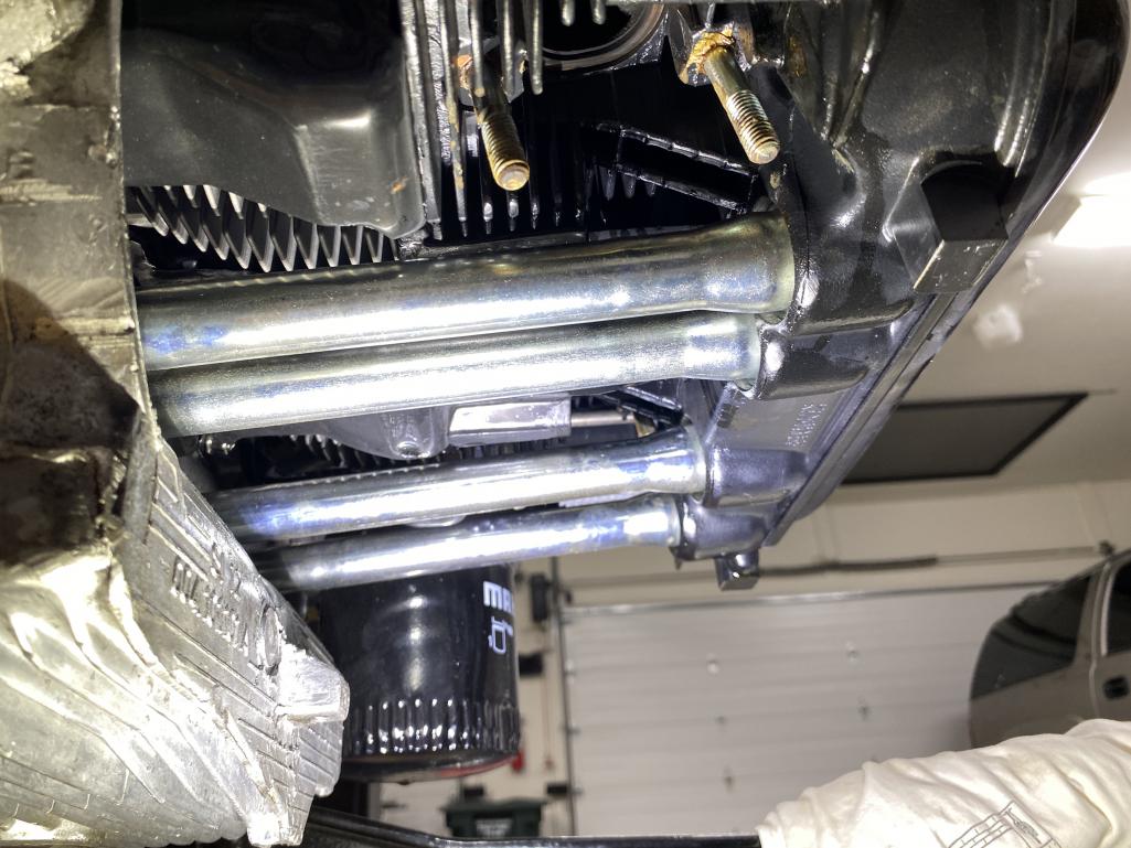

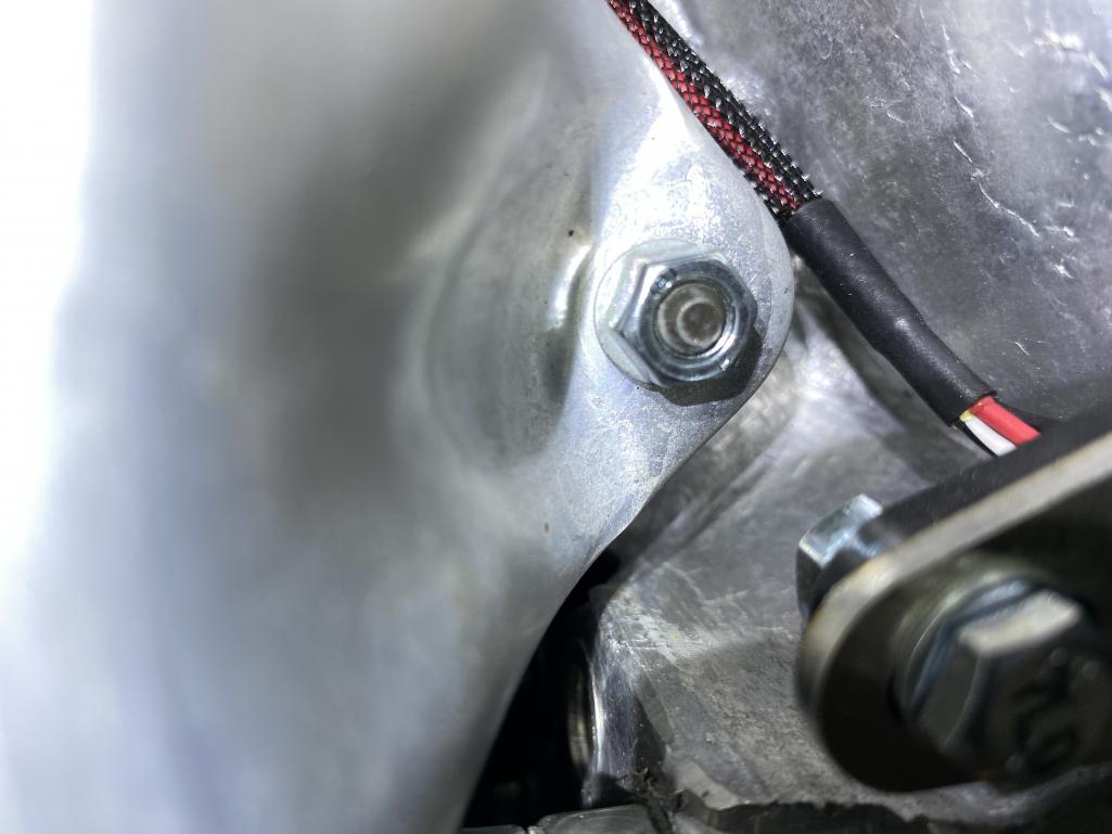

As I described in my build thread, last year, once I got the engine running, I noticed significant oil drops (or more) after each drive. With winter in full throttle, I decided to drop the motor, and see about fixing the leak.
Here's the view of the front. Maybe you can see some oil.

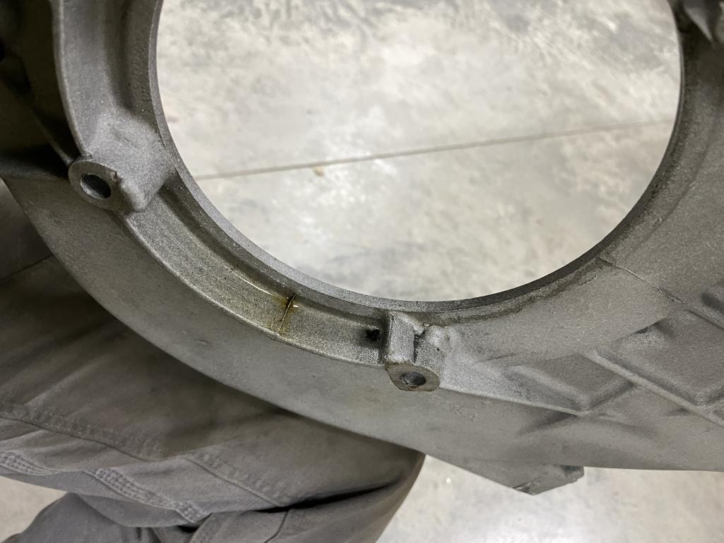

Member No.: 23,343
I found some oil inside the inner blowing housing, along the recess for the blower cage.

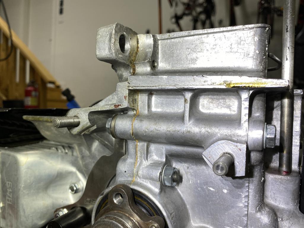

Member No.: 23,343
Starting from the top, the case seam looks OK.

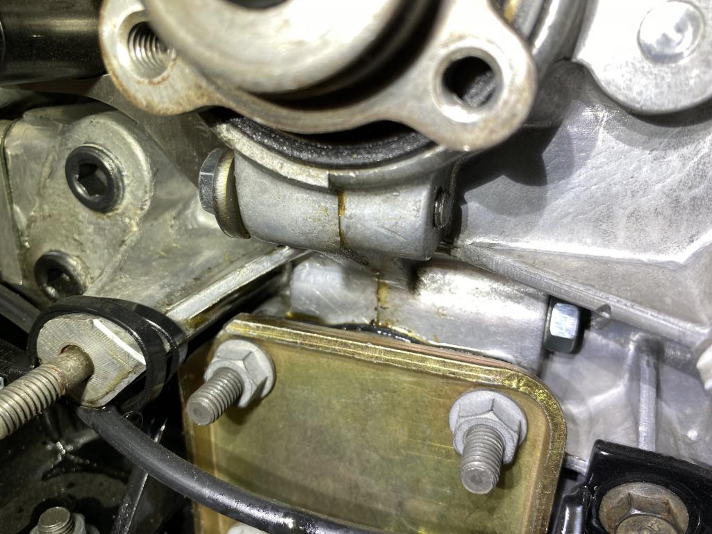

Member No.: 23,343

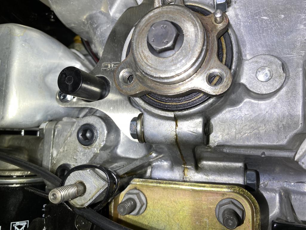

The front seal looks a bit oil wet. But is the seal leaking, or oil blowing from elsewhere?

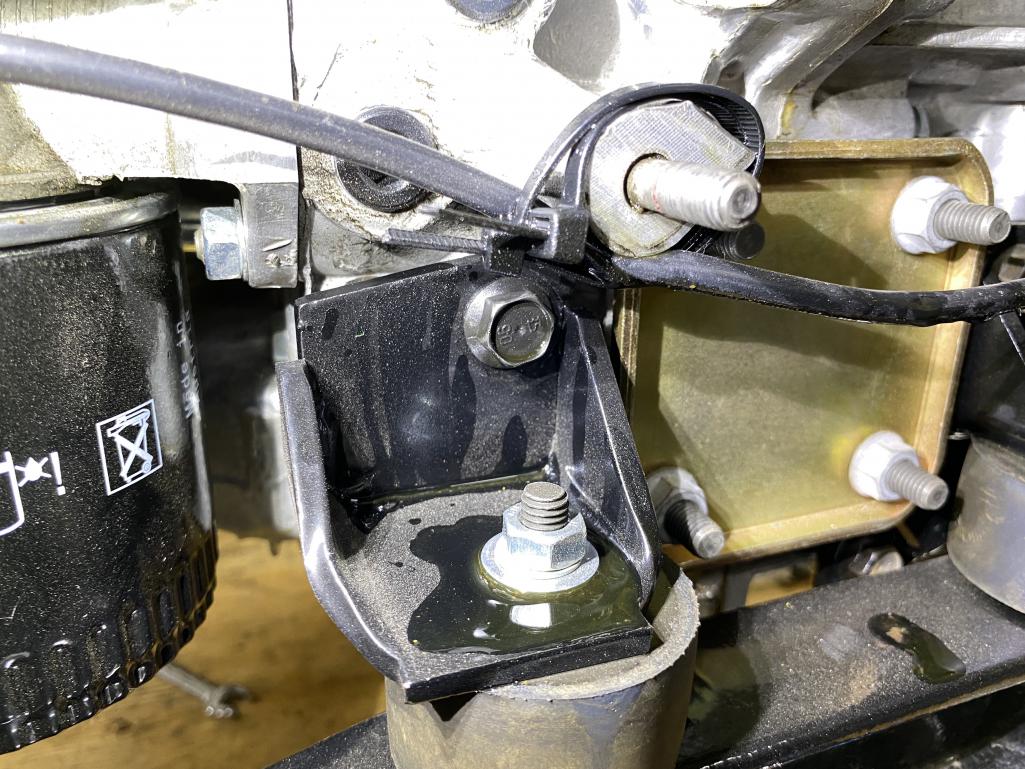

Member No.: 23,343
Quite a bit of oil pooled in the right motor mount bracket, probably dripping from the inner blower housing.

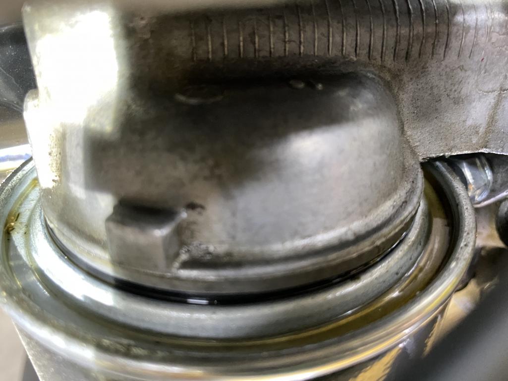

Some oil sitting on top of the filter.

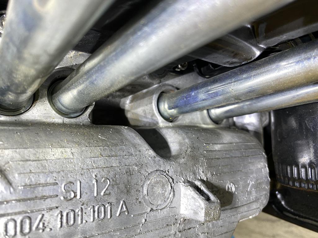

Member No.: 23,343
Meanwhile, underneath I might have just a bit of oil weeping from the outer pushrod tube seals and/or the valve covers on both sides.

Member No.: 24,781
Looking at that black wire on the front of the engine, does it end up reaching up so oil could follow it down to the wire zip ties? I see seepage, at the front seal, but nothing bad. I've had a poorly made oil filter leak and shoot oil out and looked like a cooler leak.
porschetub
post Jan 6 2023, 01:35 PM
Posts: 5,065
Joined: 25-July 15
From: New Zealand
Member No.: 18,995
QUOTE(Shivers @ Jan 7 2023, 02:00 AM) *
(IMG:style_emoticons/default/agree.gif) front seal for sure,well be interesting to see why it is leaking,not generally a concern except on a high mileage motor.

Member No.: 23,343
Thanks everyone. Based on what I see so far, I will replace the front shaft seal and O-ring, after checking the seal surface on the hub, reseal the oil pump cover, and replace the oil filter. Any other ideas?
I see oil at the top of the case on the right side under the filler chimney. Make sure the seal for the filler assembly to case are properly installed. I glue the cork rectangle to the metal "box" with 3m weather strip adhesive. I think there is also an o-ring at the base of the filler neck/metal box.
