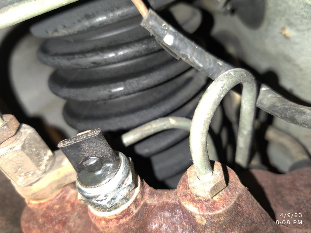

SVG223
post Apr 9 2023, 09:32 PM
Posts: 115
Joined: 6-February 22
From: Benton Arkansas
Member No.: 26,317
I pulled off the wire and it stopped flashing, which was good enough for me.
