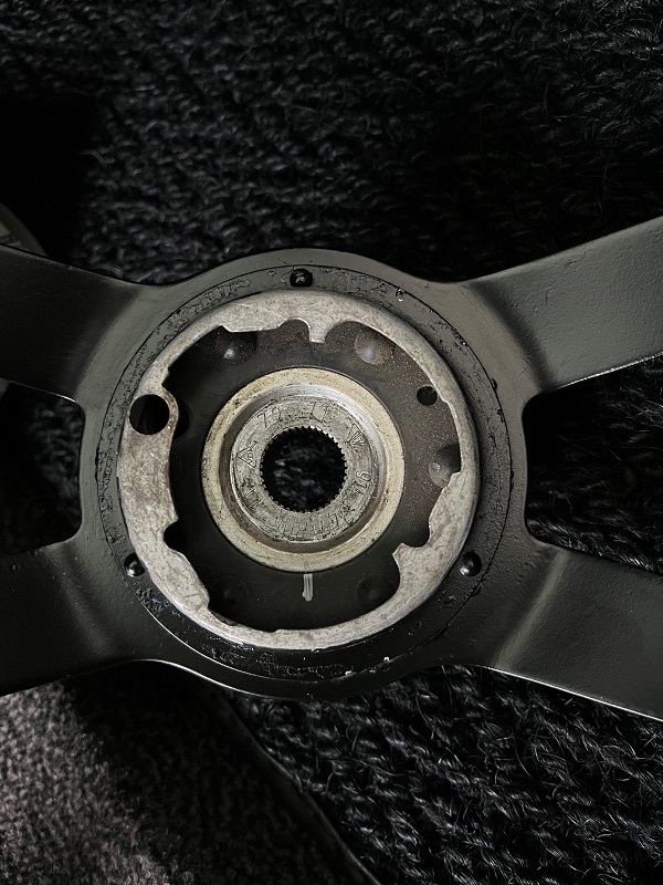

Car is a 1975 and I am going back to the OEM steering wheel from a Momo. I bought a steering wheel listed for a 1975 car, but it didn't come with the horn pin. I see there are two types, long and short with each saying they fit a 1975 1.8 car. How do I know which is correct for the steering wheel I have?

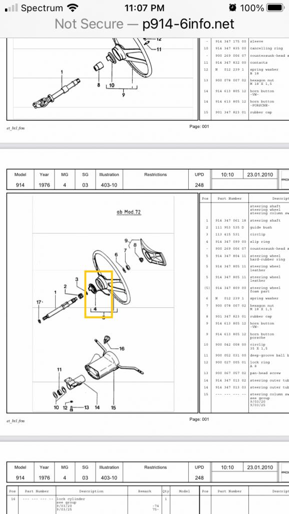

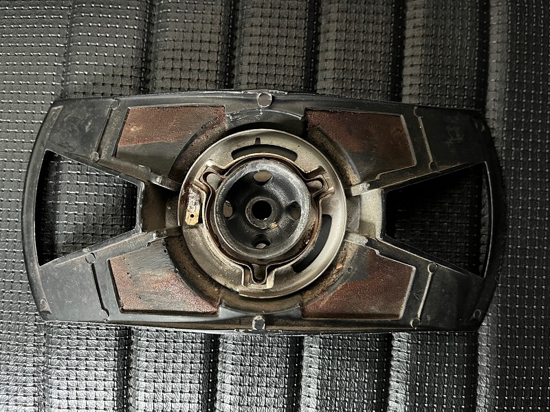

As mepstein said the difference is the slip ring.
#4 is the slip ring, it replaces the pin. The brown wire (ground) connects to the batwing which completes the circuit to ground when the batwing contacts the slip ring.
The horn has power all the time, when the circuit is complete to ground the horn operates.

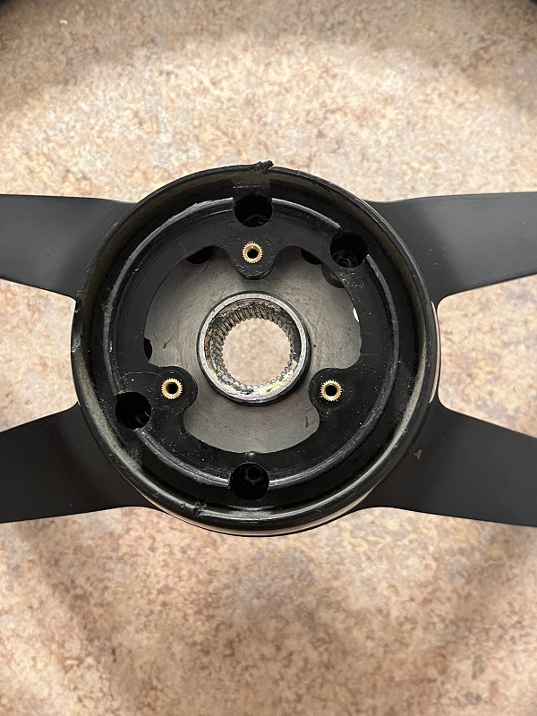

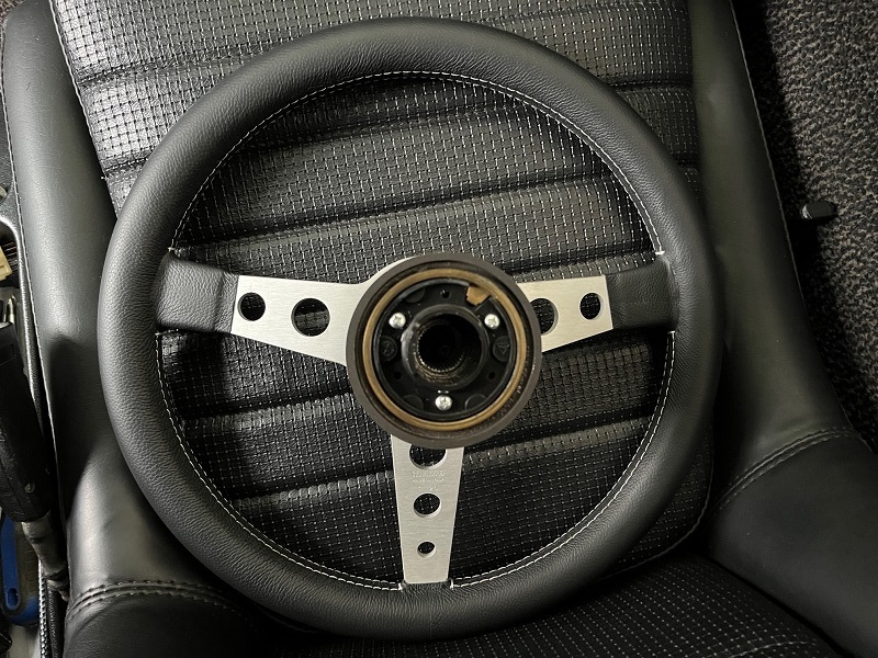

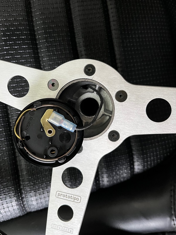

Seems I don't have the brown wire I assume I need for the OEM horn to work.
This is my working Momo set-up and I understand how the bronze ring is in constant contact with the contacts of the directional mechanism and how when the horn button is pushed the horn grounds out and sounds.
Attached Image Attached ImageAttached Image
MSGGrunt
post Mar 5 2023, 06:26 PM
Posts: 44
Joined: 25-January 23
From: Western Massachusetts, USA
Member No.: 27,119

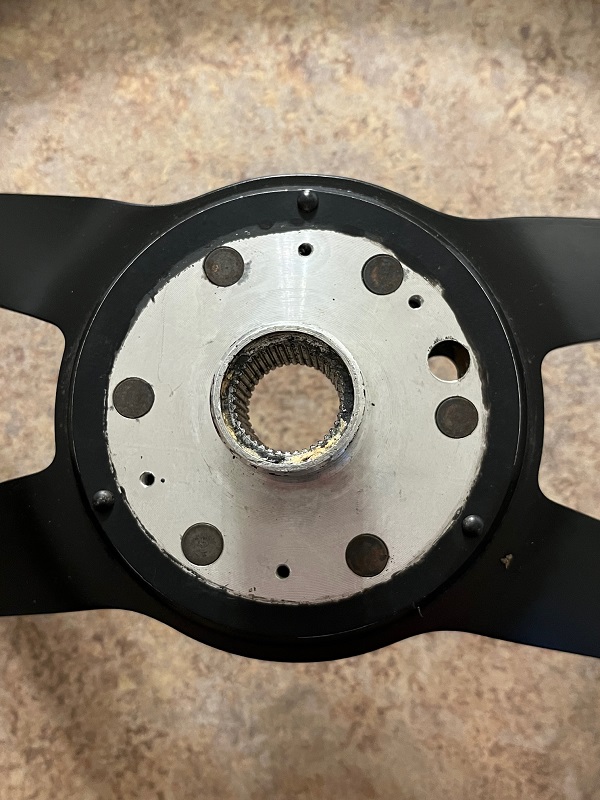

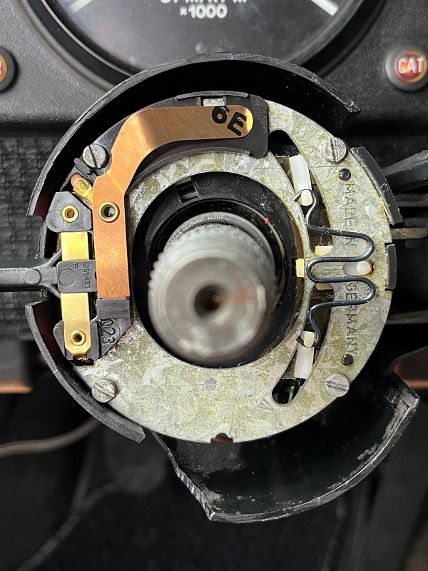

And the OEM wheel I picked up. Do I need to connect a ground to the spade connector? Am I missing something? I don't see where the stock wheel would make contact with the directional contacts to receive power. I am also missing 4 small screws that connects the back plastic hub to the wheel.
Attached Image Attached ImageAttached ImageAttached Image

Is the missing piece #4?

Seems like I answered my own question by looking at other used steering wheels on eBay. #4 on the steering wheel I bought had been removed, probably to sell separately.
I found one on Ebay and grabbed it.
