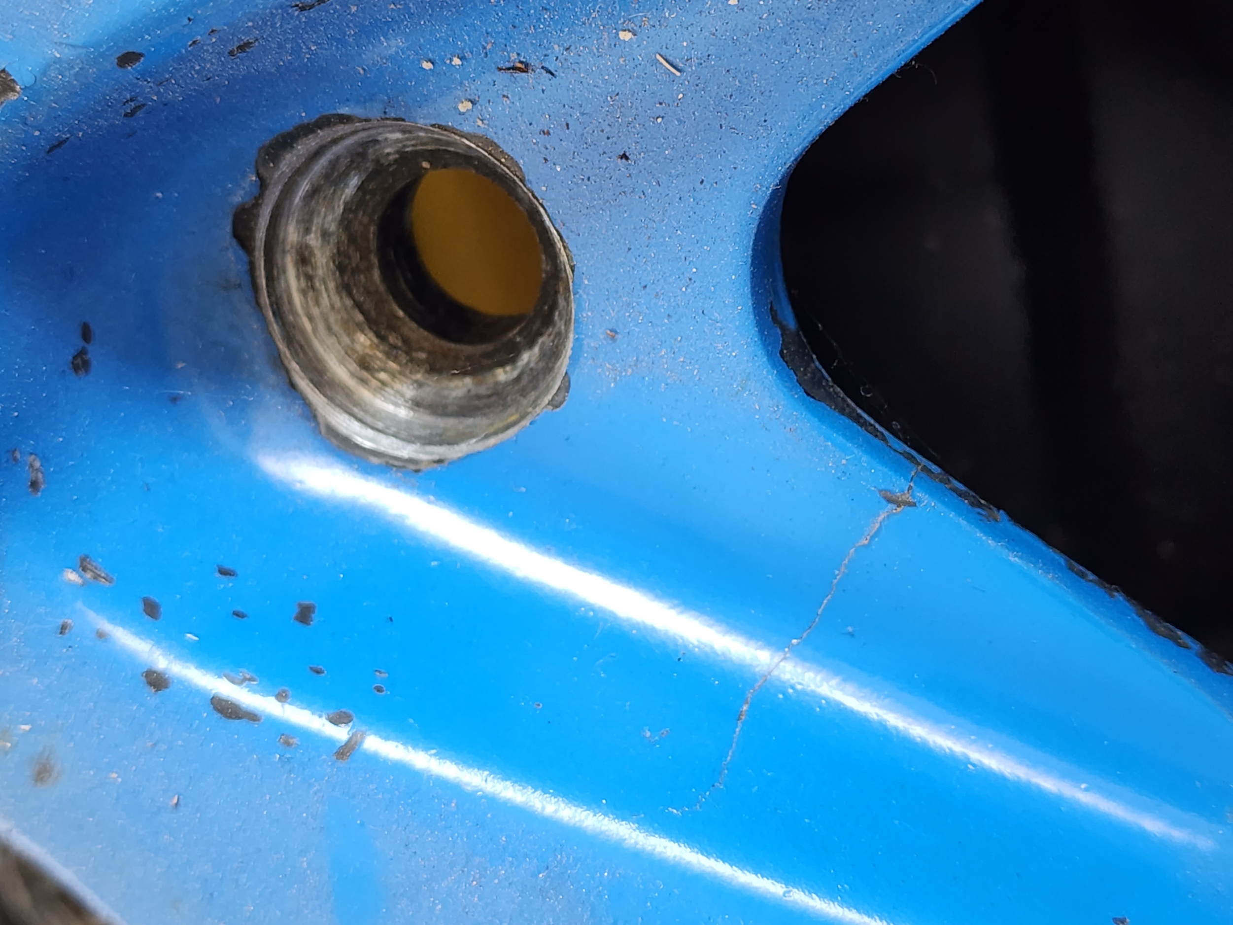

I've cracked 2 Fuchs on my 914 and it has not gone off roading. I have a good friend that cracked a Fuch on a street car years ago as well.
Matt Romanowski
post May 11 2023, 08:02 AM
Posts: 878
Joined: 4-January 04
From: Manchester, NH
Member No.: 1,507
Cracked wheel for reference.
