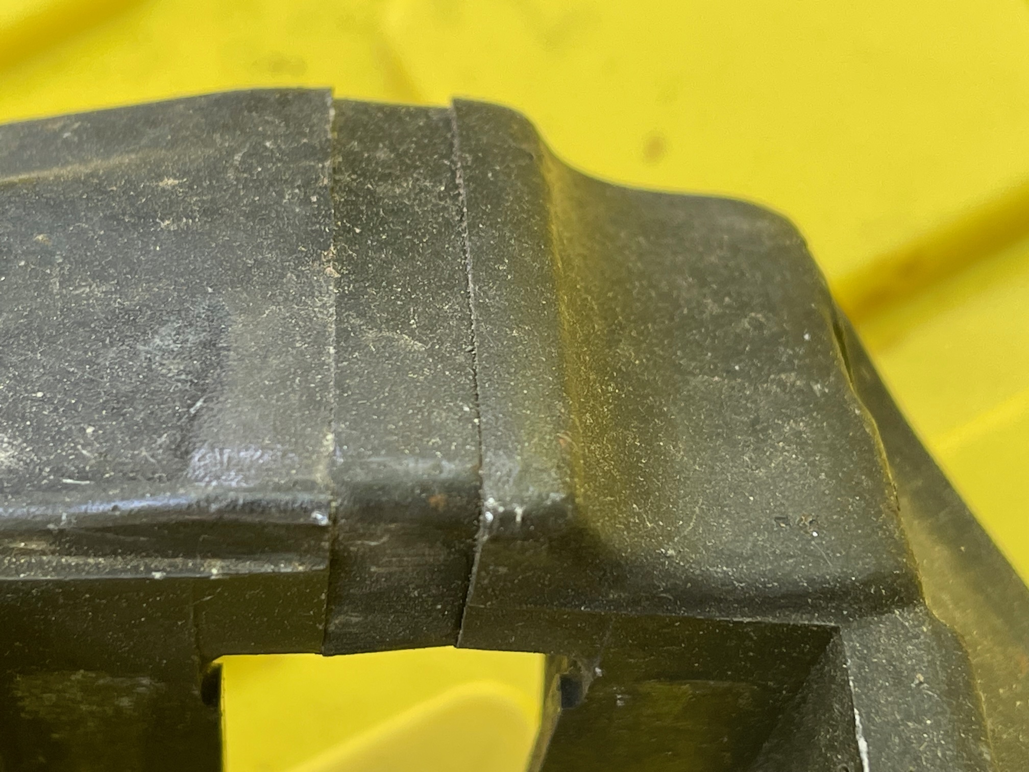

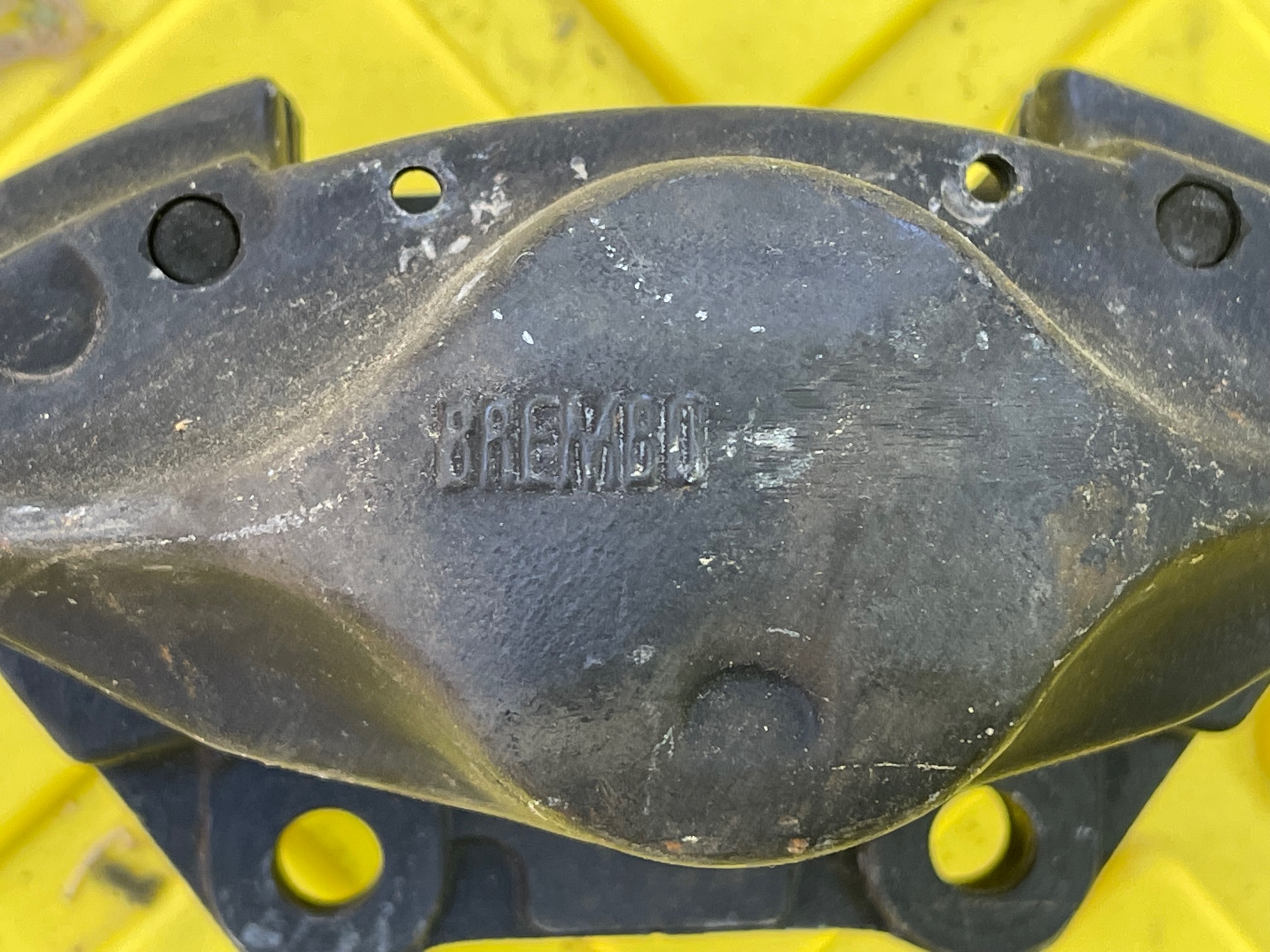

I managed to track down a couple pair of 3 inch caliper spacing Brembos.
I started to do some initial fitment validation and realized that one pair fits perfectly on a vented front disk 3 inch caliper spacing whereas the other fits the same 3 inch caliper spacing perfectly but has too narrow of an opening where the disc goes so it’ll only work on unvented brake rotors.
Any tips or coaching here on with the narrower pair will fit – is it simply a matter of needing an earlier non-vented from brake set up? In other words, one pair works fine with a 911 SC brake set up and I’m assuming the other pair should be fine with a non-vented 914 rotor?

Maybe Eric Shea will chime in. Spacers may have been removed to make it into a solid rotor application on narrow set. Pads are quite large and thick for these calipers.

I have stock early 911 solid rotors on my 5 lug conversion.
The 3" M calipers are the same left and right with a skinny spacer for solid rotors and a thicker spacer for vented rotors.
get another thin or fat spacer depending on which rotor you want.

I wasn’t as clear as I needed to be - the vented rotor is too wide for the opening on the caliper. Think the non-vented will be OK, will see if it clears a 914 rotor (as a proxy) and report back.

Either you have 2 different calipers or 2 different thickness rotors. Brembo calipers have never used spacers (like Ate calipers do). Start measuring and see what's wrong

Good morning - I do have two different pair, one pair that works fine with vented rotors and one pair where the caliper is too narrow for vented rotors.
Both have 3 inch bolt spacing.

I bought three pair of used Alfa/Brembo calipers that fit 911 struts. They all had spacers.

I replaced the original harware on on mine. They are just bolts. The caliper casting is threaded. Grade 10.9 or 12. I don't remember, but not hard to find

As a first step, contact the person you got the non-spacer pair from… ask him if he may have removed the spacers at some point and if he still has them and the bolts stashed away somewhere.
Btw, if I’m not mistaken, the non-spacer pair would only work with the early stock /4 struts and not the later ones.. someone correct me if that’s wrong.

I have 3 pair of the Alfa Brembo calipers and they all have spacers that measure approx 9mm thick.
If you are going 5 lug suspension you could run solid rotors from early 911/912 or you could run them on 914 solid rotors. 914 solid rotors are 10mm thick, 911/912 solid rotors are 12mm thick.
I previously ran 912 calipers on my 71 914-4 solid rotors and they worked good but I could over heat them.
Jim
