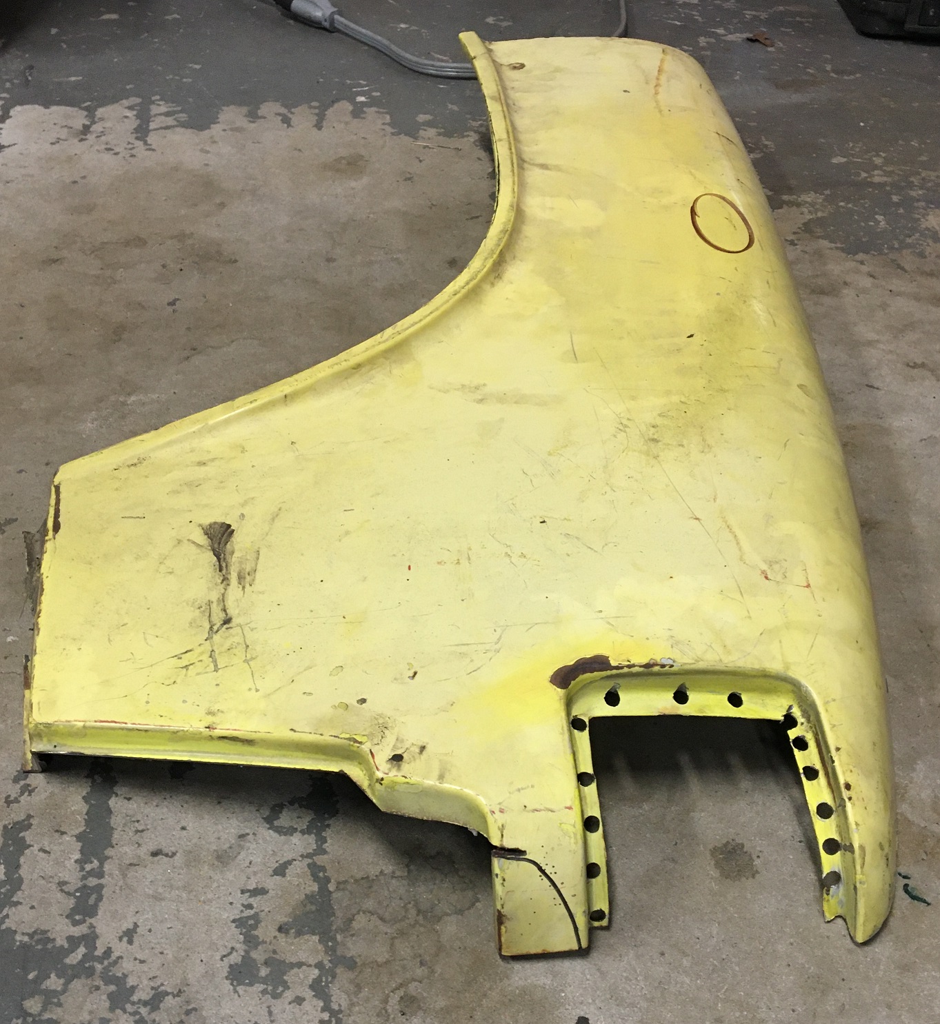

I have this... Very small dent sharpie circled.
Located in SoCal.

QUOTE(Montreal914 @ May 28 2023, 01:17 PM) *
Located in SoCal.
This looks promising. Do you know exactly where the cut was made along the top? How far from the gasket channel edge?

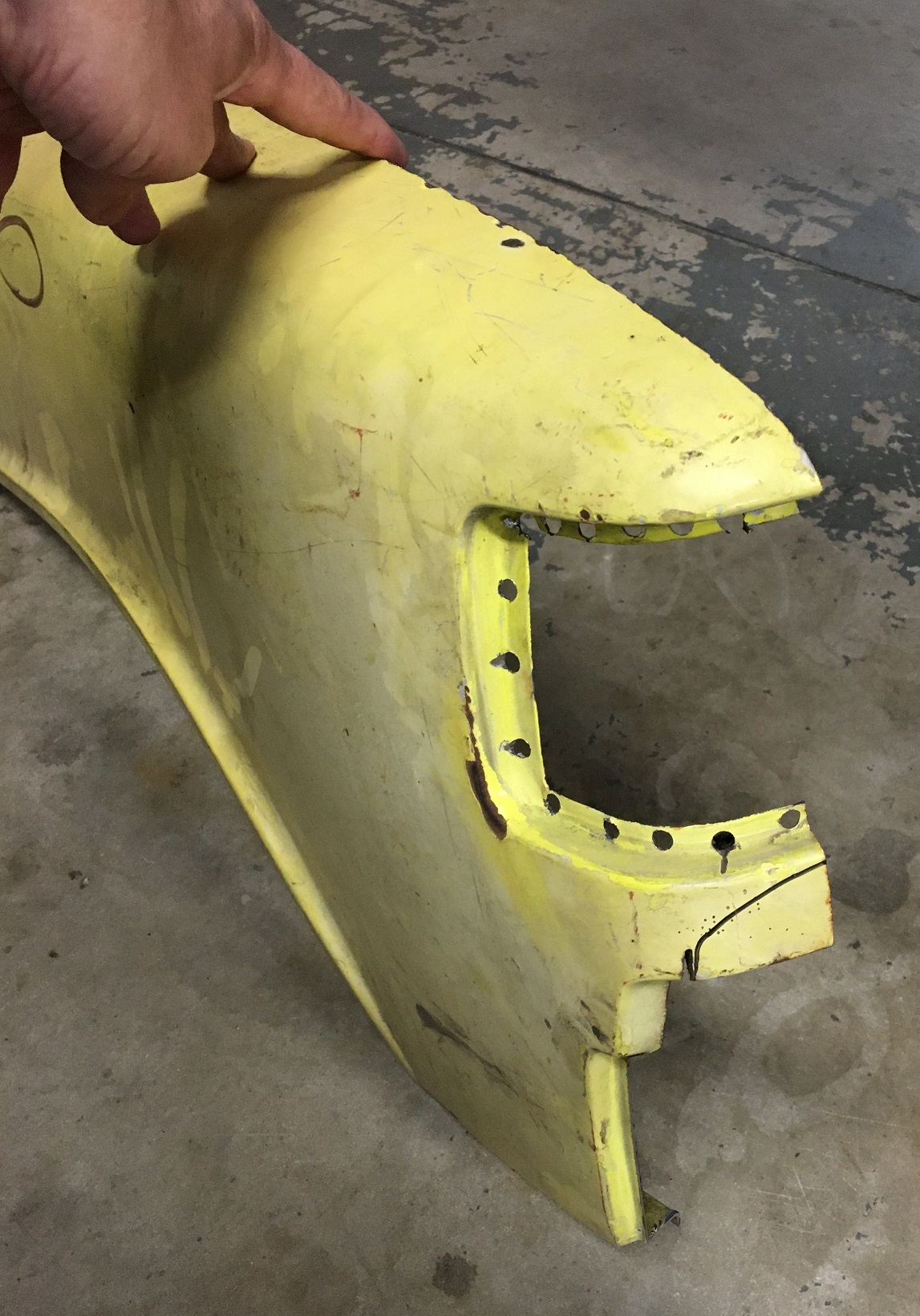

cgnj
post May 28 2023, 07:22 PM
Posts: 733
Joined: 6-March 03
From: Medford, NJ
Member No.: 403
@motreal914
How many drill bits and how long did it take?

QUOTE(zoomCat @ May 28 2023, 11:13 AM) *
Located in SoCal.
Using a thin disk on my 4" angle grinder, I cut along the vertical edge to use the gasket channel. My donor fender was missing it (IMG:style_emoticons/default/dry.gif).
Pretty detailed operation on my build thread, especially post #87.
http://www.914world.com/bbs2/index.php?s=&...t&p=3043001
The part is dirty in the picture but it is actually a good piece. I had a similar situation but elected to replace the whole fender. I am not a good welder and don't use TIG, so I wasn't pleased with the idea of having welds to deal with in bodywork.
Let me know if you have other questions. (IMG:style_emoticons/default/beerchug.gif)

QUOTE(cgnj @ May 28 2023, 06:23 PM) *
@motreal914
@cgnj
Well, I got the fender piece pretty much of that size. It had the gasket channel and the inner fender part spot welded to it, including the tailight area. So I probably had about 20 spot welds to drill in the gasket area, then the ones in the taillight area. The most difficult area is the tailing obviously. I also used a thin grinding disk on a Dremel. One drill bit was needed, but since then I have been using one of those end mill type 5/16" spot weld drill bit.
It takes a lot of time to do delicate work. I am not doing this for someone or for money, therefore I like to take my time and do it up to my satisfaction. (IMG:style_emoticons/default/biggrin.gif)
