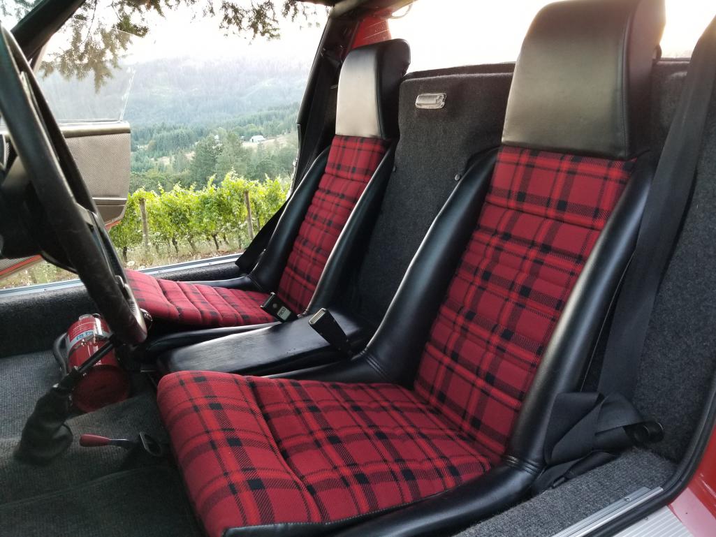

https://914rubber.com/thermal-formed-3-piece-back-pad-core-1
Matt used this on his carAttached Image
@Mikey914
Mark, do you all offer the 3 piece backpad with Perlon already installed like Matt’s car?
(Edit- Mark I see from another thread that you all are currently short staffed. No big deal on my question here.)
Thanks!
(Sorry for the hyjack)

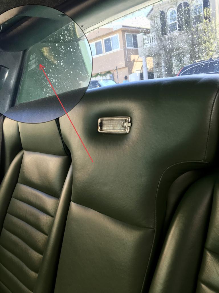

Good morning Rich, I did a dual glaze rear window on my 914 almost 30 years ago. Look at the picture below, the identification on the glass is mirrored or doubled.
In fact, right after I put in the 3.2 L motor I ran without a back window for almost a year. Rain does not get into the car when you’re going forward. Lol

Creative - I didn’t realize you can fit two layers of glass in there. How did you secure the second pane of glass?
Modern luxury cars often use thicker and sometimes laminated glass on side and rear windows as a way to reduce NVH. The lamination layer acts like constrained layer damping impeding sound transfer from one pane of glass to the other.
