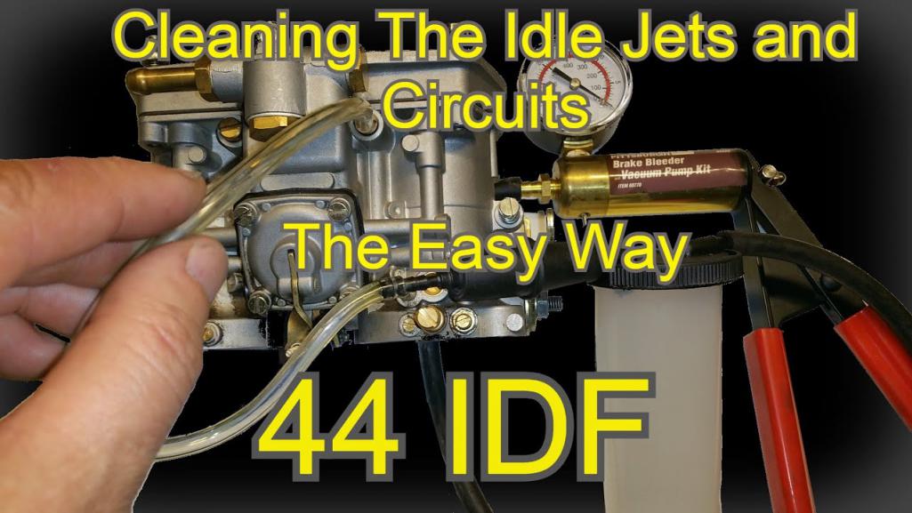

6) I cleaned all the jets with the carb in the car, ran and idled much better.

Once I installed the current conf above, new plugs, cleaned the idle jets, sync'd the carbs, it ran way better and smother. It wasn't cutting out at low rpms anymore and it was idling great. I could also start out in second gear now! After i purchased new plug wires, cap & rotor, I adjusted the valves. They were all ok, no adjustment necessary. But after all that and driving it for a while it will start popping. I pull the plugs and #4 is always fouled.

I'd pull the idles and clean them out for your drivability issue first.

@Superhawk996
Thanks for the tips. About the idle jets, are they where this picture has the vacuum hose? I'm not well versed in carbs but I did stay at a Holiday Inn Express sometime in my past.
