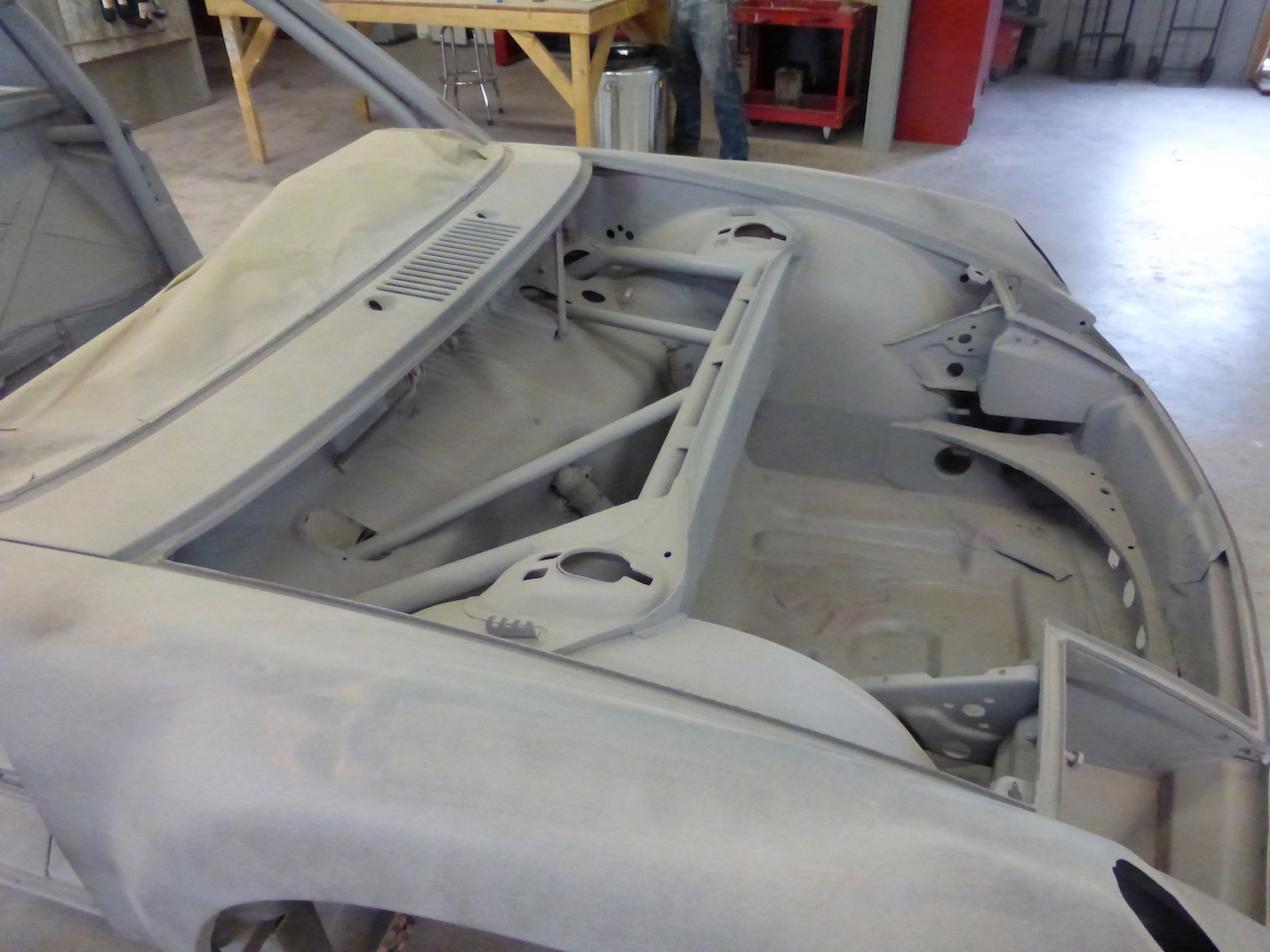

Bossboy 302, I had mine welded on 35 years ago. I believe to be original Porsche flares. The shop that did the install (stock car builder) just lined up the top to be flush with the fender and centered left to right on the wheels. To me it looks very correct, but Ben would have all that information. Best, MarkAttached Image
