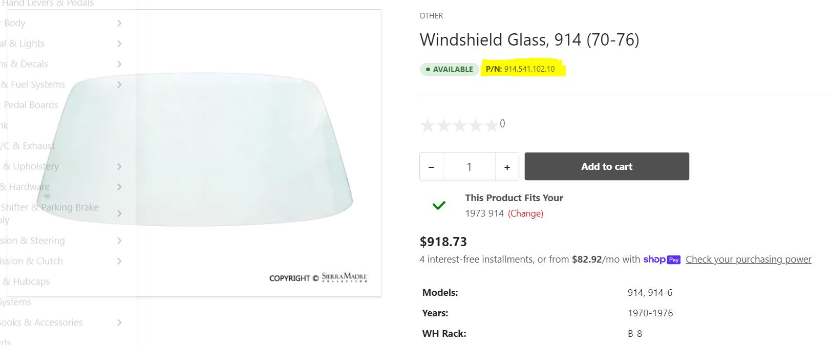

These OEM windscreens are available in clear or tinted per these two part numbers.
Clear: 914-541-101-10
Tinted: 914-541-102-10
By tinted, I am not sure if they mean with a dark shaded band at the top or overall tint like the side glass (Delodur-1 and Delodur-F, -1 clear and -F tinted).
If someone has this information, please comment. (IMG:style_emoticons/default/smilie_pokal.gif)

Here are the two cars from Rennsport with Pilkington windshield. All same number but probably a different production year, notice the variance in inscriptions.
EDIT: I think I have found my answer. Looks like the top colored band is too modern and was never offered on our cars. The tinted is for the whole glass per images taken from Sierra Madre Collection Website, both Genuine Porsche.
Clear 914-541-101-10:
And tinted 914-541-102-10

@Montreal914
in answer to your original question.
if you have 1F marked side glass then you originally would have had a tinted screen.
i am not 100% on this. but i think there was 3 ways you could order the glass.
a clear screen and clear side glass.
a tinted screen and clear side glass. (not sure about this one but some indications this may have been so)
a tinted screen and tinted side glass.
the original tinted screen did not have a band at the top.
the whole screen was simply a tinted darker color.
this was in fact done with the glass itself and not an interlayer.
the composition of the glass was altered producing a darker color.
that was what i was able to work out studying the manufacturing history.
sigla and kinonglas (st. gobain) had two different chemistries or recipes for that type of glass.
what you want from pilkington is their tinted glass version which will be homogenous all over.
pilkington is the correct screen to get.
