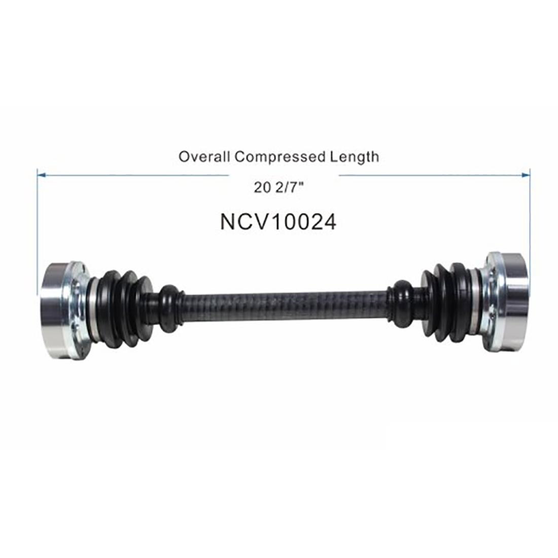

I saw this and I thought they might work for 108mm axle conversion. They are 6 bolt but I have no idea about the bolt pattern. Good for 400 hp for the GTO, probably more than enough for 914 conversion. Something you might want to play with. Same length as stock 914 axle 20.25".

Who is going to get one to see if the CV size may fit? Very low price if it works.

Of course, the axles showed up today! Cost $9 and was less than 24 hours to delivery!
Cheapest and NASTIEST axles I've ever bought. Looked like someone may have tried to install these and shipped them back.
Moly CV grease EVERYWHERE!
Still look meaty as hell!
10-1.5 mm mounting bolts.
No obvious locating steps. Looks like they use JUST the bolts for alignment purposes and torque delivery. I prefer stull that locks together or, at least, has alignment pins/dowels to reduce twisting forces on the mounting hardware.
I may call the 06 GTO I worked on back in to inspect the GTO flanges. Maybe these fit into a circular depression in the flanges.

Hi Bob, wish my yardstick could indicate that 2/7"inch fraction ¿¿ Mathematics from way back Ming Dynasty ? (IMG:style_emoticons/default/blink.gif)

2006 PONTIAC GTO 6.0L V8
GSP NCV10024 CV Axle
Wholesaler Closeout -- 30 Day Warranty $ 34.79 $ 0.00 1 $ 34.79
HERI 70462 CV Axle
Wholesaler Closeout -- 30 Day Warranty $ 19.05 $ 0.00 1 $ 19.05
Well, the CVs look to be 930 "knock offs". The axles bolt up to 108mm stubs and transmission side flange (get a couple roll pins for each side). Both look to be the same length from my quick and dirty measurements with a tape measure. The axel length looks to be around 20 4/14 inches (IMG:style_emoticons/default/smile.gif) .
You'll see that it's compared with a GNK/Lobro 911 axel that will use Patrick Motorsports adapters on the transmission side with a 5mm spacer on the hub side of the axel.
So, yeah they'll work and with care and maybe slightly less HP, who knows how long they'll last? But, what do you care for a $19 or a $34 axel. I mean really, getting two 930 style CVS for $19 and a correct length axel and the boots.
We will still be putting the GNK/Lobro axel on when the 911 e-brake and modified swing arms go on, but these will at least be spares.
Thank you @914sixer for finding these and sharing! And others for finding the low cost ones! Can not believe $19 for an axel and only $16 for shipping both!
