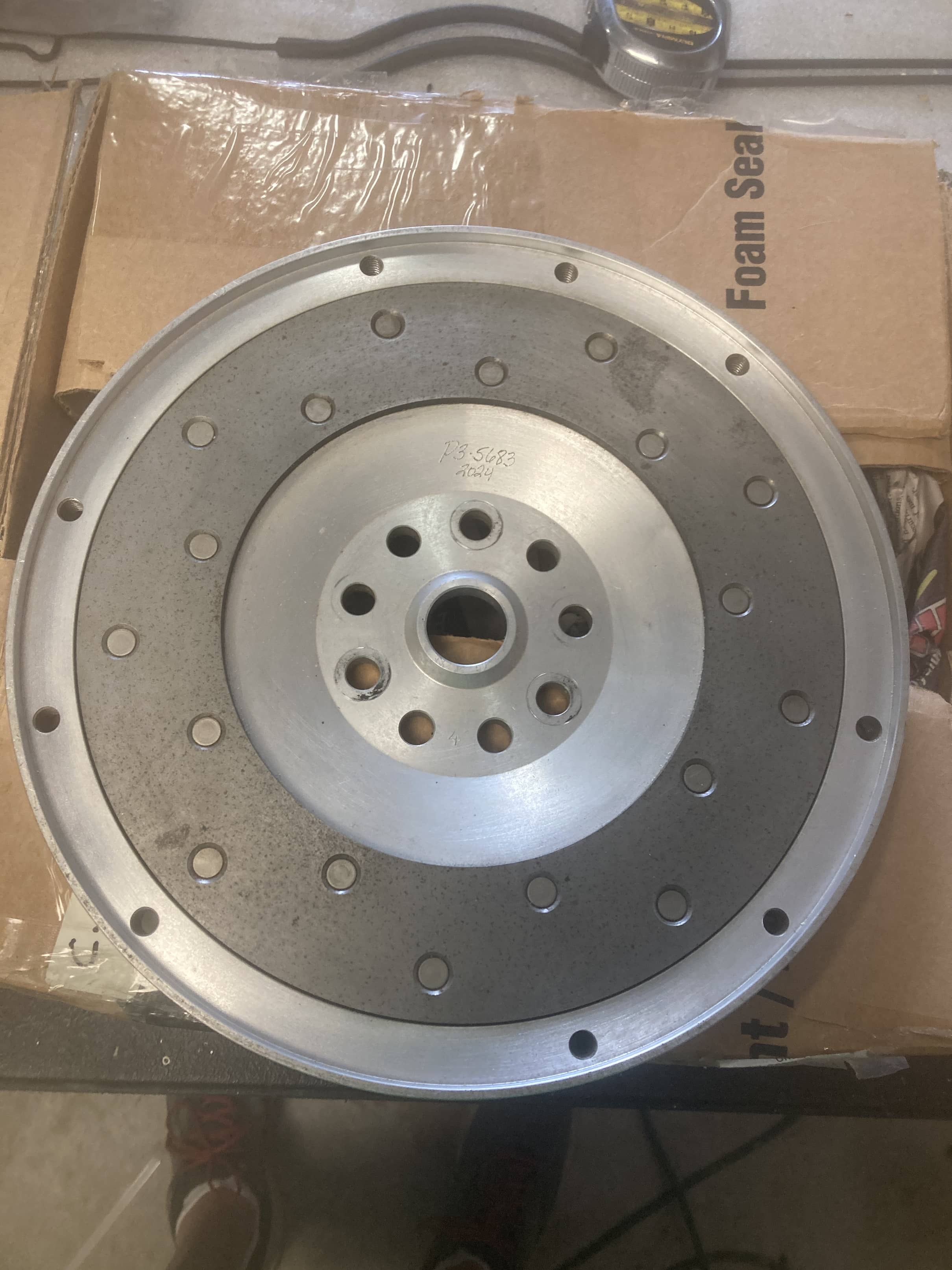

Posting pics since it looks so much different than what has been posted.
Any idea what this is worth ……based on street useage probably going to sell.
Thanks again

According to PO came from John Truman Motorsports

QUOTE(sixaddict @ Mar 23 2024, 11:27 AM) *
Chris et Al……
Appreciate input.
Thanks again
Interesting. I have no idea on value, especially not knowing if it also requires matching / dedicated pressure plate, disc, TO brg and starter ring gear... but interesting nonetheless...

I've seen a crap ton of multipiece flywheels...
Never seen a RIVETED wear surface.
That's one of the reasons for multipiece, you can replace the wear surface.
Also never seen one without a ring gear on it.
Value ?????

Is it an aluminum flywheel? Fidanza makes ones that look like that.
1970 and later 911 flywheels have the separate ring gear, so this looks like one of those.
Looks like the AASCO unit that I've been running on the 2.7/6 and it's just fine for street or track--has separate ring gear, I use the "sport" Sachs pressure plate. Flywheel retails around $600....
