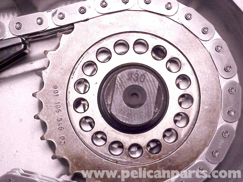

Ok so I will echo wrong cam timing. A friend bought an engine a few years back from a reputable shop. Got the car running but ran terrible for a year chasing everything. Really not safe to even drive once he got it running. Turned out cam timing. It is very easy to time one cam 180 out. That is where my money is.

Remember 911 cam timing is set via index pin that has a multitude of possible “wrong” positions.
Doesn’t have to be out 180.
It sounds like there are still plenty of other assumptions that need to be verified and hopefully it isn’t cam timing.Attached Image
