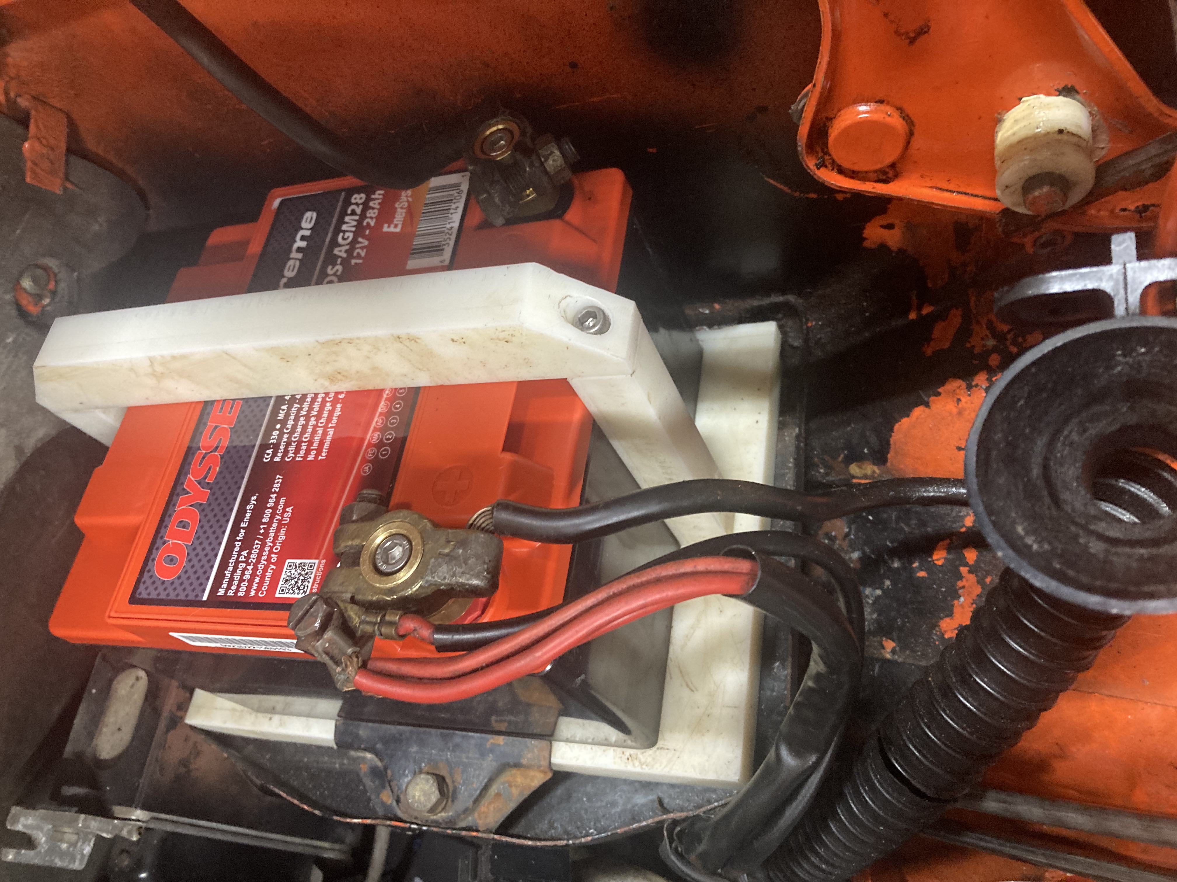

Don’t know the exact weight but way less than 40# (est. 15#). Spins the engine well, been in service 15 months. 330 CCA, 28AHAttached Image .
