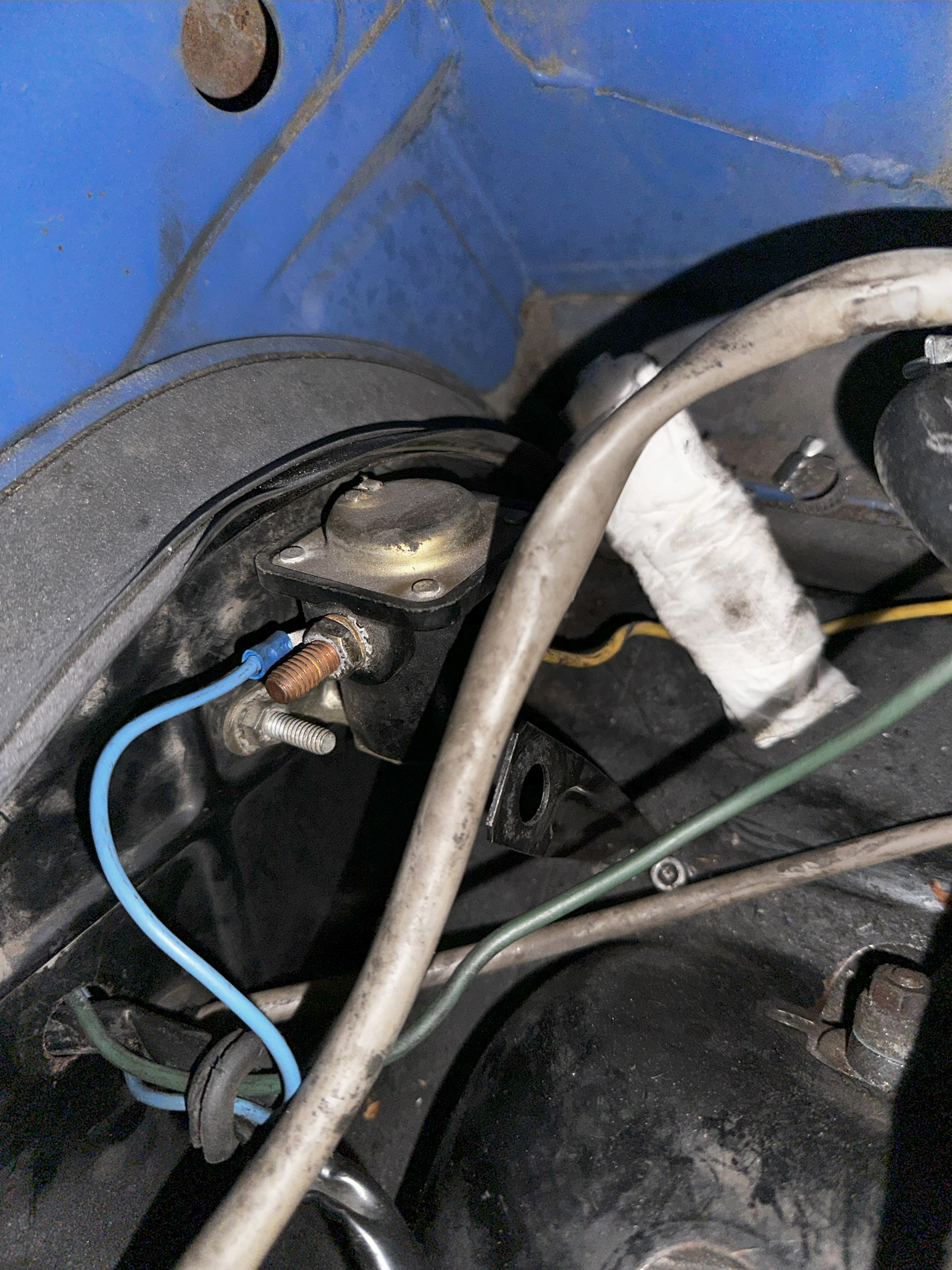

Thank you for the advice everyone, hopefully I'll get a chance to dig into it today. In regards to the little box on the firewall, I'm attaching a pic for reference.. Attached Image

Superhawk996
post Jun 5 2024, 10:09 AM
Posts: 8,000
Joined: 25-August 18
From: Woods of N. Idaho
Member No.: 22,428
QUOTE(sjhenry1075 @ Jun 5 2024, 11:17 AM) *
Yup - DAPO’s been there so I guess you weren’t joking when you said wiring has been molested.
The presence of this added solenoid was meant to solve intermittent hot start issues 914s are notorious for. Based on the way this one was done and the size of the wiring, it is a sign that it was done poorly. The OEM Bosch solenoid draws about 24 amps. The wiring from that solenoid is too small to be of much use.
Here’s how to do it properly
http://www.914world.com/bbs2/index.php?sho...p;mode=threaded
Be advised: added hot start solenoids are a Band-Aid that usually temporarily mask other underlying issues such as:
Failing ignition switch, large voltage drops in the OEM yellow stater wire due to age & corrosion, failing and/or missing ground strap between engine and transmission, failing battery cables (either + or neg.).
If it were me, I’d take it out and fix the underlying issues while you are in the process of cleaning up and sorting out your other fuel pump issues.
