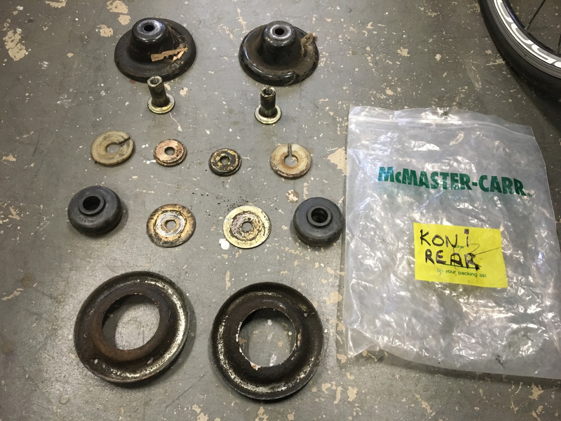

Montreal914
post Jul 4 2024, 03:37 PM
Posts: 2,203
Joined: 8-August 10
From: Claremont, CA
Member No.: 12,023
QUOTE(bkrantz @ Jul 3 2024, 07:25 PM) *
The need for some of those parts depends on your choice of shock make and model.
^^^ Agreed, this extra hadware I have from a Koni setup differs from my Bilstein setup.
If any of this can be of interest if Bruce doesn't have you covered, let me know. (IMG:style_emoticons/default/smile.gif)
Large file picture for you to zoom in.
bdstone914
post Jul 4 2024, 10:07 PM
bdstone914
Posts: 5,393
Joined: 8-November 03
From: Riverside CA
Member No.: 1,319
QUOTE(Montreal914 @ Jul 4 2024, 02:37 PM) *
You are missing #13 washers.
It is going to be a couple weeks til i have the parts plated and ready. I only have two complete sets and want two keep one. It seems @dennisv may have some of the parts.
I think the only parts that may be different are the long nuts that go thru the rubber grometts at the top.
I think it was only the early Koni that were a different pitch. I remember trying to chase one down to have enough parts to build a set of shocks.

Montreal914
post Jul 9 2024, 08:11 AM
Posts: 2,203
Joined: 8-August 10
From: Claremont, CA
Member No.: 12,023
@DennisV : I will gladly measure them tonight but it would help if someone could identify #5 for me in my picture.
As for #9, I would think they are the larger ones located in between the rubber ones in my picture.

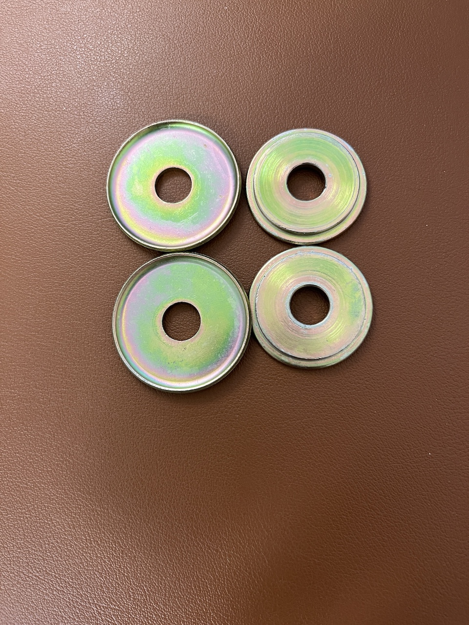

914Sixer
post Jul 9 2024, 06:34 PM
Posts: 9,579
Joined: 17-January 05
From: San Angelo Texas
Member No.: 3,457
From replated stash
Montreal914
post Jul 10 2024, 02:03 PM
Posts: 2,203
Joined: 8-August 10
From: Claremont, CA
Member No.: 12,023
@DennisV
Here is what I measure for #9 (the ones showing in between the rubber stopper in my picture (a few post above).
As for washer #5, I am not sure which one it is (IMG:style_emoticons/default/sad.gif) ...maybe the plastic split ones? (IMG:style_emoticons/default/confused24.gif)
