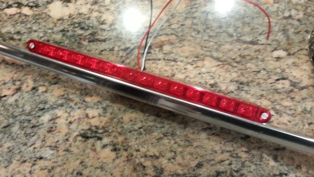

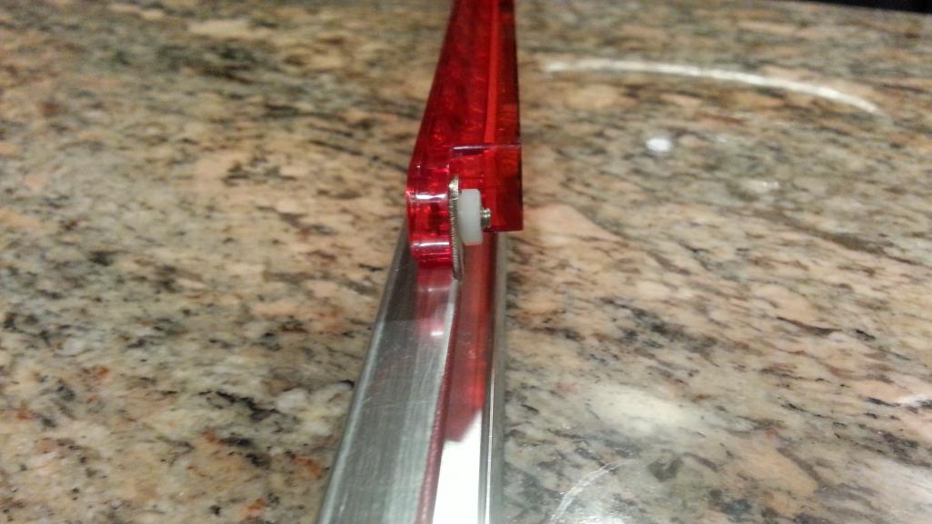

Ok, if this isn't what you're looking for @Literati914 , I apologize. My light mounts behind the trim and is pretty low profile, IMO. I fashioned two brackets to hold my LED brake light that I purchased off Amazon. I drilled two holes and used two pop rivets to secure the brackets and then attached/wired-in the light. I then relieved the chrome piece to clear the brackets (minor adjustment). Finally, I "sistered" in the hot wire to the driver side tail light and, of course, grounded the other.

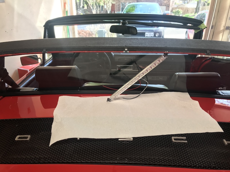

As noted in a prior thread, I used an L piece of 1.5” aluminum roof edge flashing, painted to match car and secured vinyl magnets on the outside of the L and mounted a thin LED strip (AutoZone) to the other outside edge. Whole thing just mounts under the trim and comes off as/if (never yet) needed.
No drilling or extra trim.

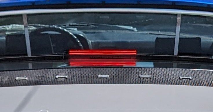

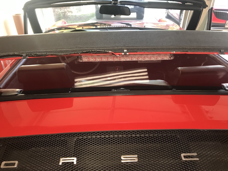

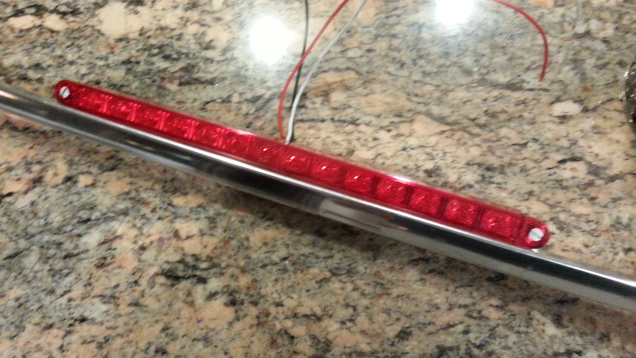

Got this one from Jegs. They come in 6, 9, 12 inch. This is 9 inch. Mounted it on the chrome trim so it hangs below the trim. Can't see it in the mirror because of the roll hoop padding.

QUOTE(Spoke @ Jul 8 2024, 07:42 PM) *
@Spoke - That looks a lot like mine but I think I like your solution even better. Nice job! (IMG:style_emoticons/default/smilie_pokal.gif)

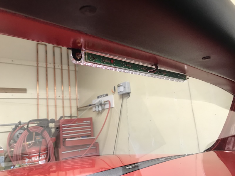

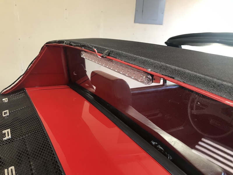

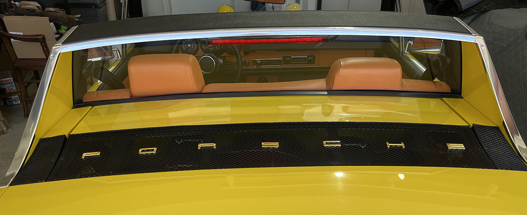

Thanks. Here's the entire installation of the 3rd brake light. Just realized I had the 12 inch light and I got it through Summit. I grabbed brake power from the rear light assembly with a Y-spade so I didn't have to cut/splice any wires.

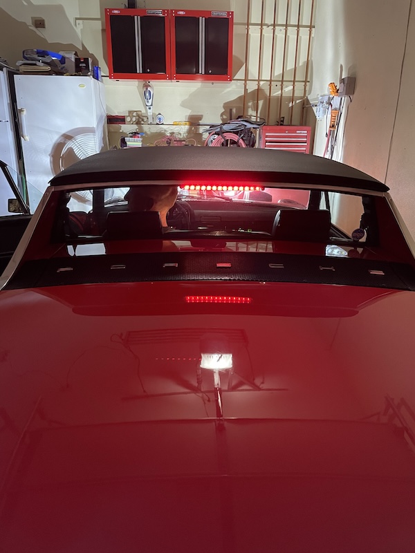

20 dollars at Walmart. Self adhesive. Not exactly pebble beach but very effective and invisible from inside. No damage to the car.
I don't think this is the solution you are looking for though...

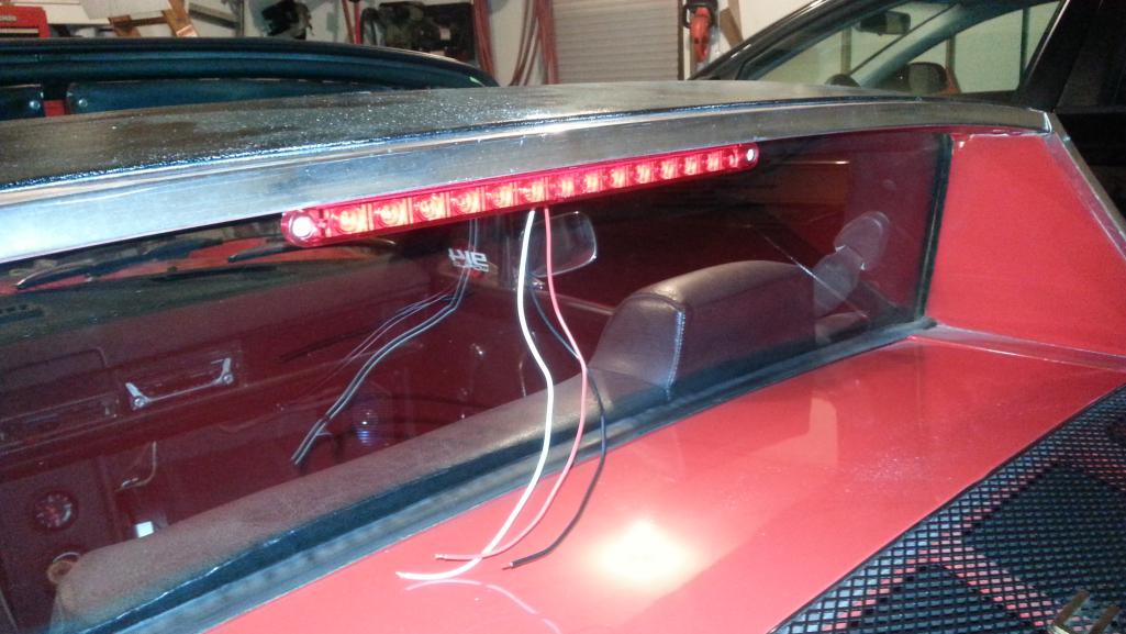

The one that PMB decided was what I wanted on my 6. I do not know what brand it is but you will notice the black plastic covers for the ends. A very clean set up.

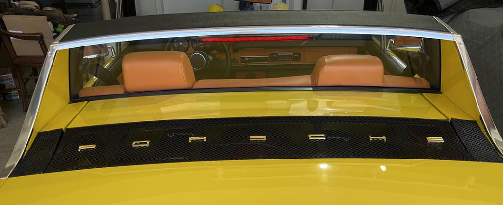

I never did get around to doing the upper rear targa trim modification that I planned for HOWARD. I did the '86 Corvette convertible brake light on the engine lid grille on the 'BB'.
I have a nice spare upper rear trim piece if anyone's interested in it (IMG:style_emoticons/default/confused24.gif)
http://www.914world.com/bbs2/index.php?sho...=367873&hl=
Also have some nice lower sail trim pieces available ...
http://www.914world.com/bbs2/index.php?sho...=367896&hl=
