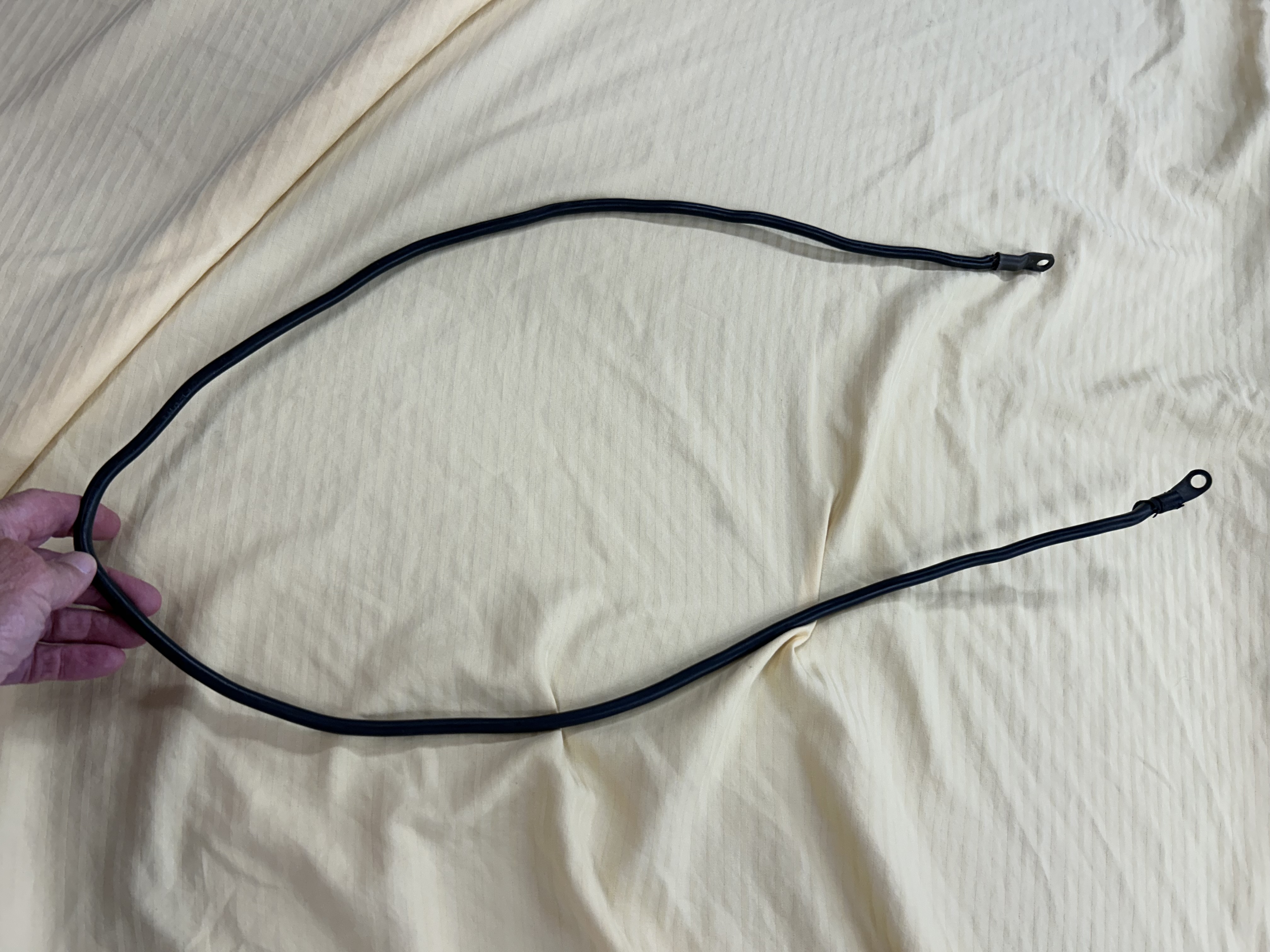

Battery to starter cable length is 56 inches.
jim_hoyland
post Jul 9 2024, 07:12 PM
Get that VIN ?
Posts: 10,129
Joined: 1-May 03
From: Sunset Beach, CA
Member No.: 643
Yup, 56”
It’s yours if you want it.
