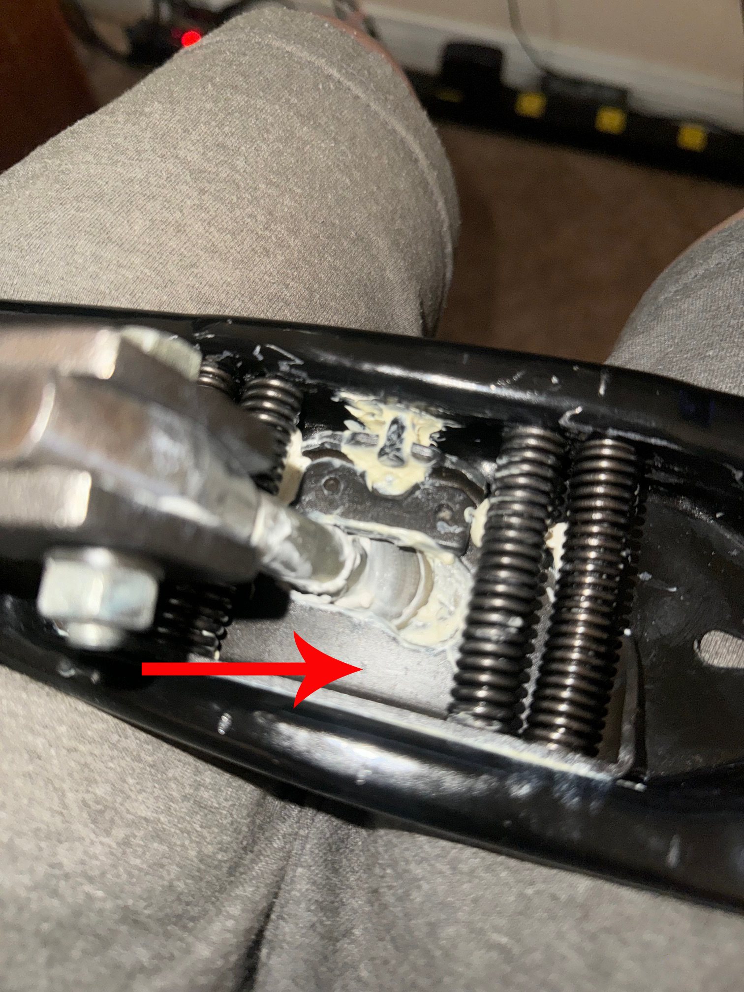

Thanks for the prompt reply, I will take some photos but for now I have only one spring either side of the lever, so it's not quite the same and it's certainly not pushing up into the cup, the plastic bush (upper) will not go high enough to push lever all the way up?!
I modified my shifter, but it spent 50 years as a factory side shifter. Is the ball right up against the sheet metal cup? Nothing in the way but maybe some grease? All three of these pieces go underneath the ball

I have that spring arrangment you show and no the ball does not sit tight up against the cup, there's maybe nearly a quarter inch gap. It seems that the plastic bush doesn't want to go all the way up to support the ball?!
