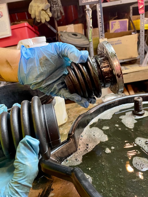

Have any of you separated the rubber boot from this collar piece? This is the CV joint boot, and I want to replace it, but I don't want to damage getting it off. It looks to be crimped on, and I did find this : http://www.914world.com/bbs2/index.php?showtopic=366077
But it seems to be about 914-6s, not the 4s

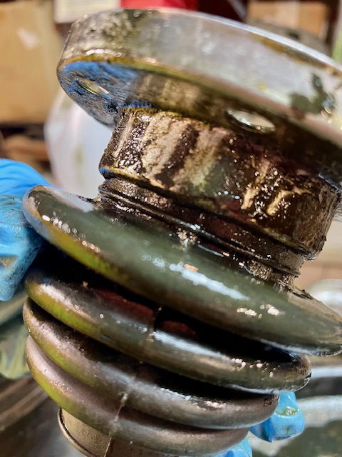

pic 2

this is the lip

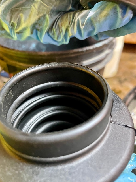

pic 3

This is all in comparison to the new boot I have btw
bdstone914
post Aug 17 2024, 05:30 AM
bdstone914
Posts: 5,031
Joined: 8-November 03
From: Riverside CA
Member No.: 1,319
I dont think the boots you have will fit the flanges with crimped on boots. Are the old boots cracked or ripped? I nay have some extra flanges. They may sell new flanges that will work with those boots.
technicalninja
post Aug 17 2024, 11:35 AM
Posts: 2,531
Joined: 31-January 23
From: Granbury Texas
Member No.: 27,135
I bought boots with the flanges already installed.
