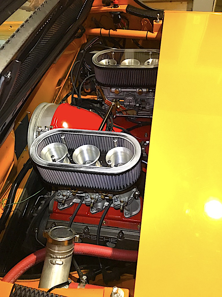

Same as 930cabman, running 40 PMO's on my 2.2 for five years with only one fuel line. Runs great. Best, MarkAttached Image

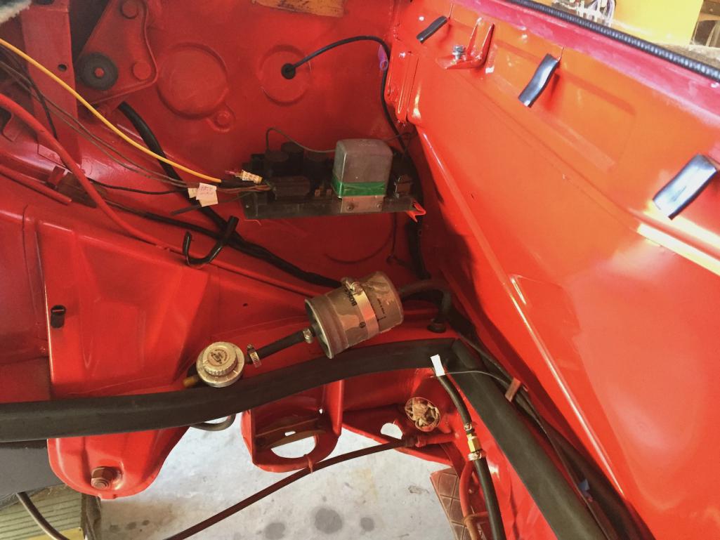

Here is my Carbed return line using the original EFI supply and return lines as well as the original pump and filter.Attached Image
