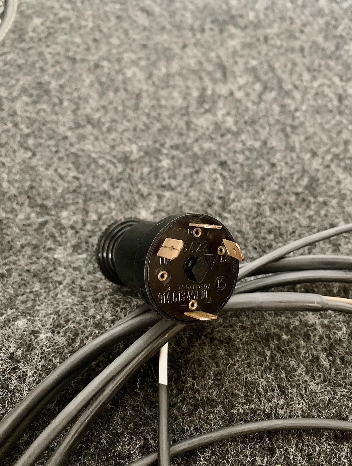

I made these up using 911 fog light switches. Pull out for the fronts and then twist to the right for the rear. 914 fog light knobs and escutcheon added for the conversion.

Those are nice. Clean way to pick up the back fog too. Very cool (IMG:style_emoticons/default/smile.gif)

That is cool! I did one green and one yellow in the silver car foe the two sets in the front. This would have been cleaner

Do you know the part # for the 911 switch you used?

There’s actually an original 914 switch for this application….part number #914.613.451.10. I used this switch along with an original wiring harness to operate the rear fog on my ‘74 2.0L.

Part number 911 613 147 00. 914 switch is NLA
