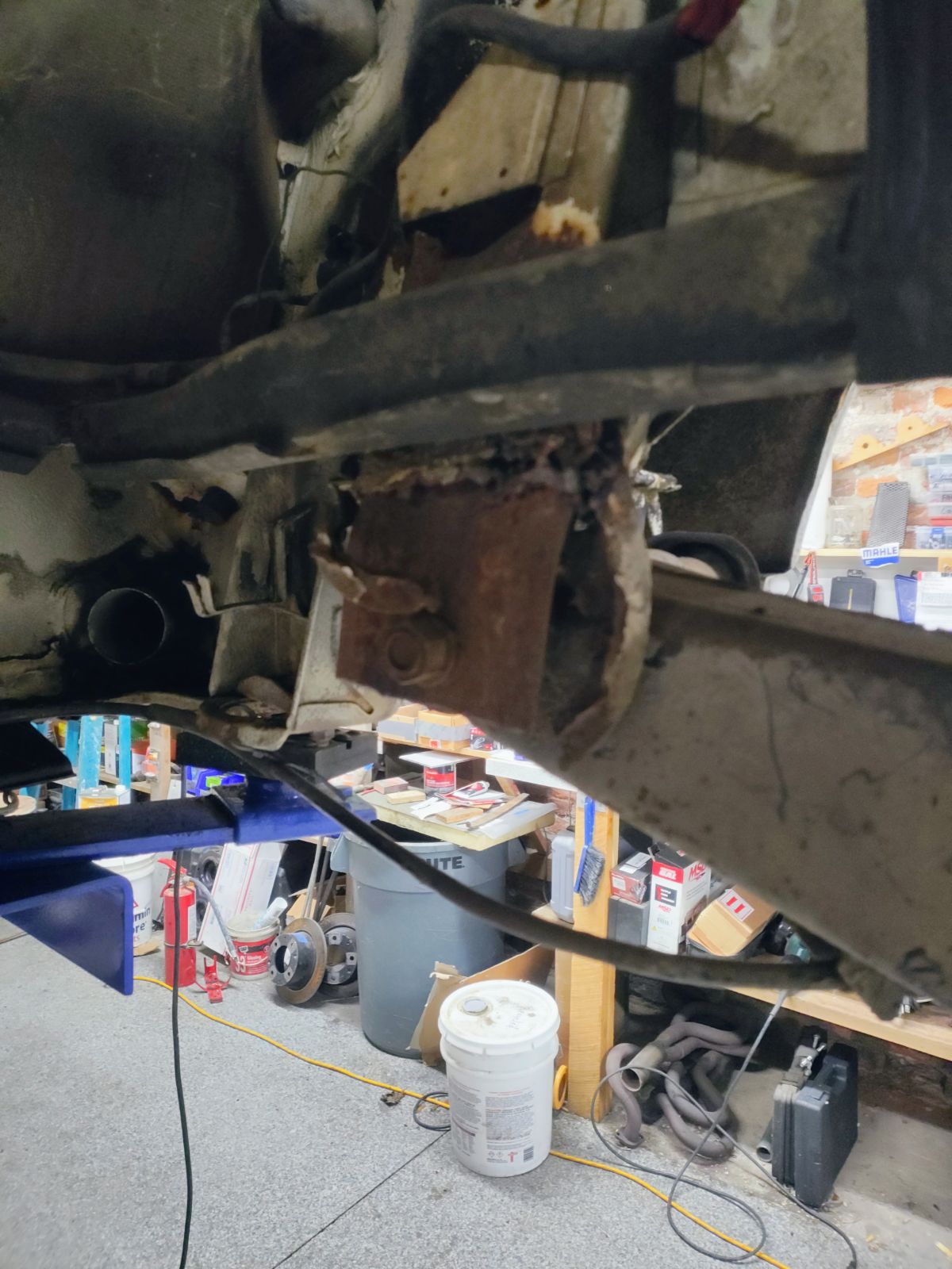

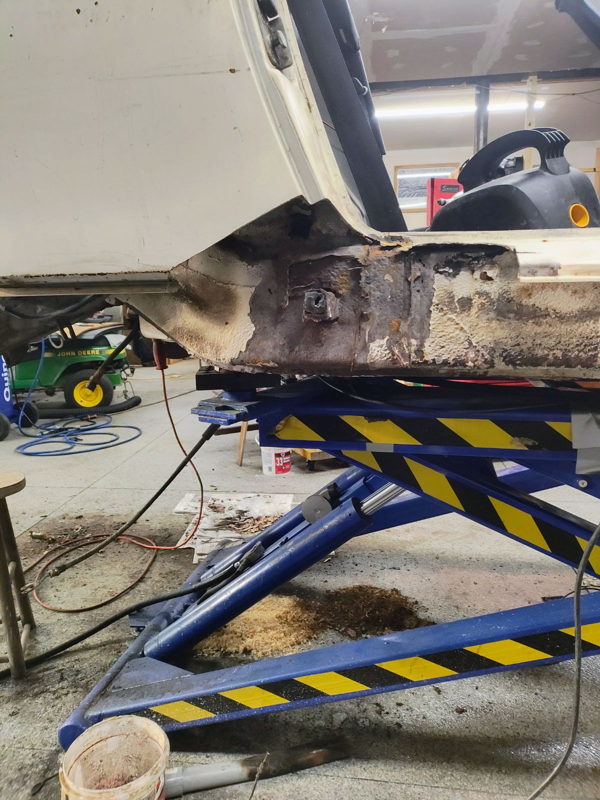

Don't ask, but project #4 is underway. a decent 1974 model without mountains of rust. More pics to follow, but I discovered this yesterday
Attached ImageAttached Image
and this
So goes it. The floors are very good (appear to be), the longs need some small patches including the jack posts,.......

That's an interesting fix on the trailing arm mount.
(IMG:style_emoticons/default/blink.gif)
930cabman
post Oct 30 2024, 04:51 PM
Posts: 4,885
Joined: 12-November 20
From: Buffalo
Member No.: 24,877
QUOTE(Root_Werks @ Oct 30 2024, 04:33 PM) *
I don't know how some mechanics sleep at night. This "repair" could never have worked properly (IMG:style_emoticons/default/sad.gif)

What is that blue stuff up on top of the suspension console. Looks like RTV??

Lets be honest, Poor914 has been hit hard in the Rear...

QUOTE(gereed75 @ Oct 30 2024, 05:56 PM) *
The rearmost portion of the drivers side quarter panel was replaced with a resulting poor lap weld complete with pop rivets as part of the "repair". The blue is the paint color of the repair panel.
This beauty also needs a new trunk floor, I am thinking to open it up and maybe get a good look, also remove the patched in quarter panel and make the proper connections.
I was hoping this was going to be a simple fix (IMG:style_emoticons/default/lol-2.gif) (IMG:style_emoticons/default/lol-2.gif)

Seen that one before. Best remove the botched outer panel and start with repairing the structural part of the car. You can do it. (IMG:style_emoticons/default/sawzall-smiley.gif) (IMG:style_emoticons/default/smash.gif) (IMG:style_emoticons/default/welder.gif)

QUOTE(sixnotfour @ Oct 30 2024, 06:08 PM) *
Bondo over 3/8" thick at the lap joint. Not exactly how to proceed, there is also a bunch of brazing, pop rivets, general DAPR (IMG:style_emoticons/default/screwy.gif)

Post pics of the rest of the car.
From what you’ve shown thus far, it’s looking an awful lot like a parts car.
I wouldn’t do anything else to it without making some measurements of the tub.

QUOTE(930cabman @ Oct 30 2024, 11:03 AM) *
I think the only reason you don't see mountains of rust is because they blew away in the wind! That control arm mount has evaporated!
Media blast the chassis and get back to us (IMG:style_emoticons/default/biggrin.gif)

we have seen worse
Superhawk996
post Nov 3 2024, 12:05 PM
Posts: 8,184
Joined: 25-August 18
From: Woods of N. Idaho
Member No.: 22,428
Yeah - sketchy but it isn’t terrible for an east coast car. Worse have been saved . . . At a cost.
Measure the tub carefully before you invest lots of time or $ into this chassis. I can’t imagine it having been hit that hard and not needing a pull on a frame rig to square it back up.
