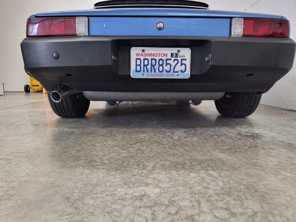

2.7 CIS with 993 cams, 46/40 valves, 911S 8.5:1 CIS Pistons with Nikasil cylinders. Guessing it produces slightly more than stock 2.7S HP and has a much lower, broader TQ curve.
Current exhaust is stock 914-6 HE's and one of Ben's SS Quiet mufflers. Been very happy with the exhaust note the past few years, but always wondered if stock would be quieter.
Ben's Quiet Muffler ( I did have to reclock the tip as it was more for 1974-up 911):

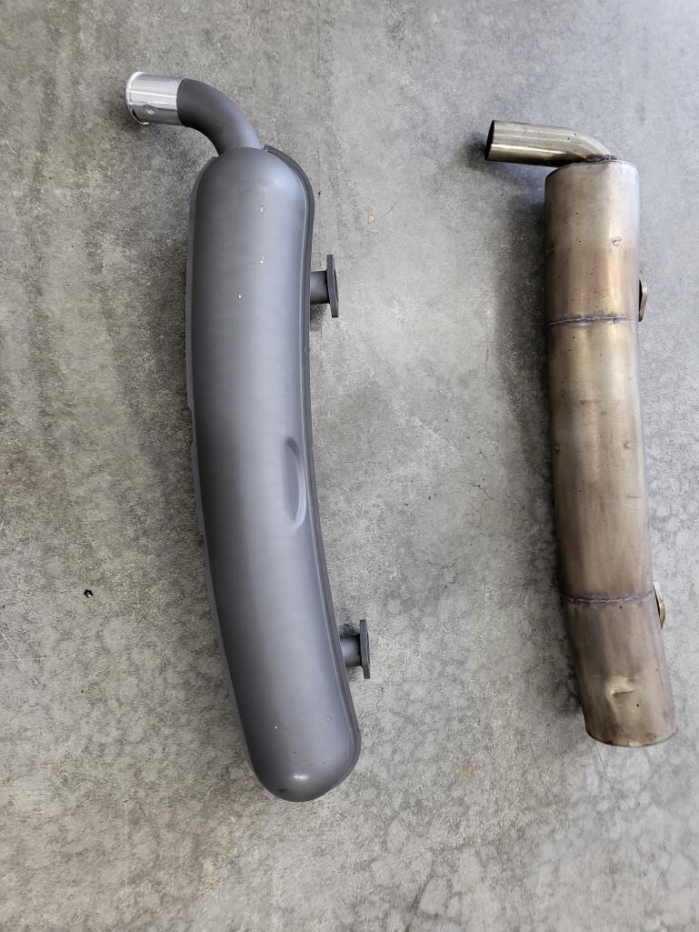

Pulled the SS muffler and prepped to install the new Dansk muffler I've been sitting on for 10 months:

Ran the same tests as close as I could, same stretches of road and highway, windows up, same gears etc.
Dansk muffler results:
Idle outside - 80
Idle inside - 67
30mph - 77 4th gear
60mph - 85 5th gear
70mph - 87 5th gear
As the DB goes, not much of a difference by the numbers. Although I could tell on the freeway the note was toned down a bit.
Was it worth it? Eh, probably not. Not really much of a difference in overall cabin noise and I gained back that 5-6lbs right on the tail of the 914 (Dansk is heavier than SS).
Not sure if I'll swap back to the SS or not. I do like how the Dansk is hidden a little better.

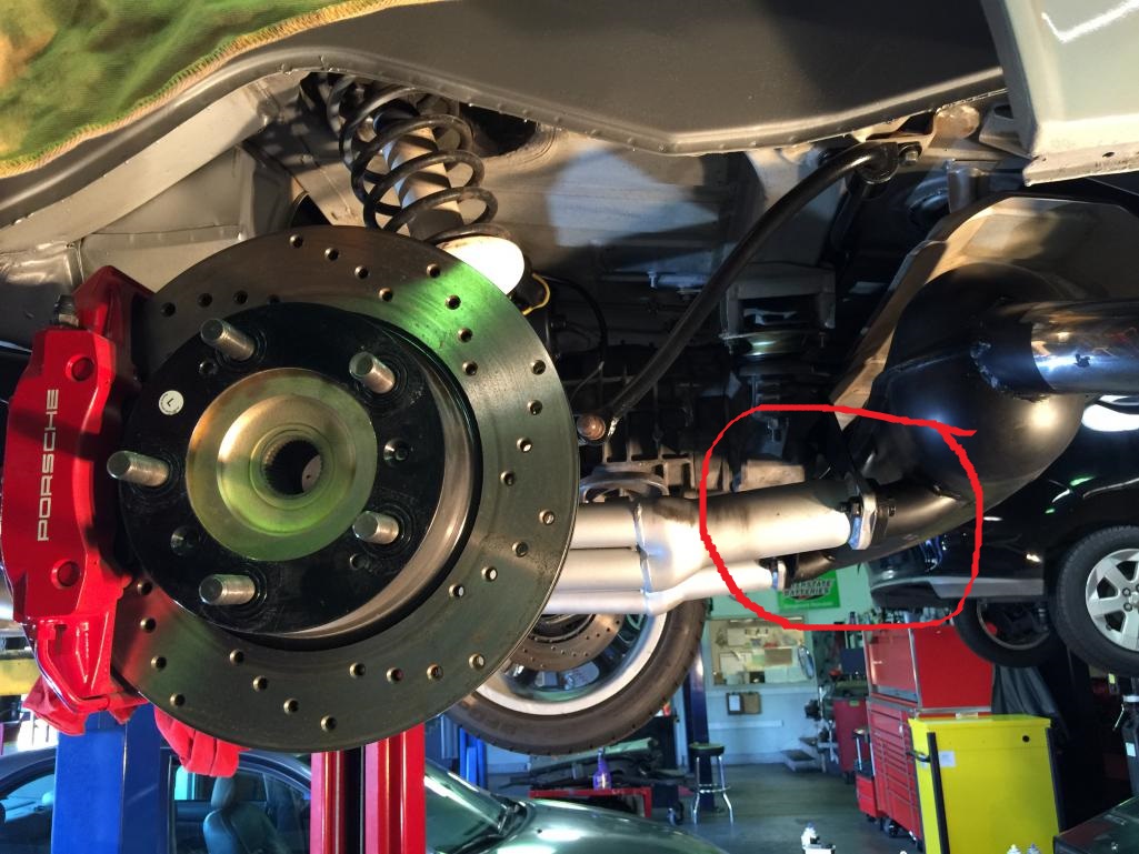

@Root_Werks , when you say Bursh, do you mean Dansk? Also, is this a stock Dansk or the sport one?
I have been thinking about what muffler to use with my 3.2 that will be equipped with Ben's beautiful SS heat exchangers/headers. (IMG:style_emoticons/default/drooley.gif)
I am looking for a single output and quiet.
Seems like the stock /6 muffler might be restrictive for the 3.2. Maybe not the best example but this /6 conversion in the classifieds has quite a step from the headers collector tubes to the inlet of the stock /6 banana mufler. I would assume this creating some restriction... (IMG:style_emoticons/default/confused24.gif)
I do have the SS 1-in 1-out from the 3.2 original exhaust system and have been wondering if it could be converted to a 2 in 1 out somehow. I would appreciate if you could post a link of that modification.
