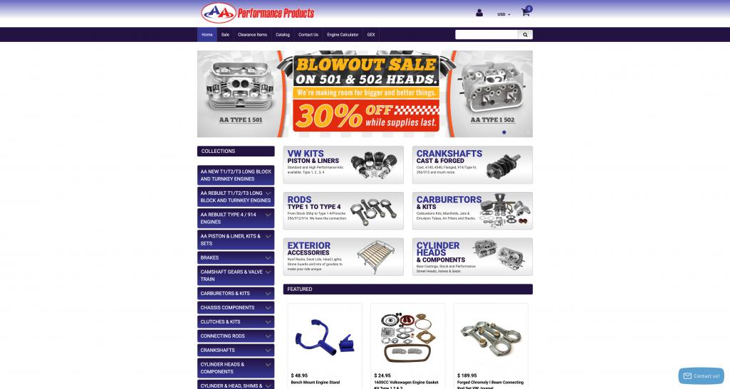

Here is where a lot of people shop. Pretty much everything you need.

Thank you for sharing AA parts, no doubt another source of parts. I am curious about ecperience with the new Empi Type 4 cylinder heads. Also a USA source for, Cima/Mahle cylinders. Steve V.
