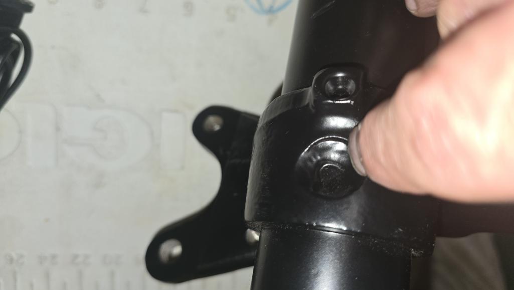

I had a conversation about this with Tony Callas on a strut I brought him. It was a rare Koni. It was suggested the best fix was to
drill out the plug weld and replace it with a better spindle. To slide the spindle off of a Koni the bottom plug that accepts the ball joint has to come out. What was interesting was that Koni and Boge have the same spindles as the spindles come from the same manufacture. it was also pointed out that the back side of the spindle has a centering intent that is online with the spindle.
