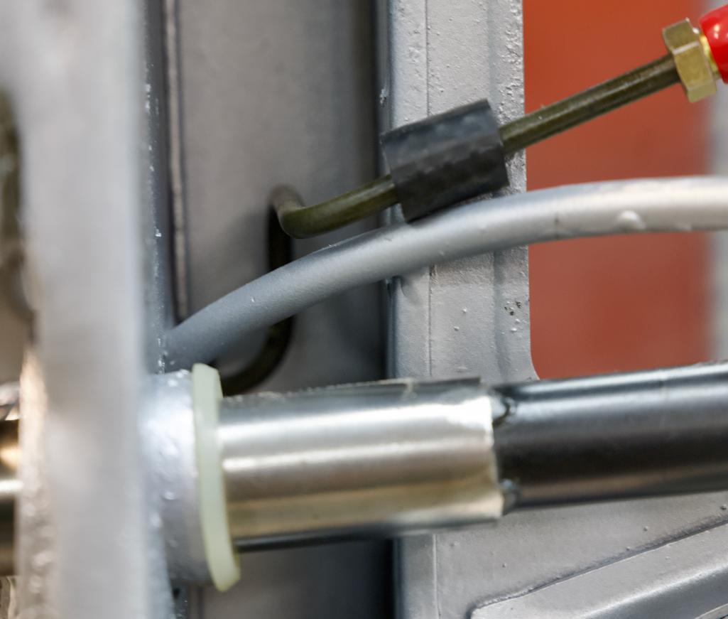

Here's a view of the tunnel from the bottom with no floor pans:
This is an early car with a side shift conversion, stainless fuel lines, and the 914/6 hand throttle. The speedometer, throttle, and heater cables have not been installed.

If only all that was accessible so you didn't have to build a ship in a bottle to work on it.
Thank you.

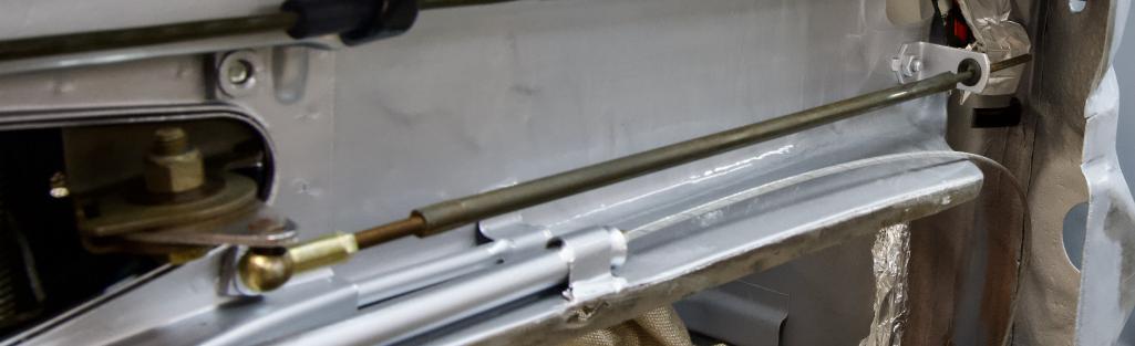

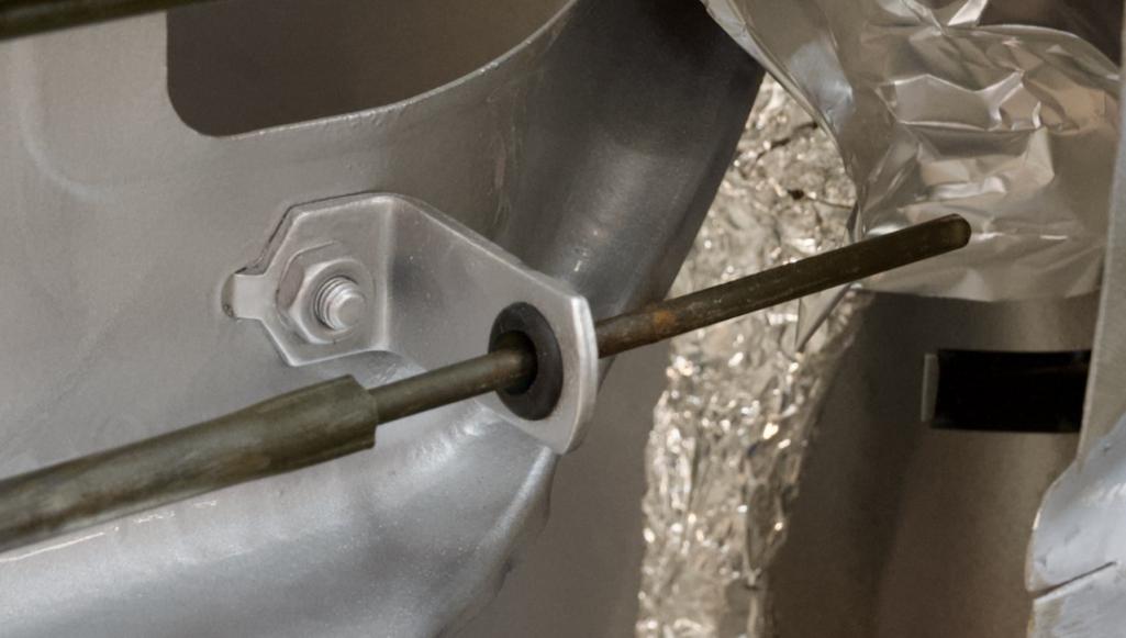

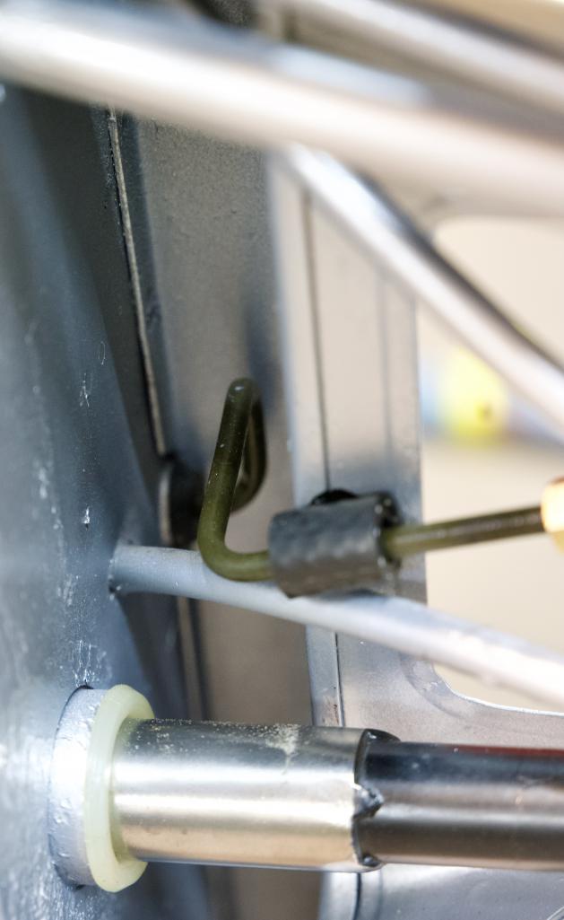

A better shot of the hand throttle:
And the business end:
Note that the bushing and nubbin on the end are missing here. I have put in a simple grommet to keep it from rattling around, but I'm looking for the real thing or a suitable substitute. Aase has NOS nubbins, yay!

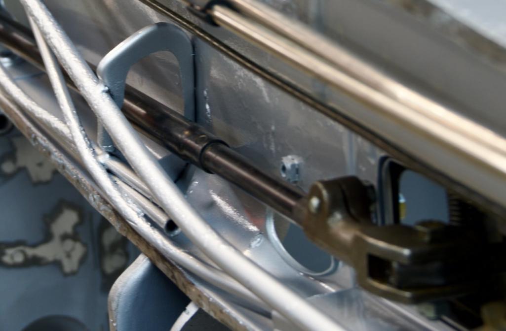

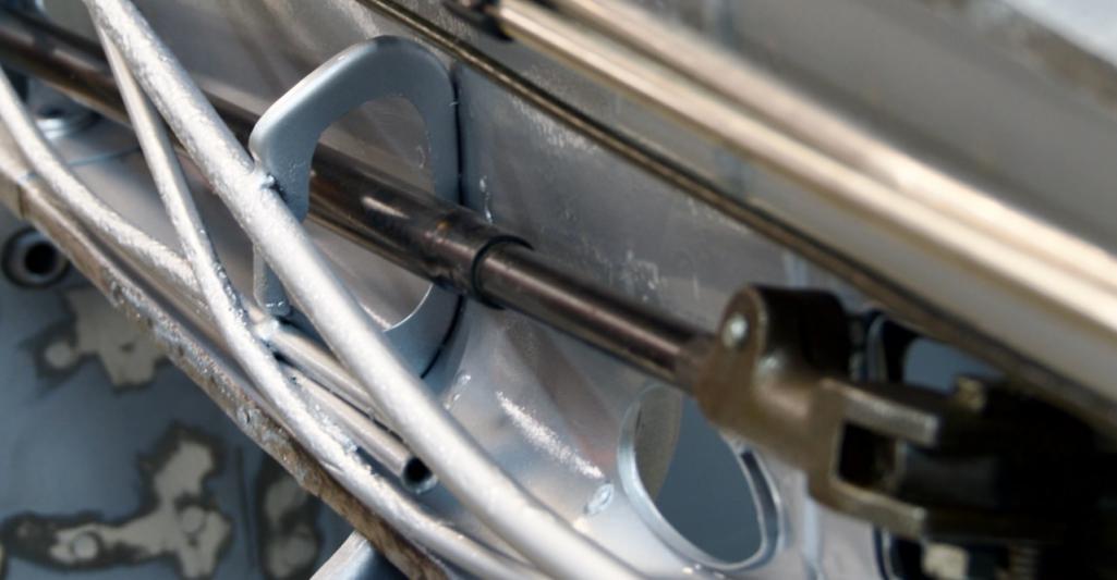

This shows the clearance for the shift rod through the support. Early cars such as this had a circular hole, since the tail shifters had no lateral motion of the rod, only linear motion along the length and rotation. The hole was widened to accommodate the side shift conversion. This is roughly where neutral would be:
And here is where it would be for 1st/Reverse. It may not be apparent from this angle, but the rod would definitely collide with the support if it hadn't been modified.

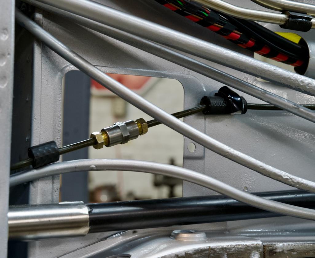

The small brake line at the back is a bit convoluted, it has runs from the firewall to the access port in the tunnel where is joined by a union with the long line that runs the rest of the length to the front:

And the brake union, normally accessible from the access port above it (behind in this picture). This also shows why long seat belt bolts interfere with the shifter.Attached Image

Really like the rubber bumpers on the stainless fuel lines. Great idea. Not sure if I can do the same with the fuel lines that I purchased as a replacement in my 70, hmmm

QUOTE(zoomCat @ Mar 7 2025, 12:50 PM) *
For the end of the hand throttle rod you can use a vacuum cap. It works well.

QUOTE(zoomCat @ Mar 7 2025, 10:50 AM) *
Thanks for sharing these photos. They will be helpful to a lot of people.
Regarding the "nub". I looked at NOS when putting ours back together. Given how our original disintegrated, I wasn't confident NOS would survive long. If you run into trouble with it, I created a 3D model.

QUOTE(ClayPerrine @ Mar 7 2025, 04:50 PM) *
great tip, I have not been 100% pleased with the kit I installed, partially because it's a tough area to access. I will try a rubber cap on the end and also some sort of "bushing" to minimize the sloppiness at the bracket/rod
