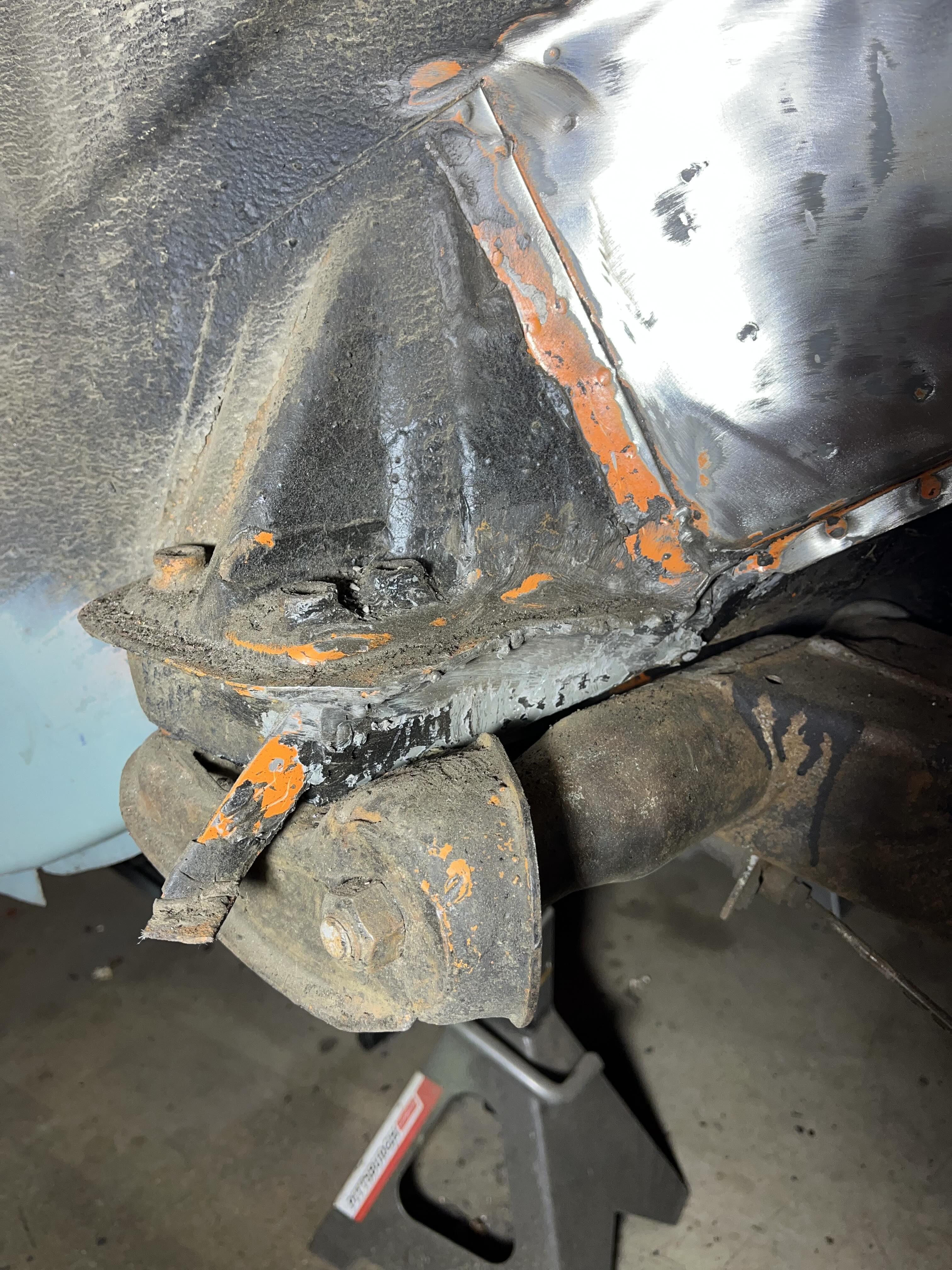

@mate914 Best photo I could get of the inside of the shock tower is below. Car still has suspension and engine mounted (been hoping to get away without pulling engine since the car ran and drove when I bought it).
You can see where the collision crease was partially pulled out on the outside of the inner wheel well in one photo and in the second you can see that the inner part of the shock tower was also creased (and apparently not repaired).

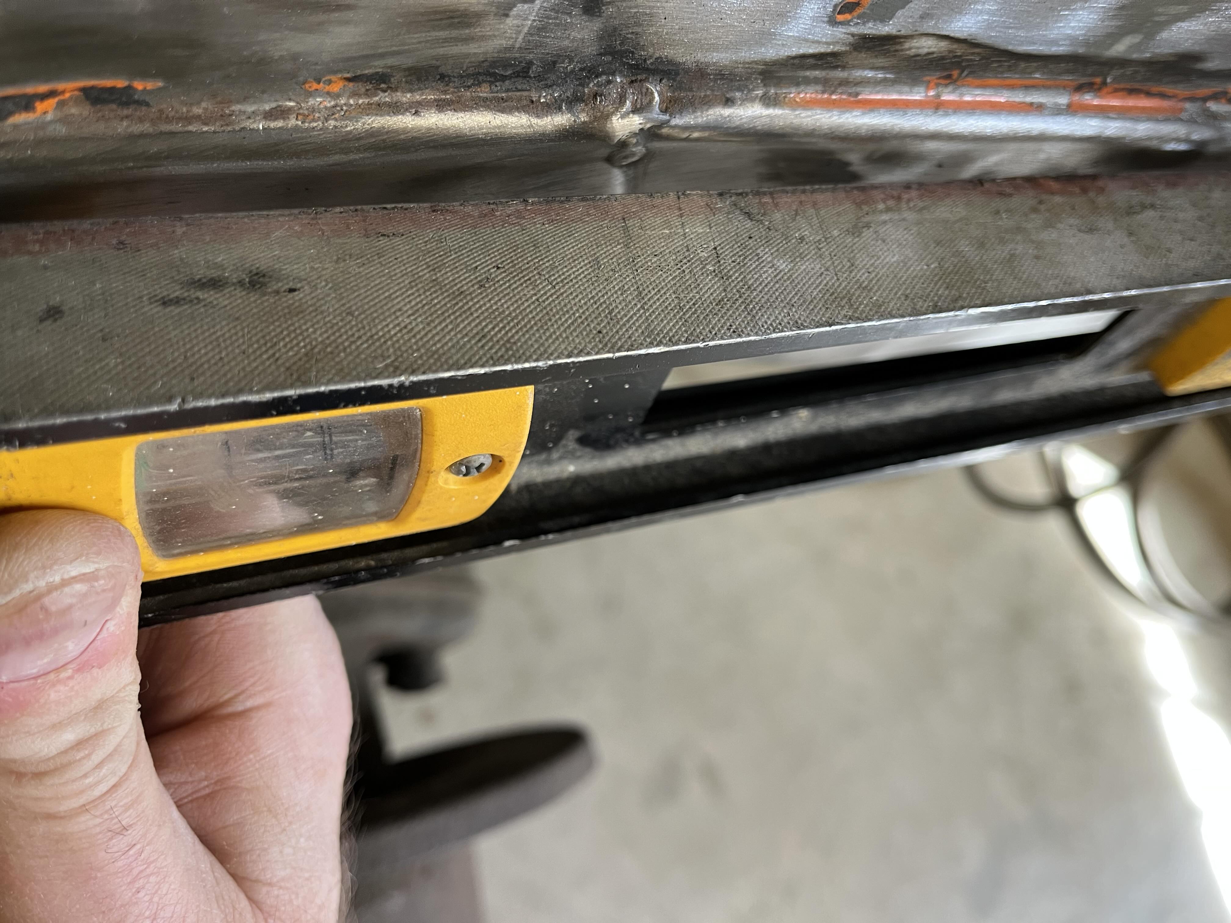

As best as I can tell doing measurements of the rear suspension mounting points (again, engine in) using a laser level, everything seems to be correctly located. I measured 139mm on center from the top of the head of the forward bolts in the console, and they are within 2mm of each other in level.
I did all of the rear measurements from here:http://www.914world.com/specs/bodydims.php
Surprisingly they are close to good:
-R: 135.5 measured vs factory 135.9
-Q: 78.6 measured vs factory 77.8
-S: this one stumped me. The description says to measure from the lip for the gasket, but the photo seems to show measuring to the bottom part of the trunk hinge when it is upright. Measuring vs the hinge I got 157.5 - 158.5 across range of hinge in/out motion vs 158.8 factory.
However with the car perfectly leveled it's clear that the left hand inner structure is sitting about 1cm high. You can see from the photos below that the damage seems to be isolated to the wheel well back to the rear panel and rear of trunk floor (which I'll be replacing).
Based on the above I'm currently thinking of cutting out just enough of the inner wheel well to access the crease on the inner shock tower and using a stud welder to pull that back into shape, then use the stud welder to pull out all of the inner wheel well structure, starting fro the front of the panel and working back towards the impact.
Once that's done I will see if it has brought the top of the wheel well down the ~1cm. If not I'm thinking of bacing the car so the front can't lift upwards and using a frame jack to try to push the wheel well structure down (I've got a very low ceiling and could jack off of a 2 x 6 across some joists down onto the panel.
Looking for feedback and reactions.
Thanks!

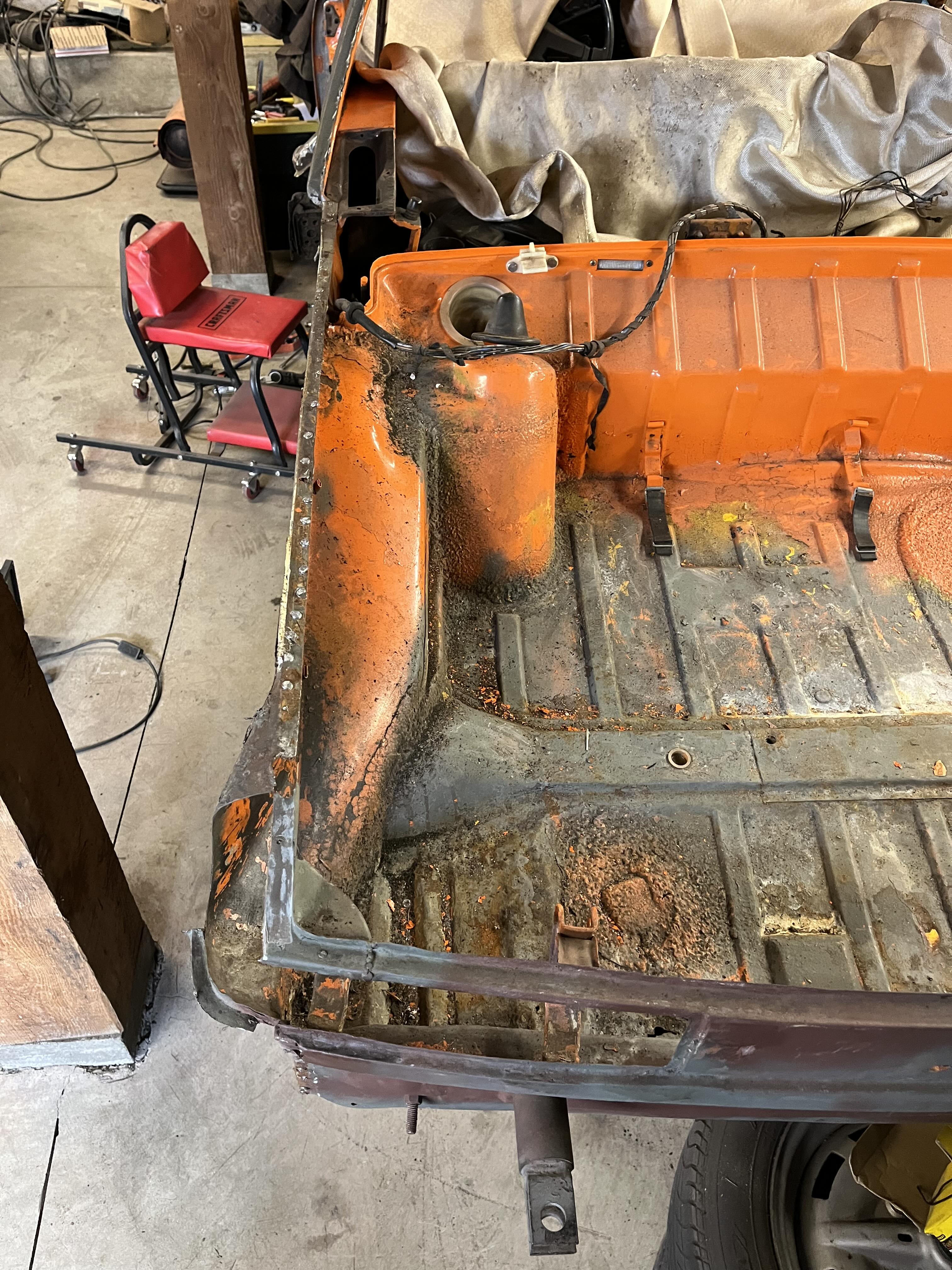

Making some decent progress straightening this out. I used a stud welder to pull out the deformation in the inner wheel well skin beginning behind the suspension console and working toward the old kink in the shock tower area.
At that point I cribbed underneath the transmission so that I could use a body jack to push the LH structure downwards (it was 5mm to 9mm higher than the RH side from the old collision). I kept jacking (pushing downwards from a ceiling joist in my barn), releasing the jack, measuring, and repeating. After several iterations I got the LH to within 3-4mm of the RH side at my measurement points (using a laser level). There was much celebration.
There is still a slight (maybe 2-3mm) bulge in the bottom of the shock tower structure that I plan to push in using the body jack. Then it's on to straightening the inner wheel well skin backwards to the tail of the panel. I also need to work out the deformation in the top of the wheel arch and make sure that the mating surface for the quarter panel is level with the RH side. Hoping at that point that I'll find the replacement quarter panel-to-door gap will be correct so that I can start piecing together all of the sheet metal panels.

Some creative work going on - keep going
Always measure some diagonals to keep it square. Not easy working in 3 dimensions!
